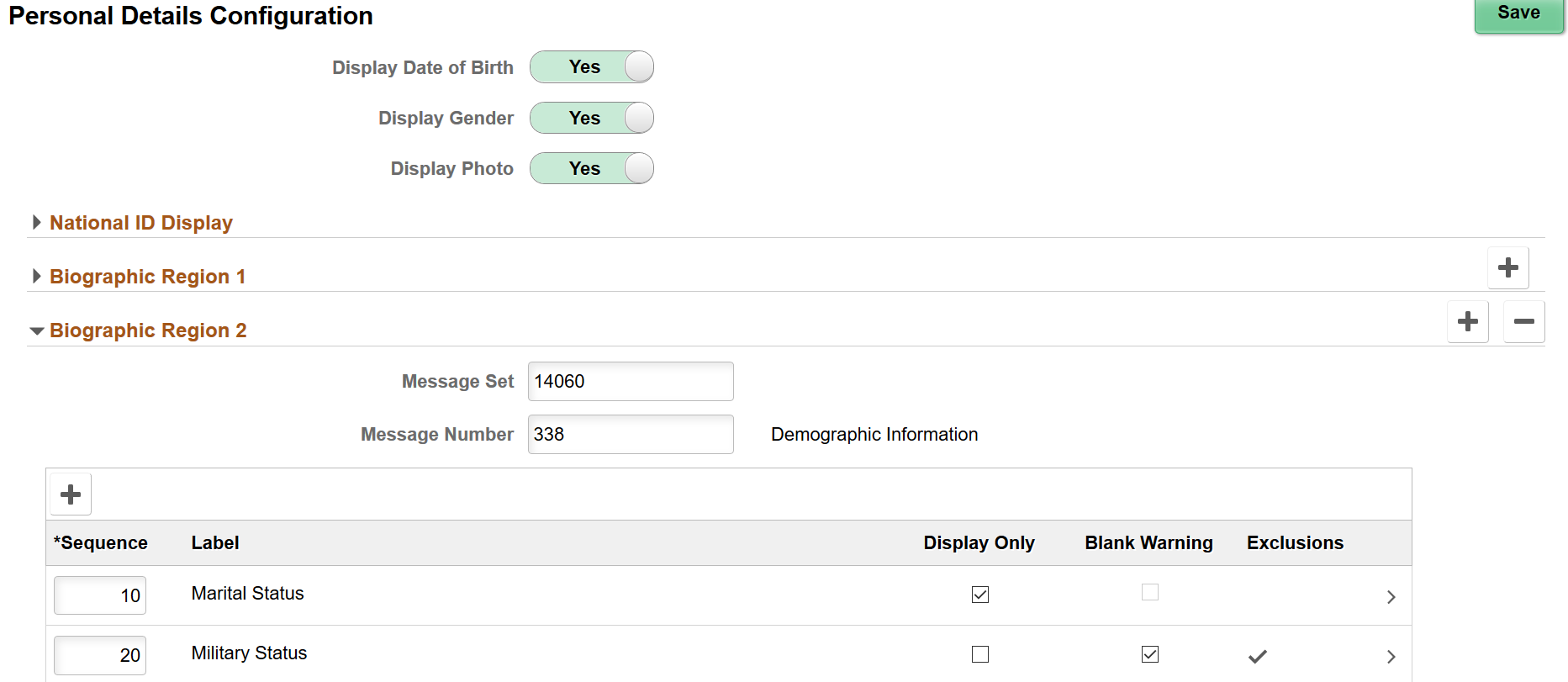

Access the Personal Details Configuration page (Set Up SACR > Common Definitions > Self Service > Campus Community > Personal Details Configuration).
Use the toggle switch to select the fields to be displayed. The Empl ID always appears on the page. You can configure Gender as a read-only field on the Personal Details page; or as a read-only or updatable field on the Biographic Details page.

Configuring Biographic Details
Configure fields to appear in up to 12 Biographic Regions on the Fluid Biographic Details page. By default, only one region appears on the page. Click the Plus button to add more regions, and the Minus button to remove a region.
Use the Fields grids to define and organize the fields to be displayed. The fields available for display are: Birth Gender, Gender Identity, Other Identity, Preferred Pronouns, Other Pronouns, Sexual Orientation, Other Orientation, Biographical Attribute 1 to 9, Gender, Marital Status, Military Status, and Religious Preference.
Image: Personal Details Configuration page
This section of the Personal Details Configuration page illustrates a Biographic Region with its Message Set and Message Number values. The field grid columns are Sequence, Label, Display Only, Blank Warning and Exclusions.
A Biographic Region only appears on the Biographic Details page if at least one field is defined in it. If none of the regions have fields defined for them, the Biographic Details page is not displayed.
Define a Message Set, Message Number and Message Text field for each region.

Message Set
Define the Message Set number for the field label. This is a required setting if at least one field is defined in the grid.
Message Number
Define the Message Number for the field label. This field is only enabled if the Message Set field is defined.
Message Text
View the message text for the region label that appears on the Biographic Details page; for example, Gender Expression. Two sample messages are provided: 14060, 337 Gender Expression and 14060, 338 Demographic Information.
Add Field
Select the button to add new fields. The button appears only if there are fields available for selection in the particular region (a field cannot be used in more than one region).
Field or Control
Definition
Sequence
Assign a unique two–digit number that controls the display of the field. This is a required value.
Label
View the message text from the message catalog entry defined for the field. The maximum text limit is 100 characters but we recommend that you use 30 characters to avoid word truncation in the display.
Display Only
Select the check box to make the field read-only on the Biographic Details page. If the Display Only, check box is selected, the Blank Warning check box is cleared.
Blank Warning
Select the check box to determine whether a warning is displayed on the Biographic Details page if a field value is blank. You can select the check box only if the Display Only option is not selected.
Exclusions
Indicate whether exclusions have been defined for the field- where a value is not available for selection by students on the Biographic Details page. This allows values that are valid for use on the Personal page for administrative users, for example Unknown, to be excluded from the list of values available on the self-service page. A check mark indicates exclusions.
Editing a Field Setting
Select any row in the grid to edit a field setting. You can edit the Message Set, Message Number and Sequence values. You can also change the setting of the Display Only and Blank Warning check boxes, which are by default, not selected. You can save changes or delete the field from the grid.
Click the Add Exclusions button to add exclusions for a field—translate values to be excluded from the list of available values for selection on the Biographic Details page. The Add Exclusion button does not appear if there are no active translate values associated with the field. If exclusions have been added for a field, they appear in a grid and you can click the plus button to add another exclusion. You can also delete exclusions using the minus button.
Note: : If the Other text field is included with the coded field, for example, both Gender Identity and Other Identity are included; then both should be included in the same region and the sequence values should be defined so that the fields appear together on the Biographic Details page. Ensure that the Display Only value is the same for both fields for consistent display.
