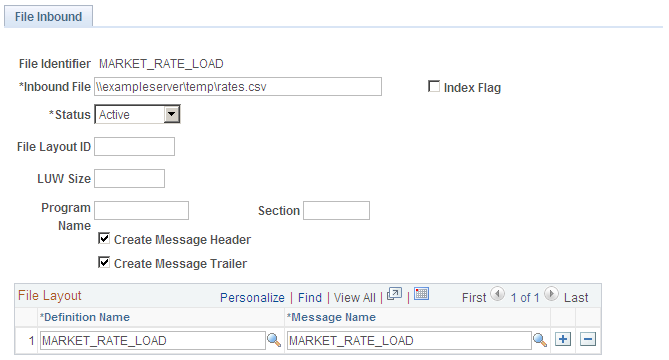

Use the File Inbound page (EO_FILE_INBOUND) to set up inbound flat file processing.
Image: File Inbound page
This example illustrates the fields and controls on the File Inbound page. You can find definitions for the fields and controls later on this page.

Field or Control
Definition
File Identifier
Displays the inbound file that you are associating with the rule.
Inbound File
Enter the index file name or the data file name. Specify the full path information. The PeopleCode program uses the %filepath_absolute variable when opening the file.
Index Flag
Select to distinguish between the index and the data file.
Status
Select whether this inbound file rule is Active or Inactive. The default value is Inactive.
File Layout ID
Select a layout to associate with the file.
LUWSize (logical unit of work size)
To limit the message size, enter the number of level zero rows that are in each message. The output message is normally determined by the MaxMessageSize system parameter.
Program and Section
Enter the name of a PeopleSoft Application Engine (AE) program and section to invoke when the utility finishes processing data.
Create Message Header
Select to create a header message. Use the header message as a trigger in the subscription process to initialize tables before they receive the data messages. This option is selected by default.
Create Message Trailer
Select to create a trailer message. Use the trailer message as a trigger in the subscription process to indicate that all the data messages have been received. This option is selected by default.
File Layout
Field or Control
Definition
Definition Name and Message Name
If the File Layout ID field is blank, this field should contain only one entry.
If the File Layout ID field is not blank, this scroll area must contain an entry for each file layout definition name that is specified in the inbound file.
Note: Use the wildcards * and ? for the file name but not for the directory path. The file layout and message mapping must be valid for all files that meet the wildcard criteria.

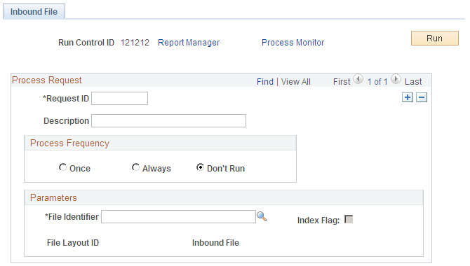

Use the Inbound File page (EO_FILETOMSG) to initiate inbound flat file processing.
This file-to-message processing function reads the file rowset and publishes it as a message.
Image: Inbound File page
This example illustrates the fields and controls on the Inbound File page. You can find definitions for the fields and controls later on this page.
Inbound File page
Use this page to initiate inbound flat file processing. This file-to-message processing function reads the file rowset and publishes it as a message.
Parameters
Field or Control
Definition
File Identifier
Select or enter the name of the file identifier that you set up in the File Inbound page. The file identifier is tied to the publish rules.
Run
Click to run this request.
