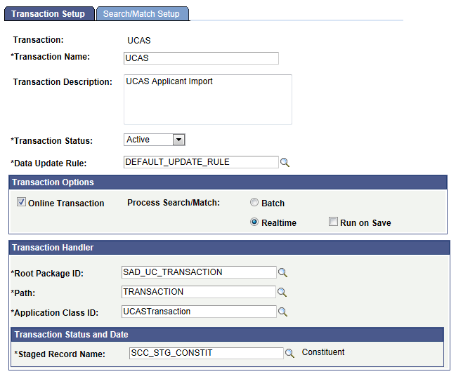

View the transaction setup.

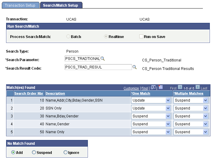

Define the search/match criteria.

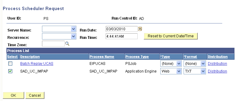

Enter the applicant import parameters.

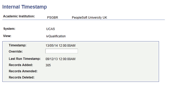

Define a timestamp for re-importing data.

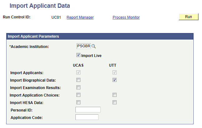

When you import applicant data from UCAS, the system creates new person records in your database or updates details about existing person records. First, you must ensure that you are not going to create any duplicate data by setting up the search/match parameters. Then, you run the Import Applicant Data process to load the application and applicant data into your database. The search/match process determines if the person might already exist in your database. The purpose of the search/match is to prevent duplicate records. You can specify what you want the post process to do when search/match finds a match or multiple matches. It is recommended that you set the status as Suspend when you set up the search/match criteria for multiple matches. Based on the results of the search/match process, the import process can update the record in your database that matches the UCAS data if you are sure that the person in your database is the same person to whom the UCAS data relates.
If you selected the UCAS check box on the UCAS Configuration page, the Import Applicant Data process imports data from the UCAS iv views. If you selected the UTT check box on the UCAS Configuration page, the Import Applicant Data process imports data from the UTT iv views. If you selected both the UCAS and UTT check boxes, the Import Applicant Data process imports data from both the UCAS and UTT iv views.
If you selected the Import Live check box on the UCAS configuration page, the system loads the data from UCAS into the Campus Solutions tables through the staging tables.
If you did not select the Import Live check box because you have data in the staging tables, the system loads the data from the staging tables into the Campus Solutions tables. You can then use the Campus Solutions pages to review the data in the Campus Solutions tables.
The Import Applicant Data process imports data from the ivContextual view only if the Contextual check box is selected and the UCAS Cycle is 2012 or greater on the UCAS Configuration page. Also, the process imports data from the Unicode version of views, only if the Unicode check box is selected on the UCAS Configuration page. For example, if you have selected the Unicode check box, the process imports data from the Unicode views, such as ivStarAU and ivStarJU. Conversely, if you have not selected the Unicode check box, the process imports data from the standard views, such as ivStarA and ivStarJ.

Transaction Setup |
SCC_TRANSAC_DTLS |
View the delivered UCAS transaction that you can use in the Transaction Search/Match Setup page. Do not modify any values for this delivered UCAS transaction or create a new UCAS transaction. |
Search/Match Setup |
SCC_SEARCH_PARMS |
Define search and match parameters for the delivered UCAS transaction, which specify what UCAS data the system will append to existing records in your database and which UCAS data the system will suspend or ignore. |
Import Applicant Data |
SAD_UC_RUN_CNTL |
Import the UCAS and UTT applications and applicant data into your system. Before you import the data, set up the search/match parameters on the Search/Match Processing pages. |

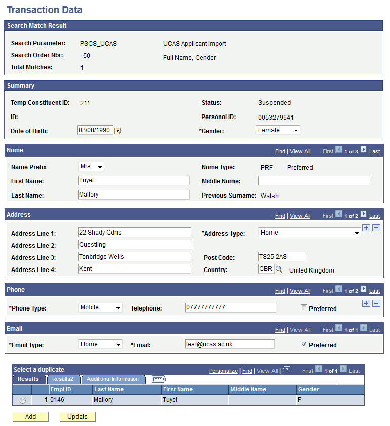

Transaction Data |
SCC_TRANSAC_DATA |

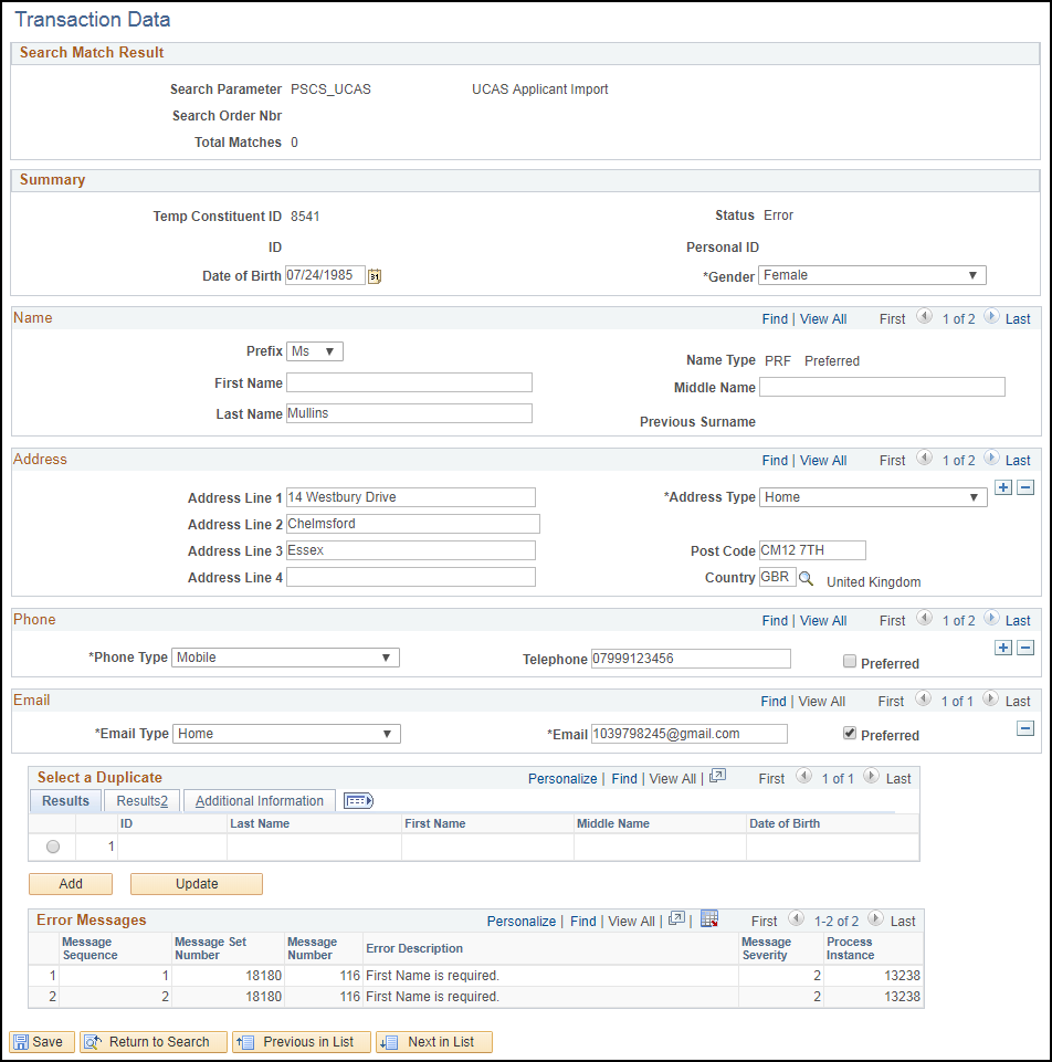

After you run the Import Applicant Data process, use this page to review the status of a UCAS record with regard to loading, searching/matching, and posting processing. For example, determine if a record is waiting to be processed or if a record caused a new person to be added to your database. |

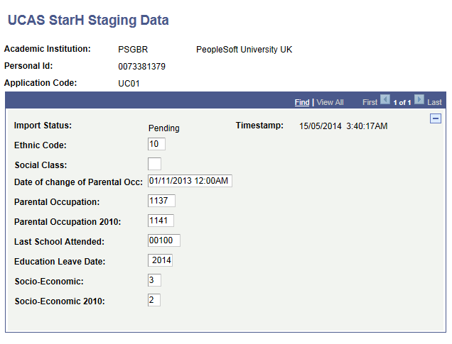

UCAS StarH Staging Data |
SAD_UC_I_IVSTH |
View, update, or delete the suspended ivStarH data stored in the staging tables. |

View, update, or delete the suspended ivgStarW data stored in the staging tables. |

Internal Timestamps |
SAD_UC_TIMESTMP |
For an institution, reset a timestamp to a previous date if you want to re-import UCAS records. See the highest UCAS timestamp when the view was last imported. Additionally, see the number of records that were added, deleted, or amended when the view was last imported. |

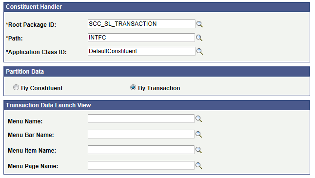

Access the Transaction Setup page ().
Image: Transaction Setup page (1 of 2)
This example illustrates the fields and controls on the Transaction Setup page (1 of 2).
Image: Transaction Setup page (2 of 2)
This example illustrates the fields and controls on the Transaction Setup page (2 of 2).
The system uses this delivered UCAS transaction to process the incoming UCAS and UTT data. Do not change any values for this transaction.
Access the Search/Match Setup page ().
Image: Search/Match Setup page
This example illustrates the fields and controls on the Search/Match Setup page. You can find definitions for the fields and controls later on this page.
The system uses this delivered UCAS transaction to process the incoming UCAS and UTT data. Therefore, you will need to define search match parameters for the UCAS transaction.
Use the Search Parameter field to select the group of predefined search parameters that you want to use for the Import Applicant Data process.
Use the Search Result Field field to select a search result value that you defined in the Search Result page.
It is recommended that you change the Number of Characters of FirstNameSrchRule and LastNameSrchRule to 7 for PSCS_10, PSCS_30, PSCS_40 and PSCS_50 in the Search/Match Rules page. Select to navigate to the Search/Match Rules page.
For information about setting up search/match rules, search parameters and results, see Understanding Search/Match and Setting Up Search/Match
Note: You must define at least one Suffix value in the Name Suffix table ().
Match(es) Found
This group box contains one row for each search/match criteria order defined by your institution. Define search/match orders on the Search/Match Criteria page.
Field or Control |
Definition |
| Search Order Nbr (search order number) |
For each order number, select what you want to do with the record if the search/match/post process discovers one or more matching records. |
| One Match and Multiple Matches |
Select whether you want to add, update, suspend, or ignore matching records: Add: Add a new record to your database using the staging table record. Update: Update the existing record with the data in the staging table record. Suspend: Keep the suspense record back in the staging table. Determine manually whether or not this record matches a record in your database. Ignore: Ignore the staging table record that matched a record in your database. The process marks the record to be purged. |
No Match Found
Select one of the following options to specify what the search/match/post process should do when it does not find a matching record in your database:
Add: Add the unmatched record, including personal data, to your database.
Suspend: Keep the unmatched record in the staging tables to be looked at manually.
Ignore: Ignore the unmatched record completely. The process marks the record to be purged.
Access the Import Applicant Data page ().
Image: Import Applicant Data page
This example illustrates the fields and controls on the Import Applicant Data page. You can find definitions for the fields and controls later on this page.
Field or Control |
Definition |
| Academic Institution |
Enter the academic institution for which you want to import data. |
| Import Live |
Select if you want the import process to load the data into the staging tables and then into the Campus Solutions tables. If you do not select this check box, the import process loads the data from the staging tables into the Campus Solutions tables. By default, the system selects this check box if the Import Live check box on the UCAS Configuration page is selected. |
| Import Applicants |
Indicates whether the process imports applicant data from UCAS, UTT, or both. You cannot select or clear these check boxes. The system selects the check boxes if you have selected the UCAS and UTT check boxes on the UCAS Configuration page. If the system selects the UTT check box, the process imports applicant data from UTT ivgStarN, ivgStarA, and ivgStarK views. If the system selects the UCAS check box, the process imports applicant data from UCAS ivStarN, ivStarA, and ivStarK views. Note: Either the UCAS check box or the UTT check box for Import Applicants must appear as selected for the Import Applicant Data process to run successfully. |
| Import Biographical Data |
Select the UCAS check box if you want to import application biographical data from the following UCAS views:
Select the UTT check box if you want to import application biographical data from the following UTT views:
Select both check boxes if you want to import application biographical data from the UTT and UCAS views. |
| Import Examination Results |
Select the UCAS check box if you want to import data from ivStarPQR and ivUnitResults views. |
| Import Application Choices |
Select the UCAS check box if you want to import application choices from these UCAS views:
Select the UTT check box if you want to import application choices from the following UTT views:
Select both check boxes if you want to import application choices from UTT and UCAS. |
| Import HESA Data |
Select the UCAS check box if you want to import ivStarj data. Select the UTT check box if you want to import ivgStarj data. |
| Personal ID and Application Code |
Specify the UCAS or UTT personal ID and application code, if you want to re-import all the records of a particular applicant (that has previously been incorrectly matched and then deleted). If you specify the personal ID and application code here, then during the selection from applicant views, the import process will select only records for that applicant, irrespective of the Earliest Application Year that you configured and timestamp values. If you leave these two fields blank, the process will select records for all applicants based on the timestamp in the views and updates the internal timestamp with the highest imported timestamp value. For more information on the internal timestamp settings: Defining a Timestamp for Re-importing Data The Personal ID and Application Code fields are available only when you select the Import Live check box on the Import Applicant Data page. Note: By using the Personal ID and Application Code fields, you can specify only one applicant for a single run of the Import Applicant Data process and you will need to ensure that the correct UCAS or UTT import check boxes are selected on the Import Applicant Data page. Also, note that if you specify a personal ID, then the application code is required. Personal ID must be a 10-digit numeric value and application code must be a 4-character value (for example, UC01, UC02, GT01 and GT02). |
If you have installed CRM for Higher Education, you can run an EIP batch replay process following the main Import Applicant Data process. The following example shows the options available on the Process Scheduler Request page when CRM for HE is installed.
Image: Process Scheduler Request page for the Import Applicant Data process
This example illustrates the fields and controls on the Process Scheduler Request page for the Import Applicant Data process. You can find definitions for the fields and controls later on this page.
If you select the Batch Replay UCAS option, the Import Applicant Data process (SAD_UC_IMPAP) runs first and then the EIP Batch Replay (SCC_BAT_RPLY) runs. If you select the SAD_UC_IMPAP option, only the Import Applicant Data process runs.
For more information about the EIP Batch Replay process see CRM for Higher Education Developer's Guide.

Access the Transaction Data page ().
Image: Transaction Data page
This example illustrates the fields and controls on the Transaction Data page. You can find definitions for the fields and controls later on this page.
Field or Control |
Definition |
| Personal ID |
Displays the value imported from the StarN staging record for suspended records and from PS_SAD_UC_APPLREC for updated or added records. |
| Previous Surname |
Displays the value from the StarN staging record for suspended records. This field does not display a Previous Surname value for updated or added records. |
Possible values for the Status field include:
New ID Created: The import process added a record with a new ID to your database when the post process was run. Or the system added a record with a new ID to your database when you clicked the Add button.
ID Updated: The import process updated an existing ID record with the data from the UCAS record. Or the system updated an existing ID record with the data from the UCAS record when you selected the existing ID in the Results region and then clicked the Update button.
Suspended: The import process has completed running the search/match process and indicated that the record should be held for later processing.
Ignore: The import process has completed running the search/match process and indicated that the record should be ignored for any processing.
Error: The import process suspends error records. The Error Messages region indicates which value is invalid. You must correct the invalid data specified by each error message before selecting the Add button or the Update button to process the record.
Note: To resolve the “First Name is required” error:
Enter dummy values in the First Name field for both the primary and preferred Name Types.
Select Save.
Select Add to create a new person or Update to match to an existing person.
Other staging statuses that you can see on the Transaction Data search page are not currently used in UCAS.
You define the logic to determine the status values in the Search/Match Setup page. For example, to give the ID Updated status to a record, you may have specified that if the import process does not find a matching record, then add the imported record to the tables.
The Select a Duplicate region displays the single or multiple matching records. The system disables the Add and Update buttons and hides the Select a Duplicate region if the data has been posted. Also, all the fields appear as read-only when the status is New ID Created or ID Updated.
Select a duplicate
Displays a single or multiple matching records for the imported UCAS record where the status is suspended or error.
Click the Detail link to navigate to the Add/Update a Person component.
Field or Control |
Definition |
| Add |
Click to ignore any potential duplicates, manually add a new ID, and post the imported UCAS record to your database. When you click this button, the system posts the record and assigns an ID to the person. |
| Update |
Click to match to an existing record and update the person record selected in the Select a Duplicate region with data from the UCAS record. |
Use the Staging Data pages to view, update, or delete the suspense data in the staging tables. The following is an example of a Staging Data page.
Image: Example of a Staging Data page
This example illustrates the fields and controls of a Staging Data page.
The Import Status field displays any one of the following values:
Error: If the Import Applicant Data process cannot load the record into the Campus Solutions tables.
Imported: If the Import Applicant Data process has loaded the record into the Campus Solutions tables.
New: If the Import Applicant Data process has not loaded the record into the Campus Solutions tables.
Pending: If the Import Applicant Data process load is waiting for the creation of a new person ID for the applicant.
In the UCAS and UTT StarA Staging Data search pages, the Country Code search field searches both the Correspondence Country and the Home Country values loaded from the StarA views. The search results therefore display records that have a matched search value in either the Correspondence Country field or Home Country field or both fields. For example, if you enter NLD in the Country Code search field, the system displays records that have NLD as either the Home Country or Correspondence Country or both. It is recommended that you use the Contains option when searching using this field.
The staging data pages can display data from either the Unicode views or the standard views. For example, if you have selected the Unicode check box on the UCAS Configuration page, the StarA Staging Data page displays the ivStarAU data. Conversely, if you have not selected the Unicode check box on the UCAS Configuration page, the StarA Staging Data page displays the ivStarA data.
Access the Internal Timestamp page ().
Image: Internal Timestamp page
This example illustrates the fields and controls on the Internal Timestamp page. You can find definitions for the fields and controls later on this page.
Field or Control |
Definition |
| Timestamp |
Displays the highest UCAS timestamp for the view when it was last imported. |
| Override |
Specify an override date if you want to reload a particular view. After specifying the override date, run the import process. The import process then imports the UCAS view records that have a timestamp of on and after the specified override date. The default system time for the specified override date is 00:00:00. After the import process finishes, the system sets the Override field value to blank. |
| Last Run Timestamp |
Displays the latest timestamp used by the import process when it was last run. |
| Records Added |
Displays the number of records that the import process added when the process last ran. |
| Records Amended |
Displays the number of records that the import process modified when the process last ran. |
| Records Deleted |
Displays the number of records that the import process deleted when the process last ran. |
The following scenario describes how the Internal Timestamp page displays its field values:
You have already imported records for a view that has UCAS timestamps up to and including July 31, 2008. Therefore, the Timestamp field on the Internal Timestamp page displays the date July 31, 2008.
You now want to re-import data for the view that UCAS has modified and added on or after May 31, 2008, 12 AM.
On August 4, 2008 enter an override date of May 31, 2008 in the Internal Timestamp page and run the Import Applicant Data process.
After the Import Applicant Data process completes importing the data, the system sets the Override date field as blank and sets the Last Run Timestamp field as May 31, 2008 because May 31,2008 was the override timestamp date that the system used when the process was run.
The Internal Timestamp page displays the number of records that the import process added, amended, and deleted on August 4, 2008.
The Timestamp field on the Internal Timestamp page still displays the date July 31, 2008 if no records were found in the UCAS view with timestamps greater than July 31. If the import process imported records in the UCAS view that had a timestamp of August 1, 2008, then the Timestamp field displays the date August 1, 2008.
