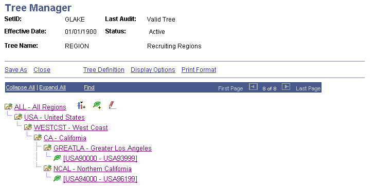

Delivered Region Tree Examples
Recruiting and Admissions comes with three sample region trees that you can view to get an idea of a finished region tree. Each one is named REGION; they are listed, in order, under the following setIDs:
PSCCS
GLAKE
PSUNV
Image: PeopleSoft Tree Manager displaying part of the sample GLAKE region tree
This is an example of part of the delivered GLAKE region tree.
See product documentation for PeopleTools: Tree Manager

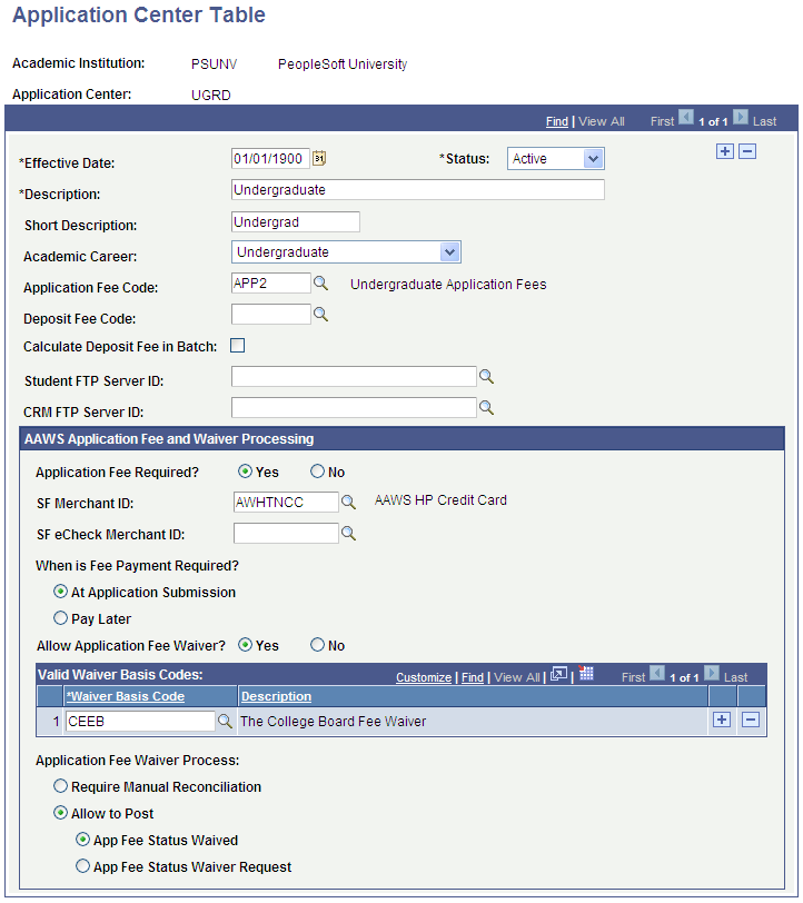

Access the Application Center Table page ().
Image: Application Center Table page
This example illustrates the fields and controls on the Application Center Table page. You can find definitions for the fields and controls later on this page.
Note: You assign applications and link recruiters to application centers. This helps you to identify the applications and recruiters who belong to a particular admissions office.
Application centers are where admissions applications are processed. By defining application centers, you can track which office is handling a specific application. This is especially useful if you have decentralized processing for academic careers.
Field or Control |
Definition |
| Academic Career |
Select an academic career if this application center is for only one academic career. If you want this application center available to all careers, leave this field blank. Define academic careers on the Academic Career Table page. |
| Application Fee Code |
Select the appropriate application fee code for this application center. Define application fee codes on the Application Fees page in PeopleSoft Student Financials. If you do not charge an application fee, you can leave this field blank. |
| Deposit Fee Code |
Select the appropriate deposit fee code used for this application center. Define deposit fee codes on the Deposit Fees page in Student Financials. If you do not charge deposits, you can leave this field blank. |
| Calculate Deposit Fee in Batch |
Select if you want to allow users to save applications without calculating a deposit fee. When you enter a status of Admitted on the Application Program Data page, the system does not prompt you to calculate the deposit. Rather, you use the Deposit Fees Calc (deposit fees calculation) batch process (SFPBADEP) to calculate the deposit fee. This enables you to automate the deposit fee calculation process. If you clear this check box, the system does prompt you to calculate a deposit fee when you enter a status of Admitted on the Application Program Data page. |
AAWS Application Fee and Waiver Processing
AAWS application fee processing uses staging data in the Application Transactions component.
Use this group box to set up the options for AAWS application fee and waiver processing.
Field or Control |
Definition |
| SF Merchant ID and SF eCheck Merchant ID |
Select a SF Merchant ID (for credit card) or a SF eCheck Merchant ID or both for AAWS fee processing. Based on this setup, during the AAWS fee calculation and payment process, a List of Values web service determines which payment methods are available to an applicant on the external User Interface site. A merchant ID is a user-defined element that defines the rules for interfacing with a third party payment processor. Define Student Financials merchant IDs on the SF Merchants page (Set Up SACR, Common Definitions, Self Service, Student Financials, SF Merchants). |
| When is Fee Payment Required |
If you select Pay Later, the payment processing must be handled outside of AAWS processing. The online application can be submitted and be posted to the core production Application Maintenance component but your institution must follow up with the applicant and process the payment outside of AAWS processing. |
| Allow Application Fee Waiver |
If you select Yes, the Valid Waiver Basis Codes group box and Application Fee Waiver Process fields become available. |
| Valid Waiver Basis Codes |
You can select from waiver basis codes that have been set up on the Application Fee Waiver Basis page (Set Up SACR, Product Related, Recruiting and Admissions, Applicants, Application Fee Waiver Basis). |
| Application Fee Waiver Process |

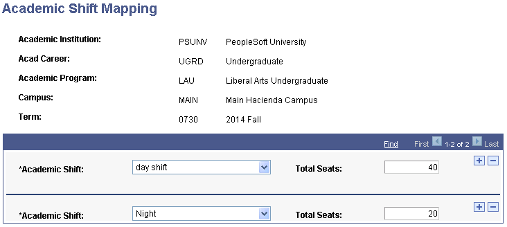

Access the Academic Shift Mapping page ().
Image: Academic Shift Mapping page
This example illustrates the fields and controls on the Academic Shift Mapping page. You can find definitions for the fields and controls later on this page.
Use this page to map academic shifts to admit terms.
If the Use Shift by Admit Term check box is selected on the Academic Institution 3 page, only the values defined here for the particular admit term are available in the Academic Shift field on various pages in Admissions and Student Records.
The Total Seats field is informational only.
