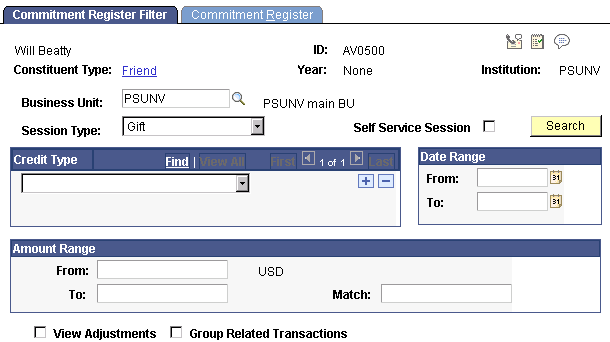

Filter donor commitment registers.

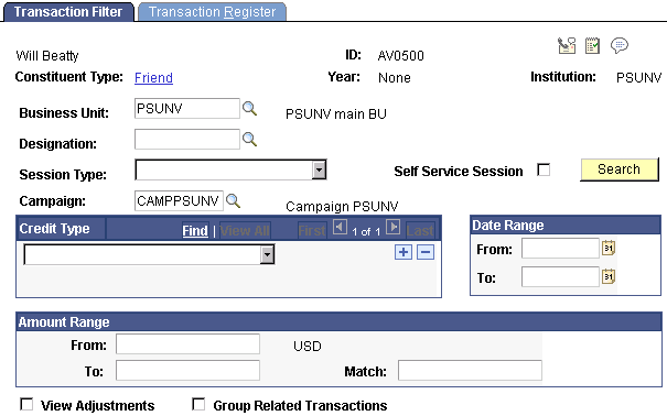

Filter donor transaction registers.

Select a session type from the prompt box. Valid session types include Gift, Pledge, Member, Gift Adjustment, Pledge Adjustment, and Member Adjustment. If you do not select a session type, the Commitment Register or Transaction Register page displays gift, pledge, and membership sessions. Adjustment sessions only appear if the View Adjustments check box is selected or if specifically selected in this field. Session types are delivered with the system as translate values. Do not modify these translate values in any way. Any modifications to these values will require a substantial programming effort. |
Self Service Session |
Enables users to filter for commitment or transaction registers created as a result of an Involvement self-service session. |
Credit Type |
Select the credit type for which to view information. Credit type refers to the type of credit the donor received for the commitment, such as Hard Credit, Soft Credit, and Vehicle Credit. Credit types, other than hard, are defined by your institution. |
Match |
If you only want to view transactions that equal a specific amount, enter that amount. |

Commitment Register Filter |
AV_CMTMT_TRNS_FLTR |
Select criteria used to narrow the number of transactions you view on the Commitment Register page. |

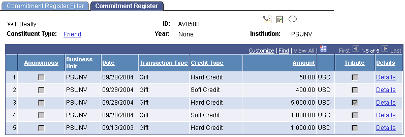

Commitment Register |
AV_CMTMT_TRNS_LIST |
View the transactions that match the criteria you set on the Commitment Register Filter page. |

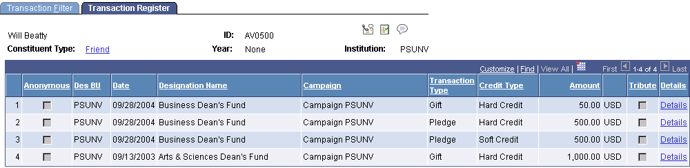

Transaction Filter |
AV_TRANS_FLTR AV_TRANS_FLTR_E AV_TRANS_FLTR_W |
Select criteria used to narrow the number of transactions you view on the Transaction Register page. |
Transaction Register |
AV_TRANS_LIST AV_TRANS_LIST_E AV_TRANS_LIST_W |
View the transactions that meet the criteria you selected on the Transaction Filter page. |

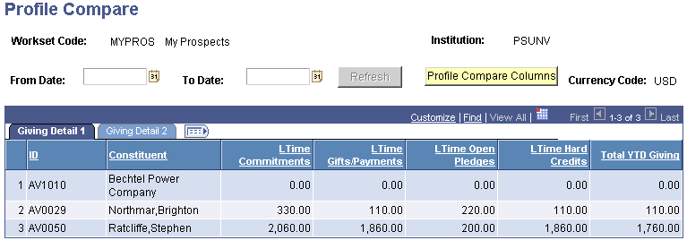

Profile Compare |
AV_GP_WSET_CMPR |
Compare the information contained in giving profiles for the constituents in a workset. |
Profile Compare Columns |
AV_PROF_CMP_DEF_SP |
Click the Profile Compare Columns button on the Profile Compare page. |
Change the columns of information to view on the Profile Compare page. |

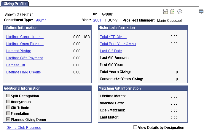

Access the Giving Profile page (
).Important! You must run the Accumulate Constituent Totals process when processing sessions or after updating matching gift information to ensure that the totals on this page are accurate.
Image: Giving Profile page
This example illustrates the fields and controls on the Giving Profile page. You can find definitions for the fields and controls later on this page.
Lifetime Information
Field or Control |
Definition |
Lifetime Commitments |
Displays the total amount of money ever donated or pledged by the donor. Click to view the date, gift type, credit type, and amount for each commitment made, by business unit, on the Lifetime Commitments page. |
Lifetime Open Pledges |
Displays the total amount of money promised but not yet donated by the donor. Click to view the date, gift type, credit type, and amount for each outstanding pledge on the Lifetime Open Pledges page. |
Largest Pledge |
Displays the amount of the largest pledge commitment the donor has made. Click to view detailed information about the pledge on the Largest Pledge page, and to access the Designation Detail and Recognition Detail pages. |
Lifetime Gifts/Payment |
Displays the total amount of money ever donated by the donor. This amount only includes money actually received, and excludes outstanding pledges. Click to view the date, gift type, credit type, and amount for each gift given on the Lifetime Gifts and Pledge Payments page. |
Largest Gift |
Displays the amount of the largest gift given by the donor. Click to view detailed information about the largest gift on the Largest Gift page, and to access the Designation Detail, Matching Gifts, and Recognition Detail pages. |
Lifetime Hard Credits |
Displays the total amount of hard credit given to the donor for recognition purposes. Click to view the date, gift type, credit type, and amount for each transaction for which the donor received hard recognition credit on the Lifetime Hard Credits page. |
Historical Information
Field or Control |
Definition |
Total YTD Giving |
Displays the total amount of money donated by the constituent during the current fiscal year. Click to view the date, gift type, credit type, and amount for each gift given during the current fiscal year on the Total Year to Date Giving page. |
Total Prior Year Giving |
Displays the total amount of money donated by the constituent during the previous fiscal year. Click to view the date, gift type, credit type, and amount for each gift given during the prior fiscal year on the Total Prior Year Giving page. |
Last Gift Date |
Displays the date on which the donor's most recent gift was posted in the system. Only hard credit recognition is used to calculate this field. Click to view detailed information about the largest gift on the Last Gift Date page, and to access the Designation Detail and Recognition Detail pages. |
Last Gift Amount |
Displays the amount of the donor's most recent gift. |
First Gift Year |
Displays the year in which the donor first gave to your institution. Only hard credit recognition is used to calculate this field. |
Total Years Giving |
Displays the total number of years in which the donor has given to your institution. |
Consecutive Years Giving |
Displays the total number of consecutive years in which the donor has given to your institution. The value in this field resets to zero if more than one year has passed since the donor's most recent gift. Only hard credit recognition is used to calculate this field. |
Additional Information
Field or Control |
Definition |
Split Recognition |
If selected, indicates that recognition has been split between this donor and another donor for the same gift. |
Anonymous |
If selected, indicates that the Anonymous check box is selected on the Gift Entry page for a gift from this donor. |
Gift Tribute |
If selected, indicates that the donor has made at least one commitment to the institution in honor of or in memory of another person. |
Foundation |
If selected, indicates that the donor has a relationship established in the system with a foundation. Foundations must have a constituent type of Corporate Foundation, Foundation, or Personal, Family/Foundation. |
Planned Giving Donor |
If selected, indicates that the donor has made a commitment through a deferred gift tracked in Planned Giving under Prospect Management. |
Matching Gift Information
Field or Control |
Definition |
Lifetime Match |
Displays the total amount of money ever received as a matching gift and currently expected as a match from a qualifying organization as a result of the donor's gifts. |
Matched Gifts |
If you are viewing a giving profile for a donor that is a person, displays the amount that has been received as a matching gift from a qualifying organization as a result of the donor's gifts. |
Open Matches |
Displays the total amount of matching gifts expected from an organization as a result of the donor's gifts. |
Last Match |
If you are viewing a giving profile for a donor that is a person, displays the amount of the last matching gift received from a qualifying organization as a result of the donor's gift. |
Other Page Elements
Field or Control |
Definition |
View Details By Designation |
Select this check box if you want to view commitments to each designation separately on the dialog boxes you access from this page. If you want each transaction to appear as one record, regardless of the designations it is allocated to, clear this check box. If you select this check box, the business unit for each designation appears on the subsequent inquiry page. |
Giving Club Progress |
Click to view information about a donor's progression through giving clubs and various club levels at your institution. The Giving Club Progress page appears. |

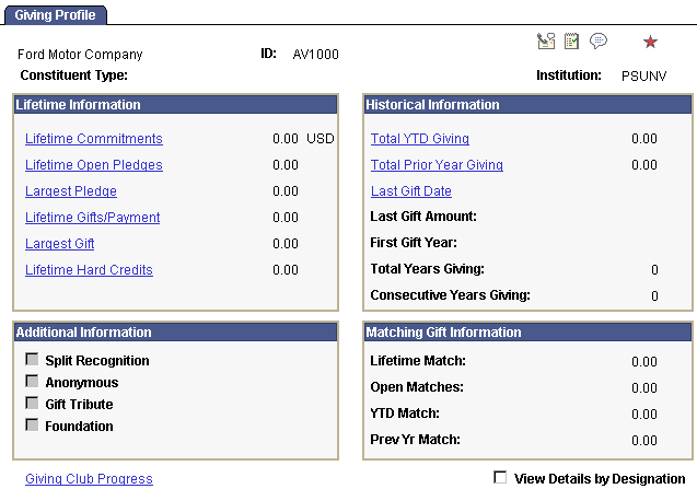

).Image: Giving Profile page for organizations
This example illustrates the fields and controls on the Giving Profile page for organizations. You can find definitions for the fields and controls later on this page.
Field or Control |
Definition |
Displays the total amount of money ever donated or pledged by the organization. Click to view the date, gift type, credit type, and amount for each commitment made on the Lifetime Commitments page. |
Displays the total amount of money promised but not yet donated by the organization. Click to view the date, gift type, credit type, and amount for each outstanding pledge on the Lifetime Open Pledges page. |
Largest Pledge |
Displays the amount of the largest pledge commitment the organization has made. Click to view detailed information about the pledge on the Largest Pledge page, and to access the Designation Detail and Recognition Detail pages. |
Displays the total amount of money ever donated by the organization. This amount only includes money actually received, and excludes outstanding pledges. Click to view the date, gift type, credit type, and amount for each gift given on the Lifetime Gifts and Pledge Payments page. |
Largest Gift |
Displays the amount of the largest gift given by the organization. Click to view detailed information about the largest gift on the Largest Gift page, and to access the Designation Detail, Matching Gifts, and Recognition Detail pages. |
Displays the total amount of hard credit given to the organization for recognition purposes. Click to view the date, gift type, credit type, and amount for each transaction for which the donor received hard recognition credit on the Lifetime Hard Credits page. |
Field or Control |
Definition |
Total YTD Giving |
Displays the total amount of money donated by the organization during the current fiscal year. Click to view the date, gift type, credit type, and amount for each gift given during the current fiscal year on the Total Year to Date Giving page. |
Displays the total amount of money donated by the organization during the previous fiscal year. Click to view the date, gift type, credit type, and amount for each gift given during the prior fiscal year on the Total Prior Year Giving page. |
Last Gift Date |
Displays the date on which the organization's most recent gift was posted in the system. Only hard credit recognition is used to calculate this field. Click to view detailed information about the largest gift on the Last Gift Date page, and to access the Designation Detail and Recognition Detail pages. |
Last Gift Amount |
Displays the amount of the organization's most recent gift. |
First Gift Year |
Displays the year in which the organization first gave to your institution. Only hard credit recognition is used to calculate this field. |
Displays the total number of years in which the organization has given to your institution. Only hard credit recognition is used to calculate this field. |
Displays the total number of consecutive years in which the organization has given to your institution. The value in this field resets to zero if more than one year has passed since the organization's most recent gift. Only hard credit recognition is used to calculate this field. |
Field or Control |
Definition |
Split Recognition |
If selected, indicates that recognition has been split between this organization and another constituent for the same gift. |
Anonymous |
If selected, indicates that the Anonymous check box is selected on the Gift Entry page for a gift from this organization. |
Gift Tribute |
If selected, indicates that the donor has made a gift in memory of or in honor of another individual. |
Foundation |
If selected, indicates that the organization has a relationship established in the system with a foundation. Foundations must have a constituent type of Corporate Foundation, Foundation, or Personal, Family/Foundation. |
Field or Control |
Definition |
Lifetime Match |
Displays the total amount of money ever received as matching gifts and currently expected as a match as a result of gifts from donors connected to the organization. |
Open Matches |
Displays the total amount of matching gifts expected from an organization as a result of gifts from donors connected to the organization. |
YTD Match (year to date match) |
Displays the total amount of matching gifts received from the beginning of the current year to date. |
Prev Yr Match (previous year match) |
Displays the total amount of the matching gifts in the previous year. |
Other Page Elements
Field or Control |
Definition |
Select this check box to view commitments to each designation separately on the dialog boxes you access from this page. If you want each transaction to appear as one record, regardless of the designations it is allocated to, clear this check box. |
Click to view information about a donor's progression through giving clubs and various club levels at your institution on the Giving Club Progress page. |

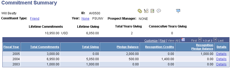

Access the Commitment Summary page (
).Image: Commitment Summary page
This example illustrates the fields and controls on the Commitment Summary page. You can find definitions for the fields and controls later on this page.
Field or Control |
Definition |
Displays the total amount of money ever donated or pledged by the donor. |
Lifetime Giving |
Displays the total amount of money ever donated by the constituent. This amount only includes money actually received, and excludes outstanding pledges. |
Displays the total number of years in which the donor has given to your institution. Only hard credit recognition is used to calculate this field. |
Details |
Click to view more detailed information about the commitments a donor made throughout a particular fiscal year on the Commitment Summary Details page. |

Access the Commitment Register Filter page (
) to select the transactions for a donor without regard to split designations.Note: Each gift appears as a single line item on the Commitment Register page, regardless of the designations to which it is allocated.
Image: Commitment Register Filter page
This example illustrates the fields and controls on the Commitment Register Filter page. You can find definitions for the fields and controls later on this page.
After you use the criteria on this page to narrow the number of transactions you want to view, you can then review a summary of each transaction matching your selection criteria on the Commitment Register page.

Access the Commitment Register page (
).Image: Commitment Register page
This example illustrates the fields and controls on the Commitment Register page. You can find definitions for the fields and controls later on this page.

Access the Transaction Filter page (
) to select transactions for a donor.Note: If one commitment is allocated to multiple designations, each designation appears as a separate line item on the Transaction Register page.
Image: Transaction Filter page
This example illustrates the fields and controls on the Transaction Filter page. You can find definitions for the fields and controls later on this page.
You can limit the number of transactions you can view, then view summaries of each transaction matching your selection criteria on the Transaction Register page.

Access the Transaction Register page (
).Image: Transaction Register page
This example illustrates the fields and controls on the Transaction Register page. You can find definitions for the fields and controls later on this page.
Field or Control |
Definition |
Anonymous |
If selected, this check box indicates that the donor's part of a particular gift or pledge has been designated as Anonymous. |
Des BU (designation business unit) |
Displays the name of the designation business unit to which the commitment was allocated. |
Tribute |
If selected, this check box indicates that a particular gift or pledge has related tribute information. |
Details |
Click to open the Gift Detail or Pledge Detail page, depending on the type of transaction you are viewing. |
Access the Profile Compare page (
).Image: Profile Compare page
This example illustrates the fields and controls on the Profile Compare page. You can find definitions for the fields and controls later on this page.
Note: This page can only be accessed through the Workset menu. Column order for grids may vary by implementation. Not all columns may appear.
Field or Control |
Definition |
Click to change the columns you view on this page in this instance. The Select Profile Compare Columns page appears. Select the check box next to each field to display it as a column on the Profile Compare page, then click the OK button. The Profile Compare page reappears with the column settings you selected. Note: These fields are defined on the Giving Profile page. |
Click to combine the Giving Detail 1 and Giving Detail 2 tabs into a single viewable grid. |
