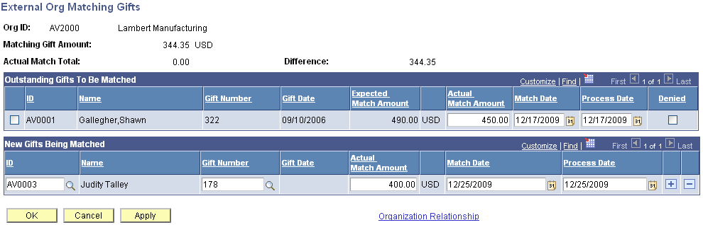

External Org Matching Gifts (external organization matching gifts)
AV_MTCH_O_GIFT_SEC
Click the Matching Gifts button on the Gift Entry page.
Enter existing gifts to be matched, or instantly create a relationship with the organization and then create the matching gift.

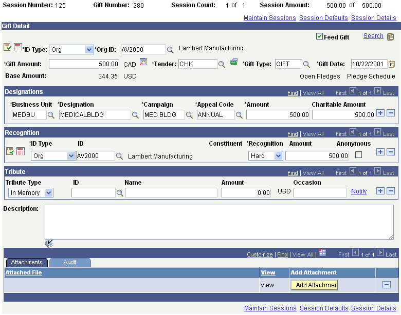

Access the Gift Entry page (Contributor Relations > Session Management > Enter Gifts > Gift Entry).
Image: Gift Entry page
This example illustrates the fields and controls on the Gift Entry page. You can find definitions for the fields and controls later on this page.
Gift Entry page
You can enter all the information necessary to store the transaction using this page and the pages accessed through links on this page.

Gift Detail
Field or Control
Definition
ID Type
Determine whether the donor is a person or an organization.
ID or External Org ID
Enter the ID number of the donor making the gift or pledge payment. When you enter an ID, the system automatically displays the name and constituent type. It also populates Recognition defaults for the user, including adding a row for any spouse on file.
Search
Click to access the Search/Match page where you can search for a donor.
See Using Search/Match.
Clipboard icon
Click to paste a carried ID found using Search/Match functionality.
Gift Amount
Enter the total amount of the donation. When you enter a gift amount, the system also populates the Amount and Charitable Amount fields in the Designations area, and also the Recognition and Amount fields in the Recognition area.
Display in Other Currency icon
If you are entering this session using a currency other than the business unit's base currency, click to access the Display In Other Currency Page where you can view the amount in another currency and obtain exchange rate information.
Tender
Enter the monetary form in which the gift is received. Examples are Cash, CC (credit card), CHK (check), and so on.
The values that appear in the prompt box depend upon the values you set up for on the Tender Types page for the setID associated with the business unit for this session.
Tender populates by default to the tender you selected on the Session Defaults page for this session. If you do not select a default tender for the session, this field populates by default to the tender you selected on the CR Business Unit page as a default tender for the session business unit.
If you enter a tender type that has the Allow Zero Amount Special Field selected during setup, you can enter a Gift Amount of zero. Otherwise, the gift amount must be greater than zero.
Tender Type icon
Depending on the tender type you select, click this button to enter its appropriate details on the Tender Type Detail page:
For Check, enter the Check Number on the page that appears.
For Credit Card, enter the constituent's credit card information on the page that appears.
If the credit card gift was mass loaded, the system populates address information, based on the Address Type field selected on the Mass Load Gift/Pledge page. Mass loaded credit card transactions are treated as though the user had entered the credit card gift online.
For GIK, enter the constituent's gift-in-kind details on the page that appears.
For Security, enter the description and details of the constituent's securities on the page that appears.
See Entering Tender Type Details.
Gift Type
Select the appropriate gift type from the valid gift types at your institution. Delivered gift types are Gift, PP (pledge payment), GIK (gift-in-kind), and MG (matching gift). Your institution can define additional gift types.
If you select PP, the Pledge field becomes active, so you can enter the number of the pledge associated with this payment.
Matching Gift is only a valid gift type when the donor is an organization.
Pledge
If this transaction is a pledge payment, select the associated pledge from the prompt box.
Gift Date
Enter the date on which the donation is given. This field populates by default to today's date.
Base Amount
If you are entering this session using a currency other than the business unit's base currency, the gift amount for the transaction appears in base currency in this field.
Note: When you save transactions entered in a currency other than your institution's base, the amounts are converted to and stored in base currency. When you view information about these transactions on inquiry pages throughout the system, they appear in base currency. However, you can view detail about the transaction currency and exchange rate by accessing the related detail page.
Matching Gifts
If the donor is a person:
Click to identify the organizations that might match this gift. You are prompted to run the matching gifts process. If you proceed, the system populates the Matching Gifts Page with its best guess at possible matches. If you do not run the automatic process, a blank Matching Gifts Page appears so you can manually enter an expected matching gift.
If the donor is an organization:
The Matching Gifts button does not appear unless the Gift Type is MG. Click to access the External Org Matching Gifts page where you can enter existing gifts to be matched. You can also instantly create a relationship with the organization and then create a matching gift for the person.
Important! You must assign designations and hard credit recognition prior to running the Matching Gifts process.
See Viewing Matching Gifts for Organizations.

Designations
You can apply donations to designations, or allocation accounts at your institution. For each designation you select, you must associate a specific campaign initiative and appeal. You can add the same designation to a gift, even if its associated campaigns are different.
When you enter this page, the system populates the Designations fields with values set on the Session Defaults page.
Field or Control
Definition
Business Unit
Enter the business unit that owns the designation, to which the gift or pledge payment is being allocated. The prompt box contains a list of all the valid business units at your institution, and populates by default to the value you selected from the Business Unit field on the Session Defaults page. When you make a selection, the values in the Designation and Appeal Code prompt boxes change to display the values you defined for the setID associated with this business unit. This is a required field.
If you have already selected a designation and appeal, then change the business unit, your selections are backed out.
Designation
Enter the designation to assign. Designations are funds at your institution to which donations and pledges can be allocated.
The values that appear in the prompt box include the designations you defined for the setID associated with the business unit you select on this page. The default value is the default designation you selected on the Session Defaults page.
Campaign
Enter a campaign, which is an organized institutional effort targeted to a specific constituency that occurs over a specified period of time with specific purposes and goals. The default value is the default initiative code you selected on the Session Defaults page.
Appeal Code
Enter an appeal code, which is the specific act or item that leads a donor to give, such as a visit, an annual phonathon, a letter, and so on.
The values that appear in the prompt box include the appeals you defined for the setID associated with the business unit you select on this page. The default value is the default appeal you selected on the Session Defaults page.
Amount
Enter an amount of the donation to allocate to this designation.
If you are entering gift transactions in a currency other than the business unit's base currency, the currency you selected is depicted on this page. However, for ease of reporting, designation information is stored by the system in base currency.
Charitable Amount
Enter the portion of the designated amount that is tax deductible.
Important! You can split the donation among several designations, but the total allocation must equal 100 percent of the gift amount. The designations you select for a pledge default when you enter payments for that pledge. Additionally, if the Pledge Payment Override Allowed flag is set, the user can edit the designations and recognition entries. If not, these fields fill by default from the pledge records and become unavailable for input.
Recognition
You can indicate which donors to recognize for a particular donation. Recognition can be assigned in the form of hard credit, or soft credits that are defined by your institution, such as memo and vehicle credits.
When your system is set up at your institution, you can define default recognition to split hard and soft credits between a donor and his or her spouse according to your institution's business practices. If these defaults exist, the system populates the Recognition fields.
Field or Control
Definition
Amount
Enter an amount of the donation that gives this donor recognition.
If you are entering gift transactions in a currency other than the business unit's base currency, the currency you selected is depicted on this page. However, for ease of reporting, recognition information is stored by the system in base currency.
Important! You can split the recognition among several donors, but the total allocation of hard credit recognition must equal 100 percent of the gift amount. You can assign an unlimited percentage of soft credit for a single transaction.
See Creating Soft Gift Entries.
Tribute
You can enter information about tributes, which are gifts made in honor or in memory of someone. You cannot enter a tribute amount that exceeds the amount of the gift or pledge being entered.
When you enter a pledge payment on the Gift Entry page during gift entry, the system displays all available tribute information associated with the pledge.
Field or Control
Definition
Tribute Type
Select In Memory or In Honor to indicate whether the tribute is in memory of a deceased individual or in honor of an individual.
Name
Identify the person receiving tribute or memorial recognition. It is not necessary to have an ID in the system to enter tribute and memorial information. If an ID does not exist, enter the person's name.
Notify
Click to access the Tribute page, where you can attach staff IDs to the tribute.
See Entering Tribute Details.
Note: No workflow is delivered with the Tribute page.

Access the Ext Org Matching Gifts page for organization gifts (Click the Matching Gifts button on the Gift Entry page).
Image: External Org Matching Gifts page
This example illustrates the fields and controls on the External Org Matching Gifts page. You can find definitions for the fields and controls later on this page.
When you enter this page, the system displays the ID, Name, and Exp Mtch Amt (expected match amount) of each donor for which the organization is expected to match a gift. You can also enter new IDs to create new matching gifts. If no relationship exists between the person and organization, click the Organization Relationship link to access the Org/Person Relationships page to instantly create one. You can then return to this page and create the new matching gift.
Outstanding Gifts to be Matched
Field or Control
Definition
ID
Select the check box for the gift that is being matched by the organization's matching gift payment.
Actual Match Amount
Enter the amount the organization is actually matching toward each donor's gift. This field populates by default to the expected match amount but can be overridden.
Match Date
Enter the match date. This field populates by default to today's date but can be overridden.
New Gifts Being Matched
The fields in this group box are similar to the ones above, but here you can create both an expected match and an organization matching gift at the same time. This is beneficial when an expected match is not yet on file in the system before the institution receives the matching amount.
Field or Control
Definition
ID
You can search for and select any ID that has an existing relationship with the organization.
If you want to create a new gift for an ID that has no current relationship defined with the organization, click the Organization Relationship link to instantly create a relationship. When you click the OK button, the system moves the ID up to the Outstanding Gifts to be Matched group box and you can then match the gift.
