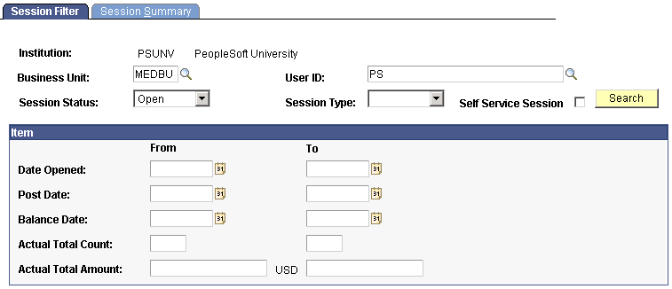

Access the Session Filter page (Contributor Relations > Session Management > Supervise Sessions > Session Summary > Session Filter).
Image: Session Filter page
This example illustrates the fields and controls on the Session Filter page. You can find definitions for the fields and controls later on this page.
Session Filter page
Field or Control
Definition
Business Unit
Enter the business unit for which to view session information.
Session Status
Select a valid session status, such as Open, Balanced, Posted, Queued, or Suspense. If you do not specify a session status, the Session Summary page displays all sessions, regardless of session status.
Field values are delivered with the system as translate values. Do not modify these translate values in any way. Any modifications to these values will require a substantial programming effort.
User ID
Displays the ID of the person who controls the session.
Note: This field is only available for selection if you are a gift and pledge supervisor; otherwise, your user ID appears here.
Session Type
Select a valid session type, such as Gift, Pledge, Gift Adjustment, Pledge Adjustment, Member, or Member Adjustment. If you do not specify a session type, the Session Summary page displays all sessions, regardless of session type.
Session types are delivered with the system as translate values. Do not modify these translate values in any way. Any modifications to these values will require a substantial programming effort.
Self Service Session
Select to filter for gifts made through the Involvement online giving process.
Date Opened, Post Date, and Balance Date
Enter a date opened, post date and balance date range. Select the earliest date in the range from the From prompt box, and the latest date in the range from the To prompt box. A post date range is the date range in which sessions were posted during the GL Interface process. A balance date range is the date range in which sessions were balanced in the system. The sessions matching your date ranges appear on the Session Summary page.
Important! To filter transactions for an exact date, enter the same value in both the from and to fields.
Actual Total Count and Actual Total Amount
Enter an actual total count and actual total amount range. Enter the lowest count or amount in the From field, and the highest count or amount in the To field. An actual total count range specifies the number of transactions contained in a session. The actual total amount range specifies the monetary total of a session. The sessions matching the ranges you enter appear on the Session Summary page.
Search
Click to retrieve a list of results matching your selection criteria.
Note: The Maximum Retrieval value, set on the Institution Installation page, determines the maximum number of results returned per search.

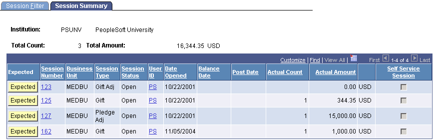

Access the Session Summary page (Contributor Relations > Session Management > Supervise Sessions > Session Summary > Session Summary).
Image: Session Summary page
This example illustrates the fields and controls on the Session Summary page. You can find definitions for the fields and controls later on this page.
If you are a Gift and Pledge Supervisor, you can reopen and transfer sessions using this page.
Field or Control
Definition
Expected
Click to reopen the Expected Count and Expected Amount fields on the Maintain Sessions page for editing. You must be assigned the role of gift and pledge supervisor through the Staff Roles page to access this button.
See Reopening and Editing Expected Counts and Amounts for Sessions.
Indicates the gifts in the session that were created as a result of online giving.
