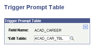

Access the Trigger Prompt Table page ().
Image: Trigger Prompt Table page
This example illustrates the fields and controls on the Trigger Prompt Table page. You can find definitions for the fields and controls later on this page.
Field or Control |
Definition |
| Edit Table |
Enter the source record that contains the field conditions to use on the Engine Trigger Definition page. Mapping to an edit table is optional. For example, to make academic career (ACAD_CAREER) values available from the Engine Trigger Definition page, map to the Academic Career Table (ACAD_CAR_TBL). You can delete the Trigger Prompt definition from the Trigger Prompt Table by using the Delete button on the page. |

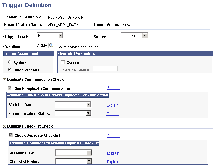

Access the Trigger Definition page ().
Image: Trigger Definition page (1 of 2)
This example illustrates the fields and controls on the Trigger Definition page (1 of 2). You can find definitions for the fields and controls later on this page.
Image: Trigger Definition page (2 of 2)
This example illustrates the fields and controls on the Trigger Definition page (2 of 2). You can find definitions for the fields and controls later on this page.
Field or Control |
Definition |
| Trigger Action |
The system displays the action (New (add), Change, or Delete) that you selected. The action must occur as described on this page to invoke the 3C engine. Note: The SavePostChange PeopleCode must use the same add, change, or delete action that you define here. |
| Trigger Level |
Select the level at which this action must occur to invoke the 3C engine. Record: The specified trigger action on the row invokes the 3C engine process, regardless of field. You must specify the 3C engine Event ID to process for a record level trigger. Field: The specified trigger action on the field invokes the 3C engine process. You must specify the Event ID to process and the fields on which the specified action occurs, to invoke the 3C engine. |
| Function |
Enter the functional area (administrative function) for this event trigger. |
Trigger Assignment
Field or Control |
Definition |
| System |
Select this check box to insert or update in real time, the communications, comments, and checklists specified in the 3C engine event ID. |
| Batch Process |
Select this check box to indicate that when the specified action occurs to the record or field, the system should insert a row on the Engine Trigger Results page for use by 3C engine background processing later. |
Override Parameters
Field or Control |
Definition |
| Override |
Select this check box to prevent the 3C engine from using the field or record conditions identified on this page, and, instead, use the logic configured around the Function Trigger3CEngine PeopleCode on the record or component location. If you select the Override option, you must specify the overriding 3C engine event ID to use. |
| Override Event ID |
Enter the 3C engine event to process when the Override option is selected. |
Duplication Communication Check
Field or Control |
Definition |
| Check Duplicate Communication |
Enter the 3C engine event to use to determine if a communication is a duplicate and to assign or prevent assignment according to the defined conditions. |
Duplicate Checklist Check
Field or Control |
Definition |
| Check Duplicate Checklist |
The 3C engine event that determines if a checklist is a duplicate and assigns or prevents assignment according to defined conditions. |

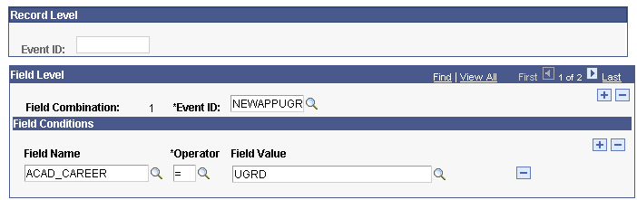

Record Level
Field or Control |
Definition |
| Event ID |
Enter the 3C engine event to process when the trigger level is Record. |
Field Level
Field or Control |
Definition |
| Field Combination |
The system displays the next sequential field combination for each field level event ID that you add. |
| Event ID |
Enter the 3C engine event to process when the trigger level is Field and the specified field conditions are met. |
Field Conditions
You can define multiple field combination conditions. When the specified trigger action meets any of the conditions, the 3C engine processes the specified field level 3C engine event.
Field or Control |
Definition |
| Field Name |
Enter the name of the field on the specified record that, when this trigger action is performed, must meet the specified condition to invoke the 3C engine. |
| Operator |
Enter the conditional operator for this field condition and the value that it modifies—for example, the admission term field (ADMIT_TERM) must be greater than or equal to 0390 (March 1990). Values for this field are delivered with the system as translate values. You can modify these translate values: < Less than. <= Less than or equal to. <> Not equal. = Equal to. > Greater than. >= Greater than or equal to. IN: In. |
