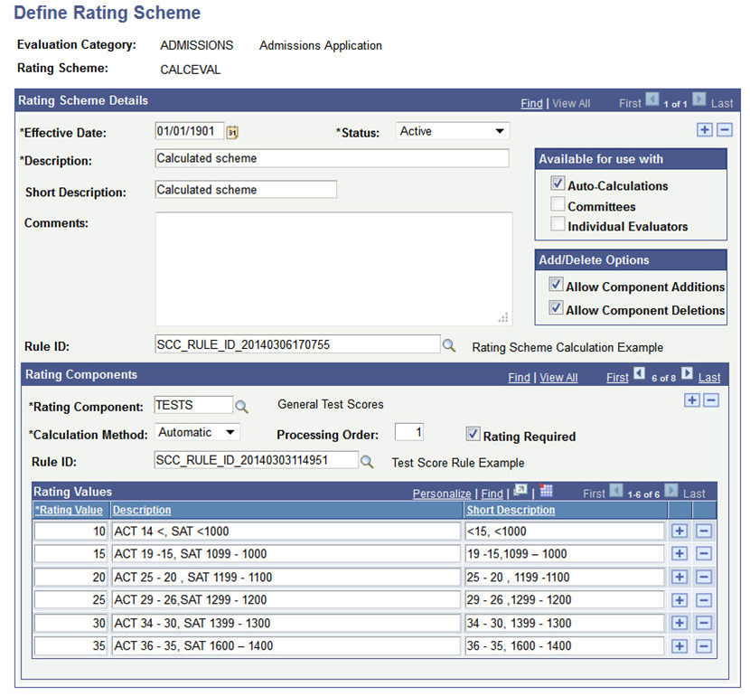

Access the Define Rating Scheme page ().
Image: Define Rating Scheme page
This example illustrates the fields and controls on the Define Rating Scheme page. You can find definitions for the fields and controls later on this page.
Available for use with
The options in this group box determine how a rating scheme can be used, whether by a Committees scheme, Individual Evaluators scheme, or by a scheme that uses Auto-Calculations. These settings control the values available for the Rating Scheme fields of the Committee Scheme and Individual Evaluator setup and the Rating Scheme field on the Evaluation Code setup. Committee Scheme and Individual Evaluator may be used concurrently. If you select Auto-Calculations, the other two options are unavailable. When you select Auto-Calculations, two Rule ID fields become available on the page: one at the scheme level and one for each rating component.
