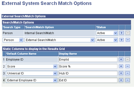

Access the External System Search Match Options page ().
Image: External System Search Match Options page
This example illustrates the fields and controls on the External System Search Match Options page. You can find definitions for the fields and controls later on this page.
If the Is External System Installed check box is not selected on the External Core Data Integration page, the following message appears: "Currently, no External System is configured with Campus Solutions. To configure an External System, navigate to External Core Data Integration page."
Search/Match Options
Fields in this group box determine the conditions under which the system uses Search/Match, External Search/Match, or both when adding a new person or saving an updated bio/demo page.
Field or Control |
Definition |
| Search Type |
Select Person, Applicant, or Organization. Note: At this time, you may only select the Person option. The other search types are not yet integrated with External Search/Match. |
| Search/Match Option |
Select the Search/Match functionality to use when an external system is installed: If you select Internal Search/Match and you make it Active, then the Search/Match process searches for person IDs inside the CS database. If you select External Search/Match and you make it Active, then the External Search/Match process searches for person IDs inside the integrated external system. If you clear the status or make the status Inactive, the system does not trigger a specific Search/Match tool. Note: Both searches can be selected at the same time, and results from both searches appear on the same Integrated Search Results page. |
Static Columns to Displays in the Results Grid
Fields in this group box contain information about additional columns to display inside the Results grid of the Integrated Search Results page.
Field or Control |
Definition |
| Default Column Name |
Select EmplID, Universal ID, Score, or External Employee ID. These are delivered translate values; do not modify them. EmplID is displayed by default (just like for Search/Match). Universal ID is a generic term that refers to the external system ID in use. When selected, the external system ID is displayed inside the Additional Information tab of the Results grid. Score is a generic term that refers to your external system method for ranking the matches found. It is the weight or the accuracy of the results found. It is sometimes expressed by a percentage or a number. If your external system does not have ranking capability, do not select this option. When selected, the column appears first in the Results grid. If you select Score, then the system sorts search results in the Results grid by score in descending order and by EmplID in ascending order. If you do not select Score, then the search results appear only by EmplID in ascending order. External Employee ID refers to the External HCM system EmplID. It is specifically used when the institution has selected to import external EmplIDs rather than generate a CS-unique EmplID. |
| Display Name |
Enter a custom column name for the static columns that appear in the Results grid. |
