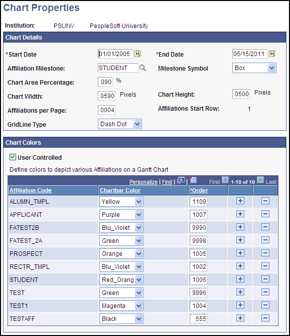

Access the Chart Properties page (Campus Community > Affiliations > Affiliations Gantt Chart Setup > Affiliations Gantt Setup).
Image: Chart Properties page
This example illustrates the fields and controls on the Chart Properties page. You can find definitions for the fields and controls later on this page.

Field or Control
Definition
Chart Start Date
Enter the Start Date of the period of time that the chart will display on the X-axis (horizontal). The chart only displays those affiliations that are within the range of the Start Date and End Date. If an Affiliation is not completely within the range, the Affiliation is not displayed.
Chart End Date
Enter the End Date of the period of time that the Gantt chart will display on the X-axis (horizontal).
Affiliation Milestone
Select an Affiliation to view in relationship to all other affiliations with which the person is associated. The Affiliation Milestone takes the start date of the Affiliation and denotes it as the milestone.
Milestone Symbol
Select a graphical symbol to display in the Chart for the Affiliation Milestone.
Chart Area Percentage
Enter the percentage of the page to use for the chart portion of the page; the remaining area is used for the table portion.
Chart Height
Enter the height of the chart area represented in pixels. Maximum value is 9999. Oracle recommends a value less than the display area and resolution value of the computer monitor.
Chart Width
Enter the width of the chart area represented in pixels. Maximum value is 9999. Oracle recommends a value less than the display area and resolution value of the computer monitor.
Affiliations Per Page
Enter the maximum number of Affiliations that can be displayed on the chart at one time.
Affiliation Start Row
Displays default value of 1.
Gridline Type
Select the gridline appearance.
User Controlled
Select this check box for the option of selecting the color and display order for each Affiliation displayed on the chart.
Note: If you select the User Controlled check box, you must select a Chartbar Color and enter a unique Order number for each Affiliation Code you want to display.
Affiliation Codes that do not have both a Chartbar Color and Order assigned are not displayed in the Affiliations Chart View.
If the check box is NOT selected, the system no longer assigns a Chartbar Color, but adds a default Order number of 9999. If you do not want the Affiliation Code displayed, do not specify a color. To display the Affiliation Code, select a color and specify an order number from 1 - 9998. There are 18 available colors so if an institution has defined more than 18 Affiliation Codes, multiple Affiliation Codes will have the same Chartbar Color assigned.
Chartbar Color
Select a display color for the Affiliation.
You must select one of the 18 available colors if you want the Affiliation to be displayed.
Order
Enter a unique number, up to 4 digits, to determine the order in which Affiliations are displayed on the chart.
The default Order number is 9999. For an Affiliation to be displayed, you must specify an Order number between 1- 9998 and a Chartbar Color. No two Affiliations can have the same order number
