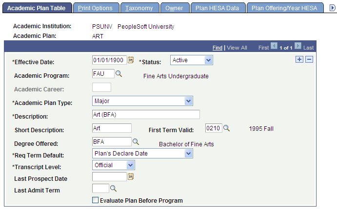

Access the Academic Plan Table page ().
Image: Academic Plan Table page
This example illustrates the fields and controls on the Academic Plan Table page. You can find definitions for the fields and controls later on this page.
Warning! If you modified the academic program or academic career to which an academic plan belongs, you must first deactivate the academic plan by inserting a new row and entering the status of inactive. Then, you must add another new row to tie the academic plan to a different academic program or academic career. This procedure ensures proper functionality of academic plan prompts throughout the system.
Field or Control |
Definition |
| Academic Program |
Enter the academic program or an academic career to which this academic plan belongs. To require that a student be admitted to a specific academic program before declaring the academic plan, enter an academic program to link to this academic plan. |
| Academic Career |
Enter an academic career to link to the academic plan if you want students in any academic career to be able to declare the academic plan. For example, an institution might enable all undergraduates to declare computer science as a major (academic plan), regardless of whether students are in a liberal arts program or an engineering program. |
| Academic Plan Type |
Select a type for this academic plan, such as Major, Minor, or Concentration. You can modify these translate values. |
| First Term Valid |
Enter the first term in which students can be admitted to the academic plan. You cannot admit students to the academic plan before the term that you specify. If you enter the term 0000, you can admit students to the plan for any term. When you convert data to the PeopleSoft system, be sure that you select a first valid term that is appropriate for the preexisting data for each academic plan. This field is optional. Note: Students can modify this plan when their admit term is prior to this term as long as the effective date of the modification is greater than or equal to the start date of this term. |
| Degree Offered |
Enter the degree offered for completion of the academic plan. If the institution offers dual degrees, you must establish separate academic plans for each degree or create a combined degree, such as B.A./B.S. The system creates degree records according to the definition of the academic plan. Therefore, if a student graduates with dual degrees and the degrees are the same—such as an English B.A. and a psychology B.A.—the system creates one degree record. However, if a student graduates with dual degrees and the degrees are different—such as an English B.A. and a biology B.S.—the system creates two degree records, one for each degree. |
| Req Term Default (requirement term default) |
Select the default term for which the system begins accumulating requirements for the academic plan. You can override the default value for individual students on the Student Plan page. Modification to these translate values requires significant programming. Note: Set this default so that, when you analyze completion requirements for an academic plan, you know which set of requirements to use. Requirements can change over time. |
| Transcript Level |
Select a transcript level to determine the types of transcripts on which the system includes the specified data. Values are: Not Print, Official, Unofficial, Stdnt Life (student life), and Degr Prog (degree progress). |
| Last Prospect Date |
Enter the latest date that a plan can be populated for a new prospect record. You cannot assign a plan to a prospect if the system date is greater than the last prospect date. |
| Last Admit Term |
Enter the last term in which students can be admitted to the academic plan. You cannot admit students to the academic plan after the term that you specify. The system will compare the admit term used in the student's application to this last term valid value. If the admit term is greater than this value, then the program is not available to the user. This field is optional. |
| Evaluate Plan Before Program |
Select to alter reporting sequences. This check box is a feature of PeopleSoft Academic Advisement. |

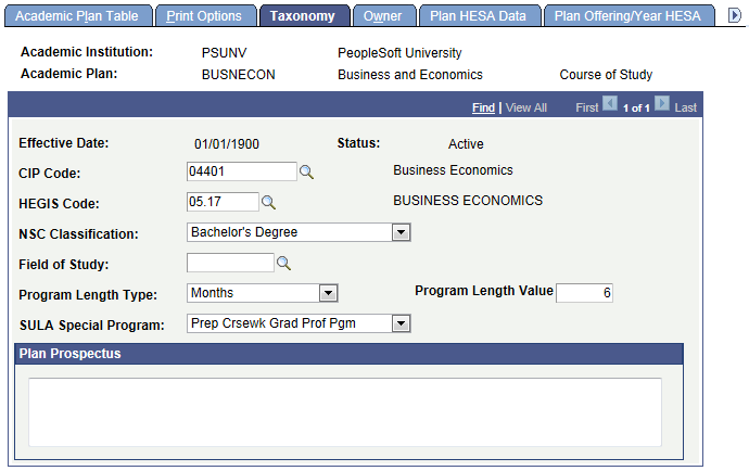

Access the Taxonomy page ().
Image: Taxonomy page
This example illustrates the fields and controls on the Taxonomy page. You can find definitions for the fields and controls later on this page.
Note: For National Student Clearinghouse (NSC) reporting, program level data is sourced from the Academic Plan Table. You must enter a value in the following fields: CIP Code, NSC Classification, Program Length Type, Program Length Value, and SULA Special Program.
See:
Setting Up For NSC Program Level Reporting
Understanding Consolidate Academic Statistics Process Calculations
Field or Control |
Definition |
| CIP Code (Classification of Institutional Programs code) |
Enter the CIP code for this academic plan. CIP codes are delivered with the system as translate values. You can modify CIP codes on the CIP Code Table page. |
| HEGIS Code (Higher Education General Information Survey code) |
Enter the HEGIS code for this academic plan. HEGIS codes are delivered with the system as translate values. You can modify HEGIS codes on the HEGIS Code Table page. |
| NSC Classification (National Student Clearinghouse Classification) |
Enter a NSC Classification. NSC Classification values are delivered with the system as translate values. The system uses this value to derive a Class/Credential Level for each student in the NSC enrollment extract. Note: If you enter a value of Bachelor's Degree here, you must also enter a value (for example Sophomore) in the NSC Level Category field on the Academic Level Table page. |
| Field of Study |
Enter a field of study for the academic plan. |
| Report as NSC Program |
Select to identify a plan as one that should be reported as a program for NSC reporting purposes. When this check box is selected, all related NSC fields (CIP Code, NSC Classification, Program Length Type/Value, SULA Special Program) must have values. |
| Program Length Type |
Select the unit of time you want to use to define the Program Length: Weeks, Months, or Years. |
| Program Length Value |
Enter the number of weeks, months, or years for the length of the Program. |
| SULA Special Program (Subsidized Usage Limit Applies special program) |
Select a SULA Special Program. Values include:
Note: If this field is left blank, and the corresponding field is also blank in on a student’s FA Term record, then the field on the student’s FA Term is populated in the following ways:
1. FA Term Build (online and batch) populates this field as "Not Applicable". 2. The SULA Application Engine Request process populates this field as "Not Applicable". 3. Manual updates to the FA Term > Statistics page auto-populate this field as "Not Applicable". See Setting Up 150 Percent Direct Subsidized Loan Limit (SULA). |
| Plan Prospectus |
Enter descriptions of the academic plan, such as information about special programs, faculty, and associated societies. You can then create a separate advisement report querying this field and print the report for brochures and other documentation. |
