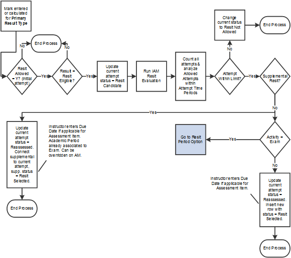

Understanding Resit Eligibility and Calculation
Activity Management supports the resit (reassessment) functionality. This feature evaluates if a student is eligible for a resit and, if so, performs a calculation to determine the resit result. Schools could set up a number of criteria to support their reassessment policy.
The rules designed to analyze resit eligibility and calculation of a resit result depend on the setup from a variety of sources, including the:
Result Scale - Resit Eligible flag
Resit Option - Resits Allowed flag
Resit Option – Attempt Limits
Resit Option – Resit Period Assignment
Resit Calculation Option
Academic Period
Result entered on the student IAM
Image: Resit Eligibility Evaluation
This diagram outlines the resit eligibility evaluation process.

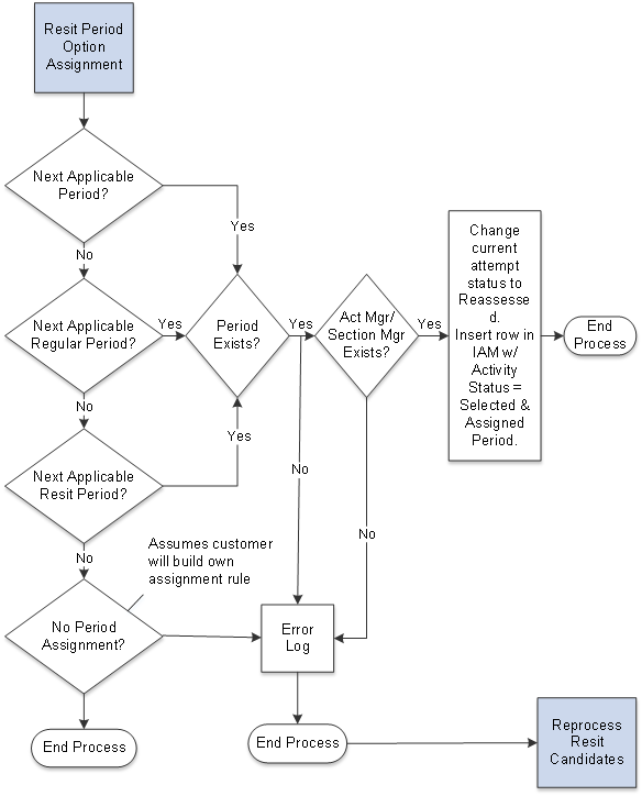

Image: Exam Period Assignment
This diagram outlines the exam period assignment process.
