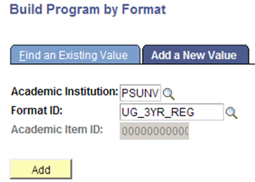

To build a program by format in Add mode:
Add the program by selecting an Institution and Program Format.

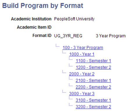

The Program Format appears in a Tree view when the component opens:
Image: Build Program by Format step 2 example page
This example illustrates step 2 in the Build Program by Format (Add mode) process.
Each node of the tree is a link/prompt for you to:
Build a new academic item for the node or
Associate an existing item with the node or
Clone an existing item to create a new item for the node.
You must assemble the program in accordance with the tree structure. Begin at the root (program) node. If you click any other link you receive a message instructing you to assign the item for the Parent node. The message returns the node ID that should be used (in this example it would be 100). This same message is returned if you skip a level in the tree. In this example if you assign the item for node 100, but then click the link for 1100, the error message instructs you to first assign the item for the parent (1000).

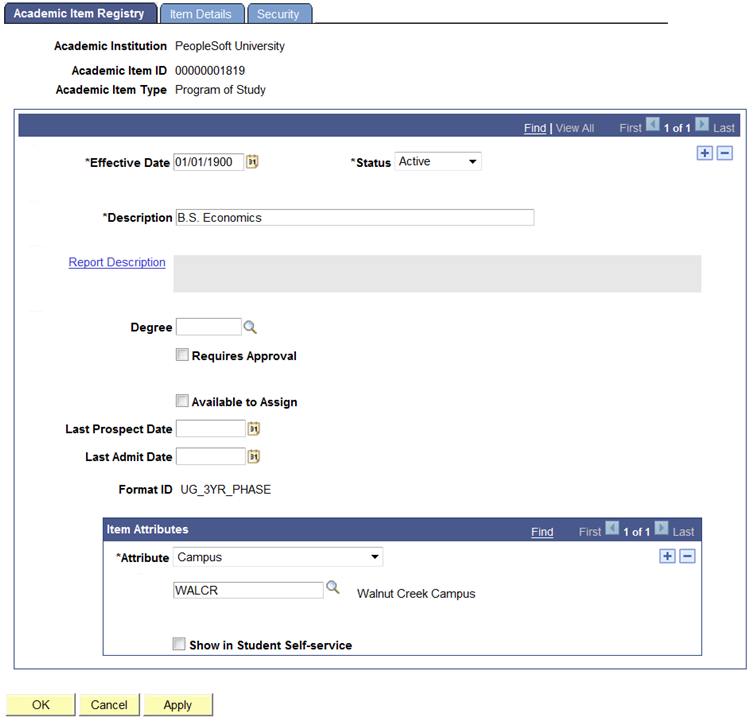

Click the link for the root node that represents the Program of Study: you are transferred to the AIR component where you create a new academic item for the Program node.
Image: Academic Item Registry Program Node example page
This example illustrates step 3 in the Build Program by Format (Add mode) process.
The Institution and Academic Item Type (Program of Study) appear by default and cannot be changed. All of the features of the AIR component are available. You can:
Save and return to the Build Program by Format page by clicking OK.
Discard any changes and return by clicking Cancel.
Save any changes and remain on the AIR component by clicking Apply.

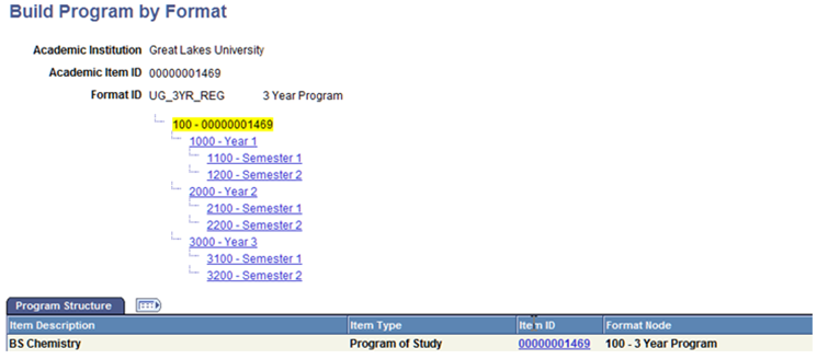

When you click OK, the item is saved, an academic item ID is assigned, and you are returned to the Build Program by Format main page:
Image: Build Program by Format (Add Mode) After AIR Save
This example illustrates the Build Program by Format main page after you save the AIR component.
The tree node where the item was assigned is highlighted and inactivated. The Program Structure tab opens and the academic item (and any child items) that was assigned to the node is listed.
If updates are required, use the Item ID link to access the item.

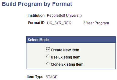

When you click the link for any other item type in the tree, you are transferred to the Build Program by Format - Select Mode (SSR_PRG_BLDR_SEL) page where you specify how you want to assign the item for this node. By default, the Item Type value is the item type of the node and cannot be changed.
Image: Build Program by Format (select mode) page
This example illustrates the fields and controls on the Build Program by Format (select mode) page. You can find definitions for the fields and controls later on this page.
Field or Control |
Definition |
| Create New Item |
When you select this option, you are transferred to the AIR component. Institution and Academic Item Type values appear by default and cannot be changed. After you create the item in AIR and click OK, you are returned to the Build Program by Format main page and the node is inserted in the program structure. |
| Use Existing Item |
When you select this option, the Academic Item ID field becomes available (the Item Type value is the item type of the node and cannot be changed). The academic items that are available match the Institution, Item Type, and Effective Date of the Program Node. If you select an existing item, you are returned to the Build Program by Format main page and the node is inserted in the program structure. |
| Clone Existing Item |
If you select this option, the academic items that are available match the Institution, Item Type, and Effective Date of the Program Node. If you select an existing item, you are transferred to the AIR component. The Effective Date is, by default, the Effective Date of the Program Node and cannot be changed. After you clone the item, you are returned to the Program by Format main page and the node is inserted in the program structure. Note that when you copy an item that has child items, the cloned item and the original item share the same child items. |

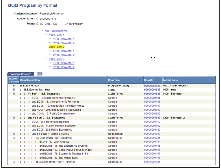

When academic items are assigned to the tree nodes, the program structure is tracked in the Program Structure tab on the Build Program by Format page. The display is updated as academic items are created/assigned to tree nodes. Rows are inserted for each assigned item as well as any child items entered for the item (or child items that were attached to an existing item).

You can use the Build Program by Format component to retrieve and update an existing program. Items can be assigned to tree nodes and existing items can be maintained. The search record is restricted to academic items with an academic item type of PRG.

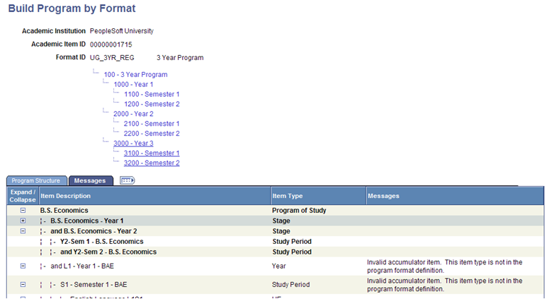

In addition to the program format audit messages, the Build Program by Format component also displays messages when an invalid Program Format Tree Node item has been inserted in a program tree. This could occur if you retrieved an item associated with a tree node in the Academic Item Registry component, because this action is prevented on the Build Program by Format component. The error is detected by the audit process and an error message is displayed on the Errors tab on the Build Program by Format page. When messages are present, the Errors tab appears as the Messages tab.
Field or Control |
Definition |
| Messages |
The message identifies the invalid node. This item type is not attached to a node in the tree branch. |
