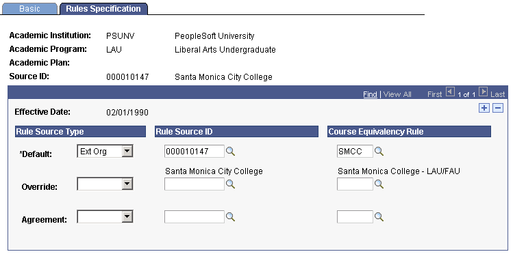

Access the Rules Specification page (Records and Enrollment > Transfer Credit Rules > Program/Source Equivalency > Rules Specification).
Image: Rules Specification page
This example illustrates the fields and controls on the Rules Specification page. You can find definitions for the fields and controls later on this page.
You must specify the credit source type from which you will select your source ID. If you enter external organization, the system prompts you with the source IDs of external organizations in your system. If you enter institution, the system prompts you with source IDs of academic institutions that you defined in your system.
All of the following group boxes have Agreement, Override, and Default fields. Each identically named field functions as a row of data to define a course equivalency rule. Each of these fields is documented once, following the group box definitions. As the Transfer Credit process evaluates courses, it uses the rules in this order: agreement, override, default.
Rule Source Type
Use the fields in this group box to select the table from which you will select each of your course equivalency rules for this academic program/plan and source combination. Select from the following choices.
Field or Control
Definition
External Org (external organization)
The system prompts you with the external organization source IDs in your system. Because external organizations and internal academic institutions can share the same course catalog, you might want to point to a different source ID for the course catalog.
Institution
The system prompts you with institution source IDs in your system.
Rule Source ID
Use the fields in this group box to select the source ID for the course transfer equivalency rule for this academic program/plan and source combination. You can point to any sources rules.
Course Equivalency Rule
Use the fields in this group box to select the specific course transfer equivalency rules for this academic program, academic plan, and source combination.
Common Course Equivalency Rule Fields
Field or Control
Definition
Agreement
The Transfer Credit process uses the course equivalency rule that you specify on this row first. If the transfer course meets the criteria of the rule specified on this row, the process applies the rule to the transfer course and evaluates the course no further. If you did not specify a rule for this row, or if the transfer course does not meet the criteria of the rule, the process then evaluates the course equivalency rule that you specify on the Override row.
Override
The Transfer Credit process uses the course equivalency rule that you specify on this row next. If the transfer course meets the criteria of the rule specified on this row, the process applies the rule to the transfer course and evaluates the course no further. If you did not specify a rule for this row, or if the transfer course does not meet the criteria of the rule, the process then evaluates the course equivalency rule that you specify on the Default row.
Default
The Transfer Credit process uses the course equivalency rule that you specify on this row last. If the transfer course meets the criteria of the rule specified on this row, the process applies the rule to the transfer course and evaluates the course no further. If you did not specify a rule for this row, or if the transfer course does not meet the criteria of the rule, the process will not articulate the course. In this case, the transfer course appears on the Transfer Course Details page with a status of no rule.
Note: If you have only one rule for this source, you must enter it in Course Equivalency Rule field in the Default row. The Default row is the only row on the page that requires a course equivalency rule.
