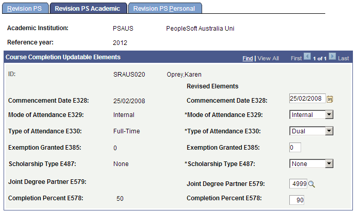

Viewing Academic Record Data Elements for the Revision
Access the Revision PS Academic page (Records and Enrollment > Enrollment Reporting > AUS Regulatory Reporting > Student Data Collection > Course Completion Revisions > Revision PS Academic).
Image: Revision PS Academic page
This example illustrates the fields and controls on the Revision PS Academic page. You can find definitions for the fields and controls later on this page.
Revision PS (Past Course Completions) Academic page
This page displays originally reported data on the left side, and revised elements on the right side. All revised elements on this page are available to be updated for revision types of revision and addition. The value for the Revised Elements field defaults to the value as originally reported. No revised elements appear for a revision type of deletion.
