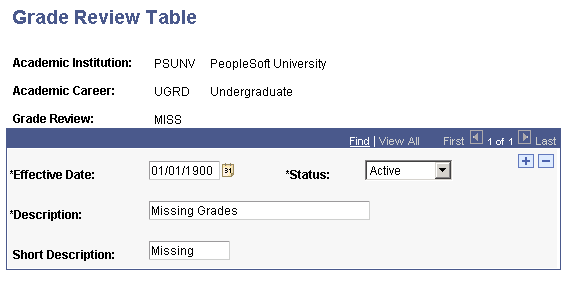

Access the Grade Review Table page (Set Up SACR > Product Related > Student Records > Grading > Grade Review > Grade Review Table).
Image: Grade Review Table page
This example illustrates the fields and controls on the Grade Review Table page. You can find definitions for the fields and controls later on this page.
Field or Control
Definition
Effective Date
Enter an effective date for this grade review status. The effective date defines when the status that you select is valid.
Status
Select a status for this grade review. Select Active when adding a new grade review status. The Inactive option should only be used if your institution will no longer use this grade review status.
Description
Enter a description for the status. The description appears on the Student Grade Review page.
Short Description
Enter a short description for the status.

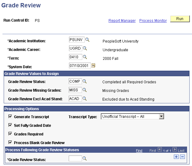

Access the Grade Review page (Curriculum Management > Grading > Grade Review > Grade Review).
Image: Grade Review page (1 of 2)
This example illustrates the fields and controls on the Grade Review page (1 of 2). You can find definitions for the fields and controls later on this page.

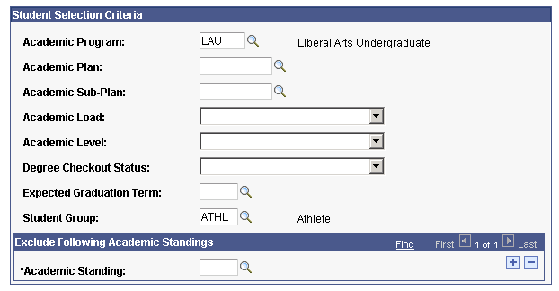

Image: Grade Review page (2 of 2)
This example illustrates the fields and controls on the Grade Review page (2 of 2). You can find definitions for the fields and controls later on this page.
Field or Control
Definition
Academic Institution
Select the institution for which you want to run the grade review process. The system populates this field by default to the setting on the User Defaults 1 page.
Academic Career
Select the academic career of students for which you want to run the grade review process. The system populates this field by default to the setting on the User Defaults 1 page.
Term
Select the term for which you want to run the grade review process. The system populates this field by default to the setting on the User Defaults 1 page.
System Date
The process assigns this date to the student records when it assigns new grade review values. For example, if a student is fully graded and meets all other processing parameters, the student's grade review status is set to COMP on the Student Grade Review page, with an effective date equal to the system date. In addition, if you select the Set Fully Graded Date check box, the system sets the student's fully graded date to the system date on the Term Control Dates page.
Grade Review Status
Select a status to assign to a student on the Student Grade Review page if the system finds him to be fully graded for the term.
Grade Review Missing Grades
Select a status to assign to a student on the Student Grade Review page if the system finds the student to be in acceptable academic standing but lacking fully graded enrollment records for the term. If a student is neither fully graded nor in acceptable standing, the system assigns the value in the Grade Review Excl Acad Stand field to the student on the Student Grade Review page.
Grade Review Excl Acad Stand (grade review excluded due to academic standing)
Select a status to assign to a student on the Student Grade Review page if the system finds him to be fully graded but his academic standing for the term is equal to the value in the Academic Standing field. If a student is neither fully graded nor in acceptable standing, the system assigns the value in the Grade Review Excl Acad Stand field to the student on the Student Grade Review page.
Generate Transcript
Select to process transcripts for the students in your selected population.
Warning! If you select the Generate Transcript check box and run the Grade Review process, the system immediately generates transcripts (not just transcript request numbers) for all students in your population. Depending on the size of your population and the transcript type you select, this process could take a substantial amount of time to complete.
Select to set a student's fully graded date (on the Term Control Dates page) to the system date you specify in the System Date field. The system sets the fully graded date only if the process assigns a new grade review status to the student. If no grade review status is assigned, the fully graded date field does not update. Clear this check box if you never want to update the fully graded date.
Grades Required
Select to have the system use the Grade Required check box setting on the Grade Scheme Table page to determine if grades are missing. If you select this check box, the system only evaluates courses taken with grade bases for which the Grade Required check box is selected. If you clear this check box, students in the population will be set regardless of whether their grades are in.
Process Blank Grade Review
Select to include in your student selection students with no grade review value.
Grade Review Status
Enter the current grade review status of students that you want to process. Add rows to specify more than one valid grade review status value.
Academic Program
Select the academic program of the students you want to review.
Academic Plan
Select the academic plan of the students you want to review.
Academic Sub-Plan
Select the academic subplan of the students you want to review.
Academic Load
Select the academic load of the students you want to review for the term you specify.
Academic Level
Select the academic level (term begin) of the students you want to review for the term you specify.
Degree Checkout Status
Select the degree checkout status of the students you want to review.
Expected Graduation Term
Select the expected graduation term of the students you want to review.
Student Group
Select the student group of the students you want to review.
Academic Standing
Select the academic standing of students (on the Term History page for the term you specify) that you want to exclude from the grade review. Add rows to specify more than one type of academic standing value that you want to exclude from the review.
Click Run to run this request. PeopleSoft Process Scheduler runs the Grade Review Process Driver process at user-defined intervals. If you selected the Generate Transcripts check box, you can view the transcripts online or print them when the process finishes.
