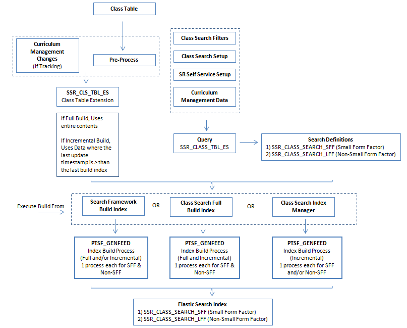

Image: Overview of Class Search and Elasticsearch Administrative Process
This diagram is an overview of the administrative processes required to build class search indexes

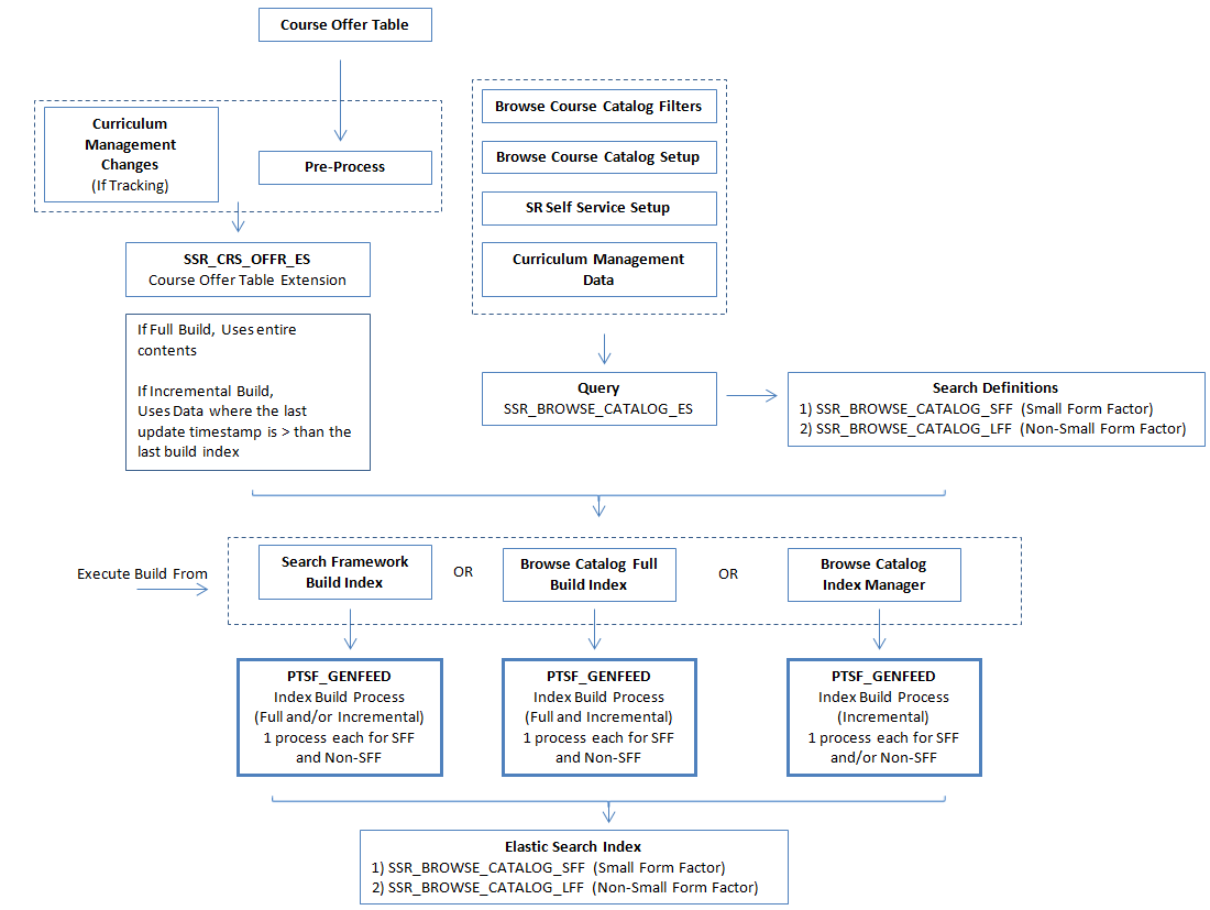

Image: Overview of Course Search and ElasticSearch Administrative Process
This diagram is an overview of the administrative processes required to build course search indexes

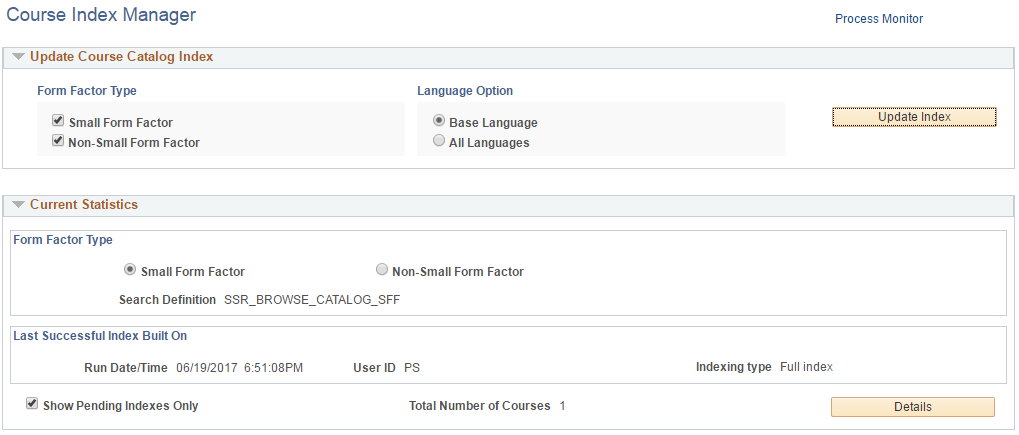

Course Index Manager
SSR_BC_IDX_TERM_FL
Curriculum Management > Fluid Browse Course Catalog > Course Index Manager
Run an incremental build.

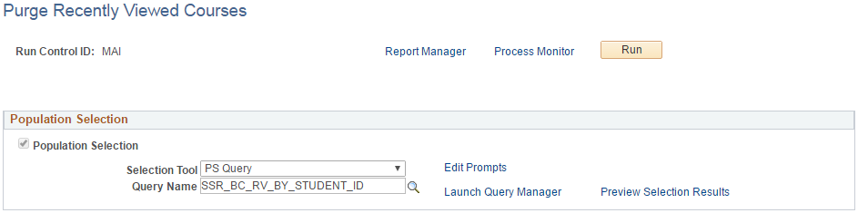

Purge Recently Viewed Courses
SSR_BC_RV_PURG_FL
Curriculum Management > Fluid Browse Course Catalog > Purge Recently Viewed Courses
Remove recently viewed courses from the course catalog.
After you install and implement PeopleSoft Search Framework and Elasticsearch as well as through the full setup of class search options for Fluid, you must run the Class Search Index Pre-Process and Class Search Index Full Build to build the initial class search index.
The following table indicates the administrative changes that require an index build, and identifies which processes to run. Use the information in this table in conjunction with the succeeding information about maintaining indexes on an ongoing basis. Extreme care should be taken when running a full build index—this should be run only during downtime—because search results are not displayed. The pre-process and incremental build can be used in combination during most situations (and does not require class search downtime), except when there are changes to search definitions.

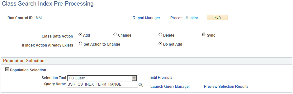

Access the Class Search Index Pre-Processing page (Curriculum Management > Fluid Class Search > Class Search Index Pre-Process).
Image: Class Search Index Pre-Processing page
This example illustrates the fields and controls on the Class Search Index Pre-Processing page. You can find definitions for the fields and controls later on this page.
Use this page to determine which schedule of classes are available in class search. Initially, this process should be run to add classes for terms that you want to be available in class search. You can also use this page for ongoing maintenance.

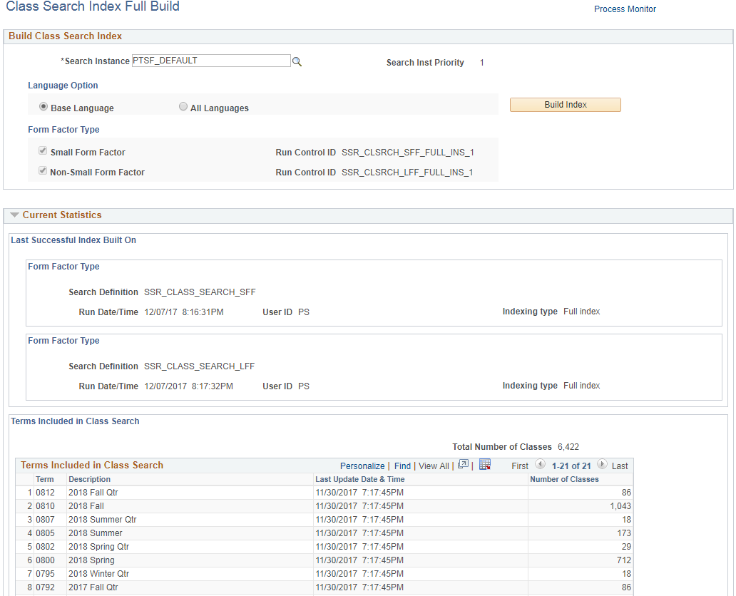

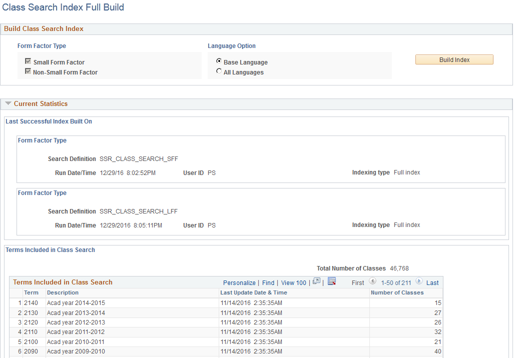

Access the Class Search Index Full Build page (Curriculum Management > Fluid Class Search > Class Search Index Full Build).
Image: Class Search Index Full Build page
This example illustrates the fields and controls on the Class Search Index Full Build page. You can find definitions for the fields and controls later on this page.
Field or Control
Definition
Search Instance
Select the search instance you want to use. The run control IDs for the form factor types automatically update to correspond to the search instance you select.
The full build process should be run after the initial implementation of Elasticsearch, PeopleSoft Search Framework search definitions, and setting up class search for Fluid. The process runs for both small and non-small form factor devices. It indicates the terms and number of classes that have had indexes built.
Warning! Running the full index build process prevents self-service class search from displaying search results as all the indexes are rebuilt. Exercise extreme care when running this process. Make sure you run this process only during system downtime or when students do not have access to Class Search.

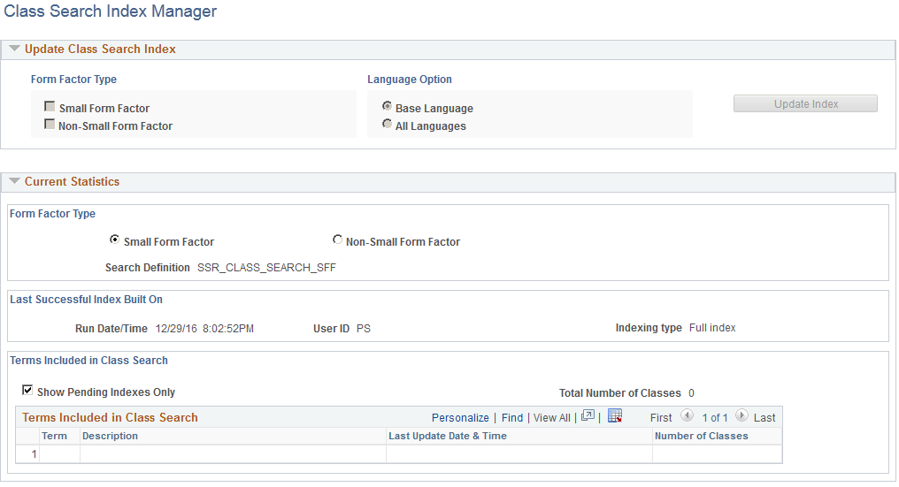

Access the Class Search Index Manager page (Curriculum Management > Fluid Class Search > Class Search Index Manager).
Image: Class Search Index Manager
This example illustrates the fields and controls on the Class Search Index Manager. You can find definitions for the fields and controls later on this page.
Use the Class Search Index Manager page to manually trigger an incremental build. The process indicates which class changes are to be made. This page displays pending classes that require an incremental build, and allows the submission of an incremental build process. The incremental build process does not prevent class search results from being displayed as not every index is rebuilt.

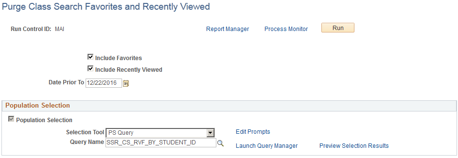

Access the Purge Class Search Favorites and Recently Viewed page (Records and Enrollment > Fluid Class Search > Purge Favs and Recently Viewed.
Image: Purge Class Search Favorites and Recently Viewed
This example illustrates the fields and controls on the Purge Class Search Favorites and Recently Viewed. You can find definitions for the fields and controls later on this page.
Use this page to remove either favorites or recently viewed classes—or both—from class search. Because favorites and recently viewed classes are term-specific, you normally run this process at the end of the term.
Field or Control
Definition
Date Prior To
Select to define the date when data should be removed.

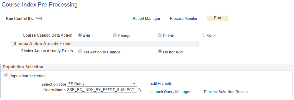

Access the Course Index Pre-Processing page (Curriculum Management > Fluid Browse Course Catalog > Course Index Pre-Processing).
Image: Course Index Pre-Processing page
This example illustrates the fields and controls on the Course Index Pre-Processing page. You can find definitions for the fields and controls later on this page.
Course Index Pre-Processinge page
Use this page to determine which courses appear in the course catalog. Initially, you run this process to make courses available for search in the course catalog. You can also use this page for ongoing maintenance.
Field or Control
Definition
Add
Select to add new courses to the index.
Example: Adding course for new subject
Delete
Select to remove courses from the index.
Example: Removing courses from a subject that is no longer offered
Change
Select to update courses already indexed.
Example: Adding course search filters, changes to courses typically offered, units, and so on
Sync
Select to correct courses that are not in the course table but exist in the index, and vice-versa. You can run Sync only when using the query SSR_BC_INDX_BY_EFFDT_SYNC.
Population Selection
The Population Selection group box is a standard group box that appears on run control pages when the Population Selection process is available or required for the transaction. Selection tools are available based on the selection tools that your institution selected in the setup of the Population Selection process for the application process and on your user security. Fields in the group box appear based on the selection tool that you select. The fields behave the same way from within the group box on all run control pages and application processes. If your institution uses a specific delivered selection tool to identify IDs for a specific transaction, you must use it.
Select the Population Selection check box to use the Population Selection process to select the courses that you want to be available in the course catalog search. When you select this check box, the Selection Tool and Query Name fields become available. Oracle recommends you use the delivered queries.
Field or Control
Definition
Selection Tool
Select PS Query.
Query Name
The following queries are provided:
  • SSR_BC_INDX_BY_EFFDT: Course Catalog Index by Effective Date
  • SSR_BC_INDX_BY_EFFDT_CAREER: Course Catalog Index by Career
  • SSR_BC_INDX_BY_EFFDT_SYNC: Course Catalog by Effective Date Sync
  • SSR_BC_INDX_BY_EFFDT_SUBJECT: Course Catalog Index By Subject

Access the Course Index Manager page (Curriculum Management > Fluid Browse Course Catalog > Course Index Manager).
Image: Course Index Manager page
This example illustrates the fields and controls on the Course Index Manager page. You can find definitions for the fields and controls later on this page.
Use the Course Index Manager page to manually trigger an incremental build. The process indicates which course changes are to be made. This page displays pending courses that require an incremental build, and allows the submission of an incremental build process. The incremental build process does not prevent course search results from being displayed as not every index is rebuilt.
Access the Purge Recently Viewed Courses page (Curriculum Management > Fluid Browse Course Catalog > Purge Recently Viewed Courses.
Image: Purge Recently Viewed Courses page
This example illustrates the fields and controls on the Purge Recently Viewed Courses page. You can find definitions for the fields and controls later on this page.
Use this page to remove recently viewed courses from browse course catalog.
Campus Solutions provides the following queries:
Select the Population Selection check box to use the Population Selection process to select the favorites and recently viewed classes that you want to purge. When you select this check box, the Selection Tool and Query Name fields become available.
Field or Control
Definition
Selection Tool
Select PS Query.
Query Name
  • SSR_BC_RV_BY_STUDENT_ID: Purge Student ID
  • SSR_BC_RV_BY_INSTITUTION1: Purge by Institution only
  • SSR_BC_RV_BY_INSTITUTION: Purge by Student ID and Institution
