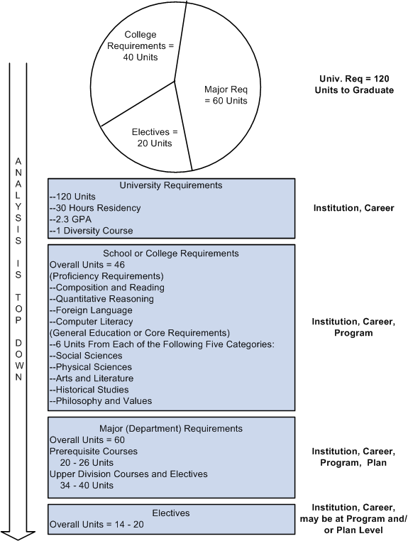

Traditionally, the academic structure of an institution is built from the top level down (for example, the total number of units needed to graduate through specific requirements for programs and plans). This traditional approach to academic structure is still valid and very necessary; however, while making use of this approach, the Academic Advisement application is built from the bottom level up (for example, course lists are defined first, followed by academic requirements, then requirement groups).

The following diagram presents a traditional four-year institution's degree requirements and the academic structure level at which the rules apply.
Image: Traditional approach to academic advisement concepts (Part 1)
This two-part diagram depicts the traditional approach to academic advisement concepts.

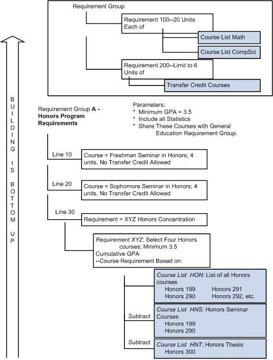

This diagram expresses the degree requirements (from the Part 1 diagram) using academic advisement concepts of course lists, requirements, and requirement groups.
Image: Traditional approach to academic advisement concepts (Part 2)
