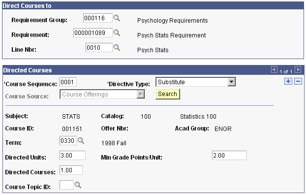

Access the Exception Detail page (click the Create Exception link on the Authorize Student Exceptions page).
Image: Exception Detail page
This example illustrates the fields and controls on the Exception Detail page. You can find definitions for the fields and controls later on this page.
Enter the specific items that you want to override and change. Based on the information entered on the Authorize Student Exceptions page, only relevant fields appear on this page. For example, if, on the Authorize Student Exceptions page, you select the operation code Requirement Waiver and enter a level of LN (requirement line), then you must enter a requirement group, academic requirement, and requirement line. That is, you must tell the system what requirement line you want to change.
In addition, the system filters prompt values based on the information that you entered on the Authorize Student Exceptions page. For example, if, on the Authorize Student Exceptions page, you enter values for academic institution, academic career, academic program, and academic plan, then you prompt only on those requirement groups defined at the academic plan level. That is, you prompt only on requirement groups whose academic structure matches that entered on the Authorize Student Exceptions page.
Directed Courses
This group box may not contain any fields, depending on the information that you entered on previous pages.
When you select the Course Directive operation code on the Authorize Student Exceptions page, the system displays a number of fields in this group box.
Directed Courses
Field or Control
Definition
Directive Type
Select the directive type. Values are:
Substitute: Select to replace one course for another.
Exclude: Select to exclude courses from being used in the degree audit. The information that you enter on the Exception Detail page dictates which courses are excluded.
Course Source
Select the value that represents the courses from which to select the substitution. Values are:
Offerings: Indicates all courses for the institution. From the institutions offerings, you can then select a specific course ID, subject, catalog number, and course offering. This value is the default.
When the selection code on the Authorize Student Exceptions page is Primary Academic Plan, Academic Program, or Student Group, then Offering is the only available course source.
Enrollment, Other Credit, Test Credit,and Transfer Courses: Indicate that the courses from which to choose are based on the student's transcript. They are courses in which the student enrolled, or posted to a transfer, test, or other credit model.
These four options are only available when the selection code on the Authorize Student Exceptions page is Student.
Search
Click to access the Student Course Directive Search page, where you enter a subject area. (If you do not know the subject area, you can use the prompt to look up the subject area.) Click the button again to access the Course Selection page, where you can select from among the courses listed.
Using the search feature, you can find and select a particular course ID, offering number, class number, and section number for regularly enrolled courses, and a model, group, and sequence number for transfer, test, and other credit. Unit earned, grades, and requirement designation values are also noted in the search record.
Note: When the course source is Offerings, you must enter a subject area before clicking the Search button on the Student Course Directive Search page. However, when the course source is another value, you do not need to enter a subject area. Instead, click the Search button and the system will return a list of courses from the student's enrollment or transfer records.
Term
Enter a term value to indicate that the directive applies only when the student takes the course in the specified term. This field is only available when the course source is Offerings.
Directed Units
Enter the number of units you want used in the audit. A value in this field is optional.
Directed Courses
Enter the number of courses you want used in the audit. A value in this field is optional.
Course Topic ID
Enter a course topic ID to further define a specific course to be used in the exception. When the course source is Offerings, you can enter a value in this field to ensure that the directive will apply only if the student takes the course with this topic ID. This field is not available when the course source is Othr Cred, Test Cred, or Transfer. A value in this field is optional.
