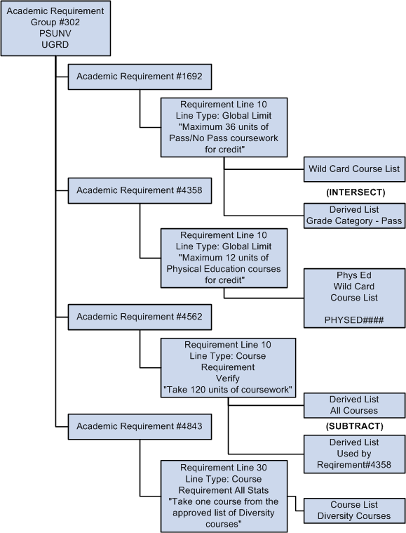

The following diagram displays an overview of how to set up a global sequential restriction requirement.
Image: Global sequential restriction requirement structure
The diagram illustrates how to set up a global sequential restriction requirement.
