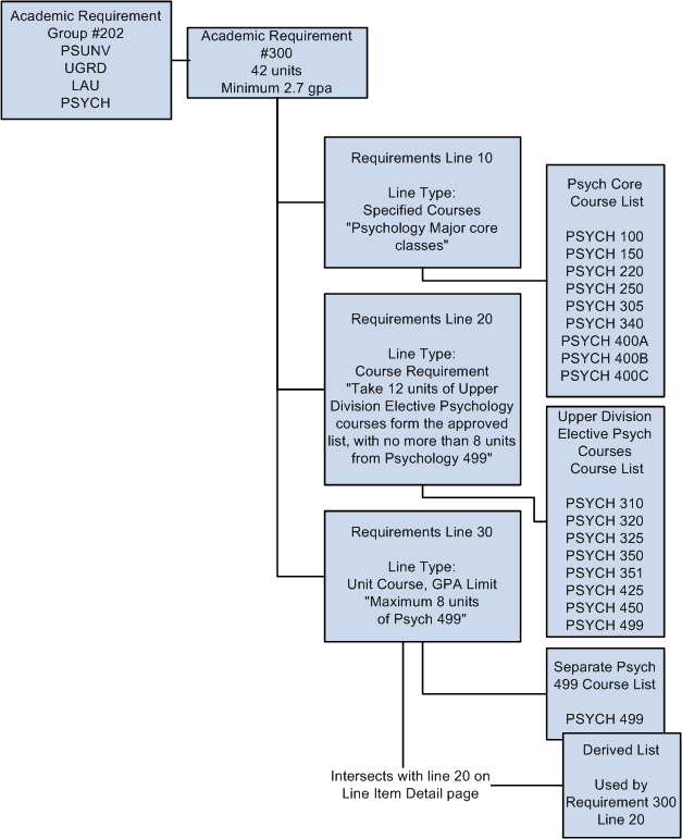

  6. To target the course limit to a requirement, intersect the course list for the limit line with a derived list that specifies the target in greater detail. For example, if the requirement has multiple requirement lines, and you want the maximum 8 units of Psychology 499 requirement to apply only to one of many lines in the requirement:
    1. On the Line Item Detail page, insert a second Line Detail Type of DLST. Select a List Include Mode of I — Intersection With. Select a List Recall Mode of Used by Requirement, and specify the requirement and line number that you specifically want to limit.

The following diagram displays an overview of how to set up a local unit, course, or GPA limit requirement:
Image: Unit, course, or GPA limit structure
The diagram illustrates how to set up a local unit, course, or GPA limit requirement.
Unit, course, or GPA (grade point average) limit structure
