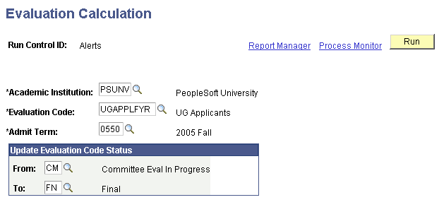

Access the Evaluation Calculation page (Student Admissions > Processing Applications > Evaluations > Evaluation Calculation).
Image: Evaluation Calculation page
This example illustrates the fields and controls on the Evaluation Calculation page. You can find definitions for the fields and controls later on this page.

Evaluation Code
Select an evaluation code. The process only evaluates applications that have been assigned the evaluation code you select. Define evaluation codes on the Evaluation Table page.
Admit Term
Enter an admit term. The process only evaluates applications that have the admit term you select. Define admit terms on the Term Values Table page.
Institution
Enter an institution. The process only evaluates applications for this institution.
From
The process only evaluates applications that have the evaluation status you select. This is the evaluation status listed on the Application Evaluation page.
To
Enter the evaluation status that you want the process to add to the application evaluations.
Click the Run button to run the Assign Adm Applicant Rating (assign admissions applicant rating) process at user-defined intervals.
