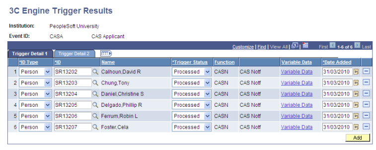

Access the 3C Engine Trigger Results page (Campus Community > 3C Engine > 3C Engine Trigger Results).
Use the 3C Engine Trigger Results page to review records that the Import CAS Details process or the Create Extract - update process creates.
Use the page to add any additional records required. Select Variable Data to add the required values for any additional records added.
Image: 3C Engine Trigger Results page for CASA
This example shows the 3C Engine Trigger Results page for CAS Number notification.

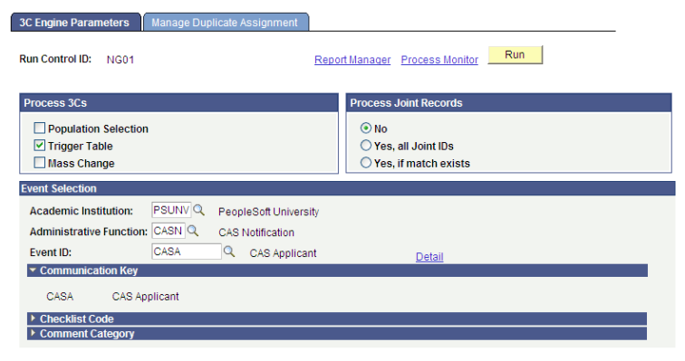

Access the 3C Engine Parameters page (Campus Community > 3C Engine > Run 3C Engine).
Image: 3C Engine Parameters page
This example illustrates the fields and controls on the 3C Engine Parameters page.
Run the 3C Engine process for each of the Event IDs defined on the PBI Configuration page. The process assigns communications, comments and checklists associated with the Event ID to the ID of the applicant or student.

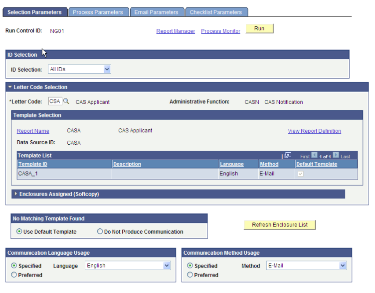

Access the Selection Parameters page (Campus Community > Communications > Communication Generation).
Run the Communication Generation process for each standard letter code to generate the communications for the assigned communications.
Image: Selection Parameters page
The following example shows that the Communication Method is set to E-Mail. Note that the ID Selection value should be set to All Person IDs rather than All IDs as shown on the example.

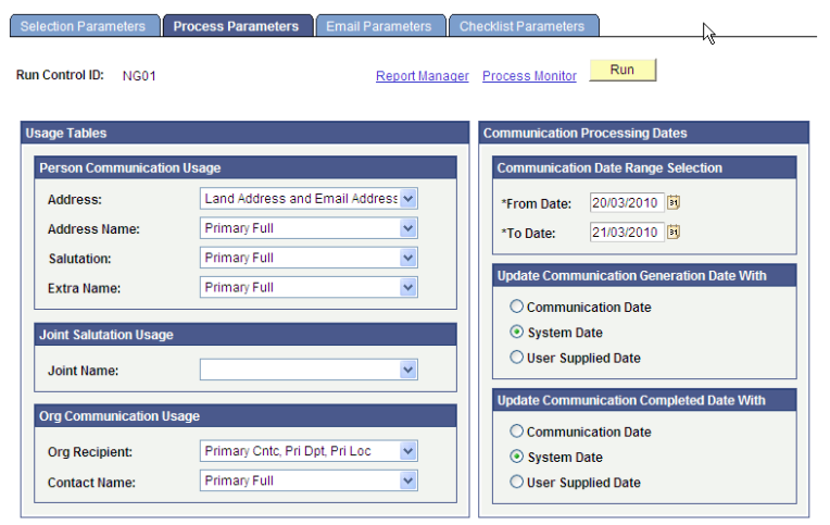

Define the Person Communication Usage values on the Process Parameters page.
Image: Process Parameters page (1 of 2)
This example illustrates the fields and controls on the Process Parameters page (1 of 2).
