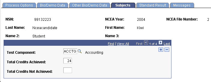

Subjects
SAD_NCEA_SPSUB_NZL
Student Admissions > Processing Admissions NZL > NCEA Suspense > Subjects
Review and edit the student's loaded subject data.

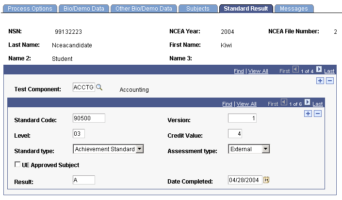

Standard Result
SAD_NCEA_SPSTD_NZL
Student Admissions > Processing Admissions NZL > NCEA Suspense > Standard Result
Review and edit the student's loaded standard result record.

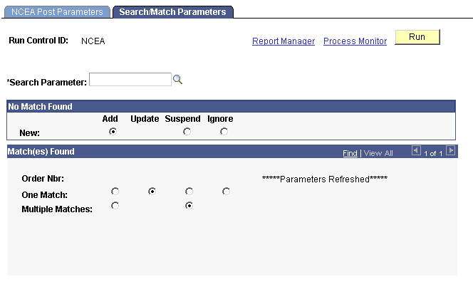

Search/Match Parameters
SEARCH_PARMS
Student Admissions > Processing Admissions NZL > NCEA Search/Match/Post > Search/Match Parameters
Define your search/match parameters. These are the rules that determine what the post process should do with the suspense record after the search/match process is complete.

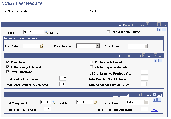

NCEA Test Results
SAD_NCEA_TERES_NZL
Student Admissions > Processing Admissions NZL > NCEA Test Results > NCEA Test Results
View a student's posted NCEA test data.

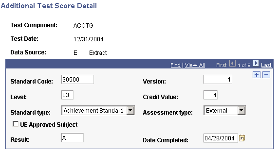

Additional Test Score Detail
SAD_NCEA_TSTSC_SEC
Click the Details button on the NCEA Test Result page.
Review additional information about a test component.

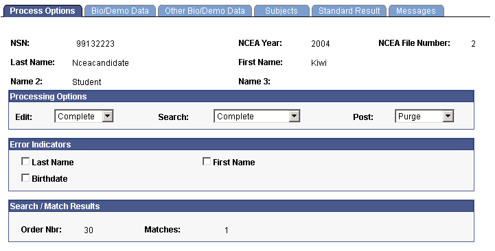

Access the Process Options page (Student Admissions > Processing Admissions NZL > NCEA Suspense > Process Options).
Image: Process Options page
This example illustrates the fields and controls on the Process Options page. You can find definitions for the fields and controls later on this page.
This page provides the status of a suspense record regarding the loading process. Any informational and error indicators that NCEA data load processes generate appear on this page. You can use this page to keep current on the status of an individual's NCEA processing.
Processing Options
Field or Control
Definition
Edit
Displays the status of the load process for this suspense record. The load process populates this value.
  • Complete: The load process loaded the data without a problem. This record is ready to be posted.
  • Error: The load process encountered problems when loading the data.
    The system indicates the values that you must correct in the Error Indicators group box. Correct all errors and save the data before running the search/match/post process on this record. After you correct the errors and save the component, the system changes the field value to Complete.
  • Perform: You set this value manually.
    This is for informational purposes only.
Search
Displays the status of the search/match process for this suspense record. The search/match process populates this value.
  • Complete: The search/match process completed successfully.
  • Error: The search/match process encountered problems.
    Refer to the log file for information regarding the error.
  • Perform: The search/match process will process this record the next time you run the process.
Post
Displays the status of the record regarding the search/match/post process. These values can be entered manually; however, some are entered by the system after processes are run as described in the table below. If the process updated an existing person's record, the process displays the ID that was updated in the ID field on the Bio/Demo page.
Post Value
Meaning
How Set
Delete Update ID
Not used with NCEA.
Not used with NCEA.
Error
The posting process encountered a problem.
Set by the system during the search/match/post process.
New ID Add
Not used with NCEA.
Not used with NCEA.
No Action
Search/match/post and purge suspense file processes will ignore the record if this value is entered.
Set manually.
Purge
Indicates that this suspense record will be removed from the system during the purge suspense file process.
Set by the system during the search/match/post process if the record was successfully processed.
Update ID
The search/match/post process found a matching ID in the database. The process will update the matching records with the data from this suspense record.
When set manually, means that the process identified a match and the user determined manually that duplication exists. The system makes available the ID field on the Personal Information page. Select the ID that you want the search/match/post process to update. You must save the page and run the search/match/post process to update the record.
Set by the system during the search/match process if a match was found in the database and if your search parameters define that an update should occur in this situation (only when you run search/match and post and different times).
Set manually.
Wait Srch
This record is in the suspense file and is waiting to be processed by the search/match/post process.
Set by the system during the load external data process.
Note: While you can manually edit the values in the Edit, Search and Post fields, keep in mind that if a field contains Error and you manually change it without correcting an error, you may experience problems when posting the data.
Error Indicators
Field or Control
Definition
Last Name, First Name, and Birthdate
When a load error occurs, the load external data process displays the required values that were missing or incorrect in the load. Go to the Bio/Demo Data page or another page in the NCEA Suspense component where the missing or incorrect data resides to enter a valid value. When you correct the error the system clears the check box and the fields will no longer appear. After all of the check boxes are cleared and the component is saved, the system enters Complete in the Edit field.
Search/Match Results
Field or Control
Definition
Order Nbr (order number)
You know that the search/match process found a match and did not post the suspense record when the Search field contains Perform and displays the search order number that led to the match in the Order Nbr field. Use this information to decide whether or not a possible duplicate exists.
Matches
Displays the number of matches that the process found at order number given.

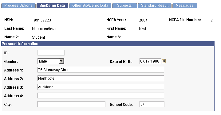

Access the Bio/Demo Data page (Student Admissions > Processing Admissions NZL > NCEA Suspense > Bio/Demo Data).
Image: Bio/Demo Data page
This example illustrates the fields and controls on the Bio/Demo Data page.
Bio/Demo (biographical/demographic) Data page
Review and edit the student's personal information in the suspense record.

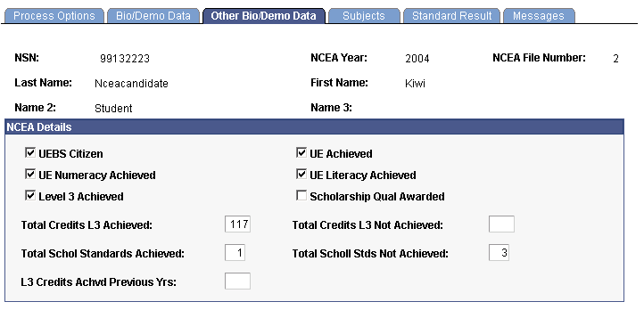

Access the Other Bio/Demo Data page (Student Admissions > Processing Admissions NZL > NCEA Suspense > Other Bio/Demo Data).
Image: Other Bio/Demo Data page
This example illustrates the fields and controls on the Other Bio/Demo Data page.
Other Bio/Demo (biographical/demographic) Data page
Review and edit additional personal information in the suspense record.
Access the Subjects page (Student Admissions > Processing Admissions NZL > NCEA Suspense > Subjects).
Image: Subjects page
This example illustrates the fields and controls on the Subjects page.
Subjects page
Review and edit NCEA subject information in the suspense record. Each component has its own row and details.
Access the Standard Result page (Student Admissions > Processing Admissions NZL > NCEA Suspense > Standard Result).
Image: Standard Result page
This example illustrates the fields and controls on the Standard Result page.
Review and edit NCEA standard result file information in the suspense record. Each component has its own row and corresponding detail rows.

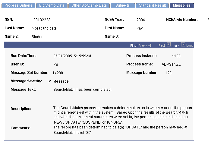

Access the Messages page (Student Admissions > Processing Admissions NZL > NCEA Suspense > Messages).
Image: Messages page
This example illustrates the fields and controls on the Messages page.
Messages page
Any messages that the NCEA load process generates appear on this page. Use this page to find the most current information on the status of an individual's NCEA data processing. These messages can serve historical and analytical purposes, giving you a picture of the kinds of errors encountered in your processing. Therefore, you should purge your NCEA messages only after you have completed your analysis.

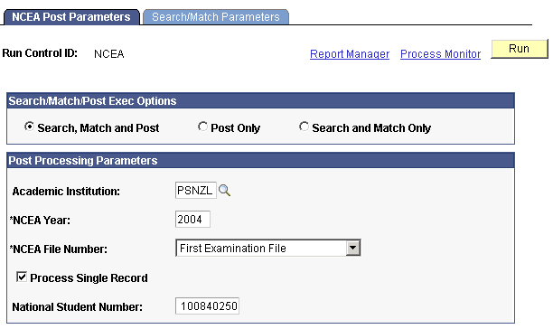

Access the NCEA Post Parameters page (Student Admissions > Processing Admissions NZL > NCEA Search/Match/Post > NCEA Post Parameters).
Image: NCEA Post Parameters page
This example illustrates the fields and controls on the NCEA Post Parameters page. You can find definitions for the fields and controls later on this page.
NCEA (National Certificate of Educational Achievement) Post Parameters page
Search/Match/Post Exec Options
Field or Control
Definition
Search, Match and Post
Select this option if you want the process to search your database for records that match the suspense record and post the suspense data to your database. This is the recommended option.
Post Only
Select this option if you only want to post the suspense data to your database (if you select this option, you must have already run search/match or manually changed the Search and Post process options on the External Test Score Suspense page).
Search and Match Only
Select this option if you only want to run the search and match process on the suspense file. You will need to post the data at a later time.
Post Processing Parameters
Field or Control
Definition
Academic Institution
Enter the institution for which you want to post NCEA suspense data.
NCEA Year
Enter the year of the NCEA examination.
NCEA File Number
Specify the examination file you want to post. Values are:
  • First Examination File
  • Second Examination File
  • Third Examination File
NCEA file number values are delivered with your system as translate values and you should not modify them.
Process Single Record
Select this check box if you want to run the search/match/post process for a single suspense record. The National Student Number field becomes available.
The national student number for the single record you want to process. This field applies only if you have selected the Process Single Record check box.
Access the Search/Match Parameters page (Student Admissions > Processing Admissions NZL > NCEA Search/Match/Post > Search/Match Parameters).
Image: Search/Match Parameters page
This example illustrates the fields and controls on the Search/Match Parameters page.
Use this page to set up your search/match parameters. These are the rules that determine what the post process should do with the suspense record after the search/match process is complete.
Access the NCEA Test Results page (Student Admissions > Processing Admissions NZL > NCEA Test Results > NCEA Test Results).
Image: NCEA Test Results page
This example illustrates the fields and controls on the NCEA Test Results page.
NCEA (National Certificate of Educational Achievement) Test Results page
Use this page to review a student's loaded NCEA test score data.
Access the Additional Test Score Detail page (Click the Details button on the NCEA Test Result page).
Image: Additional Test Score Detail page
This example illustrates the fields and controls on the Additional Test Score Detail page.
Review additional information about an NCEA test component.
