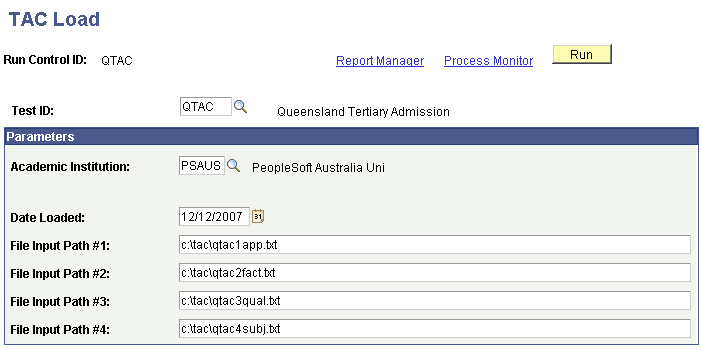

Access the TAC Load page (Student Admissions > TAC Processing > TAC Load).
Image: TAC Load page
This example illustrates the fields and controls on the TAC Load page. You can find definitions for the fields and controls later on this page.
TAC (Tertiary Admissions Centre) Load page
The number of input files that you can use depends on the TAC test ID that you enter. For example, the TAC Load page displays five file input fields for UAC and thirteen file input fields for SATAC.

Field or Control
Definition
Test ID
Enter the TAC test ID that you want to load. Define TAC test ID values on the Test Tables page. Once the TAC test ID is entered, the additional fields specific to the TAC will appear. You must have test ID security established in order to select a value. This field is required.
Academic Institution
Enter the institution for which you want to load the data.
Admit Type
Applicable to only SATAC and VTAC.
Enter a value only if applicants do not have an admission offer (basis of admission).
Date Loaded
Enter the date of the data load process. The system populates this field to the current date by default.
Processing Indicator
Applicable to only VTAC.
Select a value applicable to the offer file that you want to load. You must select Undergrad for an undergraduate offer file and Graduate for an offer file that contains postgraduate applicant records.
Initial Course Character
Applicable to only SATAC.
Use to filter and load preferences relevant to your institution. The TAC Load process selects only those courses from the preferences file that commence with the character that you enter in this field.
Offers
Select to load only those courses from the preferences file that TAC has offered to the applicants
If you do not select this check box, the TAC Load process loads all the preferences depending on the Initial Course Character value.
File Input Path
Enter the path of the directory and file where the TAC data resides. These fields are required. How you complete the fields depends on the TAC you are processing. In order for the upload to work correctly, you must list the input files in the correct order.
Run
Click the run button to run the SAD_TAC_LOAD Application Engine process at user-defined intervals.
Note: To check for errors during the program run, review the trace file created by the Application Engine program. Nonfatal errors will appear in the Error Indicators group box in the TAC Suspense component.
