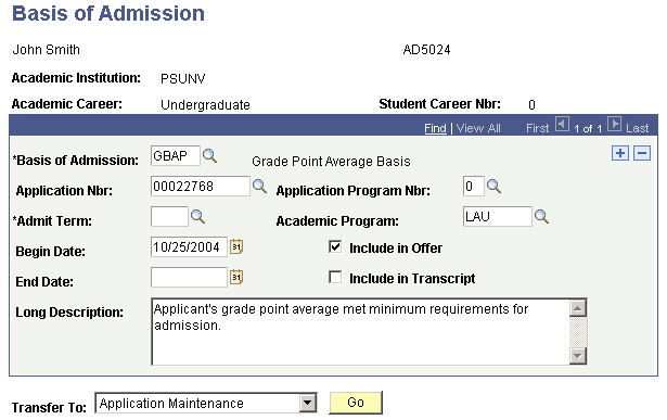

Access the Basis of Admission page (Records and Enrollment > Career and Program Information > Basis of Admission).
Image: Basis of Admission page
This example illustrates the fields and controls on the Basis of Admission page. You can find definitions for the fields and controls later on this page.
Field or Control
Definition
Basis of Admission
Enter a basis of admission code from the list of valid values. Define basis of admission codes on the Basis of Admission page.
Application Nbr (application number)
Enter an application number to assign the basis of admission to a specific application. (optional)
Application Program Nbr (application program number)
Enter an application program number to assign the basis of admission to a specific program. (optional)
Admit Term
Enter the individual's admit term. If an individual was admitted to more than one academic program, he or she could have multiple admit terms.
Academic Program
Enter the individual's academic program to which you want to apply the basis of admission. Individuals can be admitted to multiple academic programs. (optional)
Begin Date
The default for the begin date is your system date.
End Date
Enter the date that you want this basis admission to be no longer valid. If you run the offer letter or transcript after this date it will not appear even if you have selected the Include in Offer check box.
Include in Offer
Select this check box to include the code, description, short description, and long description on the applicant's admission offer letter. The system automatically selects this check box if the Include in Offer field on the Basis of Admission setup page is selected for the given basis of admission. You can change the setting for this applicant here.
Include In Transcript
Select this check box to include the code and long description on the student's transcript. The system automatically selects this check box if the Include in Transcript field on the Basis of Admission setup page is selected for the given basis of admission. You can change the setting for this person here.
Long Description
The long description appears from the Basis of Admission setup page. You can change the long description for this person here.
The long description should clearly state the basis for admission. For example, you could say, "The applicant's composite SAT score exceeded the minimum required for admission to the program." You can have another code that represents grade point average, and another that represents letters of referral, for example. Thus, if you admitted a person based on his or her SAT score, grade point average, and letters of referral, you could assign all three bases of admission codes to the person.
