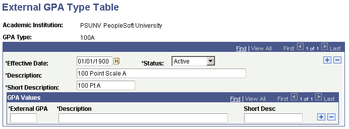

Access the External GPA Type Table page (Set Up SACR > Common Definitions > External Education > External GPA Type Table).
Image: External GPA Type Table page
This example illustrates the fields and controls on the External GPA Type Table page. You can find definitions for the fields and controls later on this page.
External GPA (grade point average) Type Table page
Defining the External GPAs
If the outside GPA type has a name that is not descriptive or self-evident, you can use the GPA values portion of this page to more clearly define the external GPAs that belong to this GPA type. You do not need to fill in External GPA and Description fields if it is clear from the GPA type name exactly what it means.
Field or Control
Definition
External GPA
Enter the external GPA value for each GPA value.
Short Description
Enter a short description–up to 15 characters–for each GPA value.

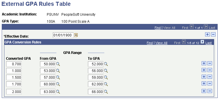

Access the External GPA Rules Table page (Set Up SACR > Common Definitions > External Education > External GPA Rules Table).
Image: External GPA Rules Table page
This example illustrates the fields and controls on the External GPA Rules Table page. You can find definitions for the fields and controls later on this page.
External GPA (grade point average) Rules Table page
Field or Control
Definition
Effective Date
Enter an effective date for this GPA rule. If the effective date is equal to or greater than the effective date for this GPA type, then this GPA rule is active.
Converted GPA
Enter the converted GPA that applies to the range entered in the From GPA and To GPA fields.
From GPA and To GPA
You can enter any numeric value in these fields. If you defined GPA values (on the GPA Type Table page) for this GPA type, you can prompt for those values, but you can also enter values that are not defined. You can add as many converted GPAs as required for a GPA type.
