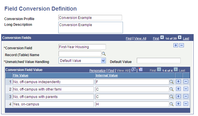

Use the Field Conversion Definition page to define field values in the external file that must be converted to internal values. Add any additional fields and complete the definition for the fields delivered.

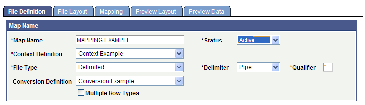

Use the File Definition page to provide information about the external file.

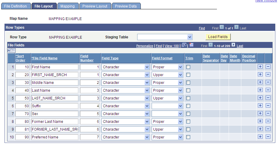

Use the File Layout page to define fields from the external file that will be loaded into the staging tables.

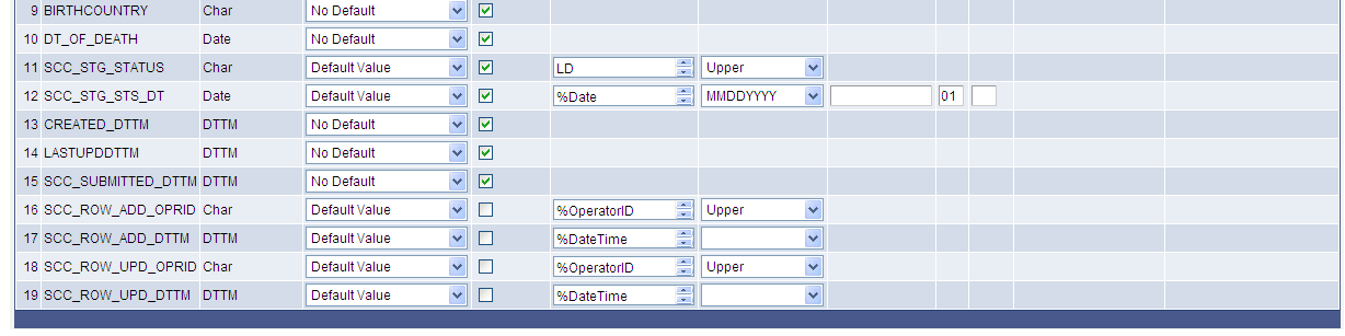

Use the Mapping page to associate fields defined on the File Layout page with staging table fields defined in the context definition.
Image: Example of a mapping
This example illustrates the Mapping page.
There could be required description fields that may require a calculated field to populate. File Parser does not populate the description based on the code populated. You must build a calculated field to load a description. Examples of required description fields:
  • Academic Interests - SCC_STG_ADMINT. DESCR
  • Extracurricular Activities - SCC_STG_EXTRACU.DESCR
  • External Degrees - SCC_STG_EXTDEGR.DESCR
SAD_APL_PRG_STG.APPL_PROG_NBR: To have the system automatically set the Application Program Number to zero (which is the default when adding a new application), set the Mapping Action for this field to a Default Value of 0. If you are inserting multiple program rows for one application number, set the second occurrence of this field to a Default Value of 1.

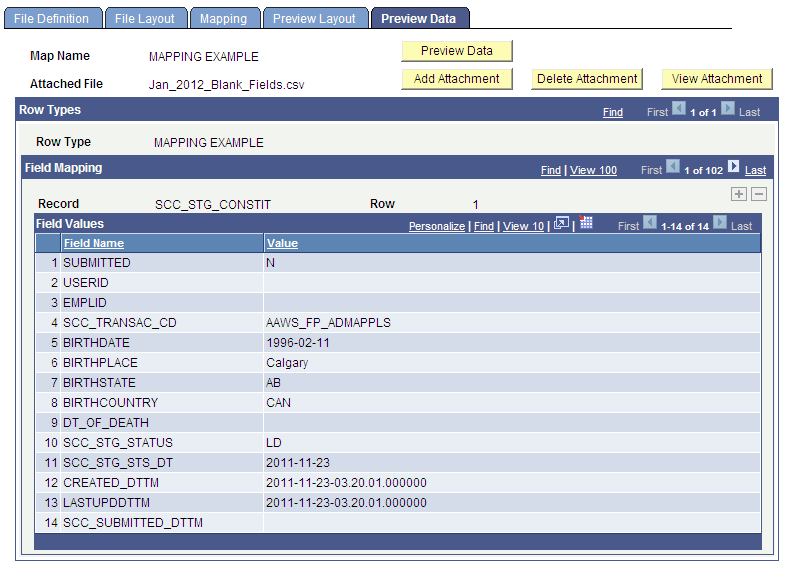

Use the Preview Data page to test your external file with the File Parser Definitions.
Note: The preview feature shows only the first row of each row type; therefore, you should use a small test file when using this component. Using a large test file is simply a waste of resources that could potentially degrade the application server.
