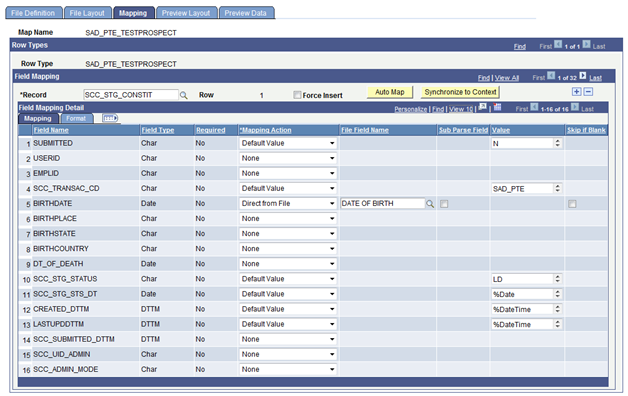

Make sure you enter a row for the required constituent (CTM) and Prospect/Admissions staging records on the Context Definition page and the Mapping page of the File Mapping Definition component:
Required for all PDL transactions:
  • SCC_STG_CONSTIT. Should be the first record. It is required to set the following fields, even though they are not necessarily required in the record:
    • SUBMITTED - Default to N.
    • SCC_TRANSAC_CD - Default according to transaction setup.
    • SCC_STG_STATUS - Default to LD (Loaded).
    • SCC_STG_STATUS_DT - Default to %Date.
  • SCC_SL_TRNMAP (Select the Force Insert check box.)
  • SCC_STG_NAMES
  • SCC_STG_PDE (Select the Force Insert check box if no incoming fields are mapped.)
  • SCC_STG_PERSSA (Select the Force Insert check box if no incoming fields are mapped.)

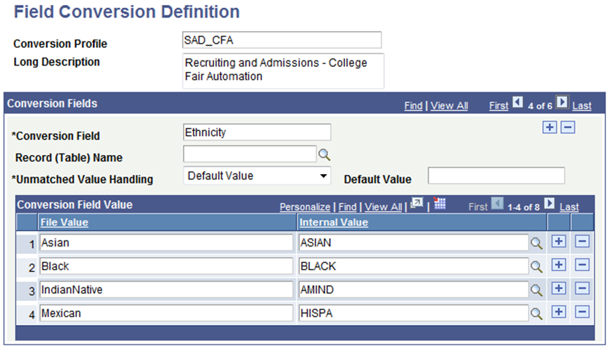

Use the Field Conversion Definition page to define field values in the external file that must be converted to internal values. Add any additional fields and complete the definition for the fields delivered.

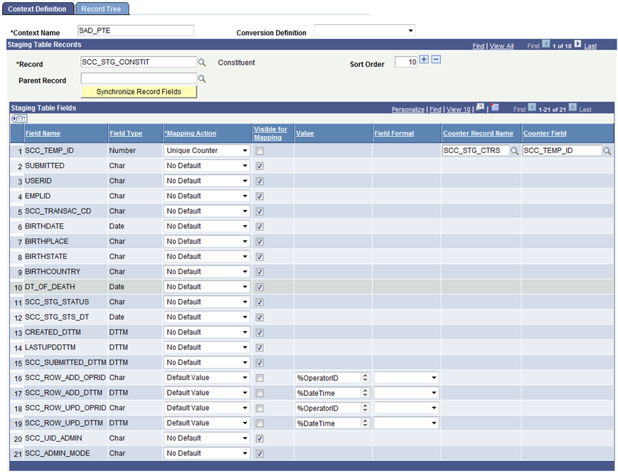

Use the Context Definition page to add the staging tables that need to be updated when loading data from the external file. Ensure that you enter the correct value for the Parent Record field. For Prospect/Admissions Data Load transactions, SCC_STG_CONSTIT must be the first record entered as it is the parent to all records.

For Prospect/Admissions Data transactions, you must include the following unique counter on the record SCC_STG_CONSTIT: SCC_TEMP_ID: SCC_STG_CTRS.SCC_TEMP_ID.

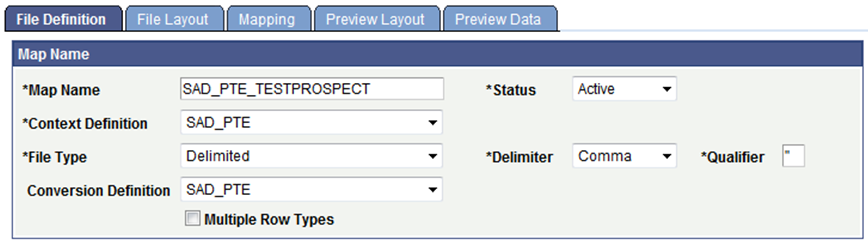

Use the File Definition page to provide information about the external file.

Important! Changing the value in the Context Definition field will delete any existing setup on both the File Layout and Mapping tabs. Do not change this value unless you want to start over with any setup you have completed.

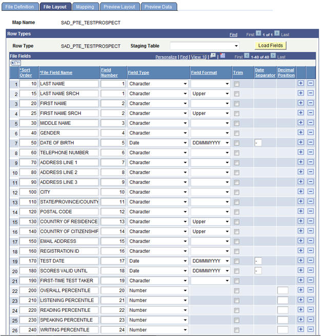

Use the File Layout page to define fields from the external file that will be loaded into the staging tables. The fields should be entered in the exact order of the file layout you are loading. In addition, the Field Type setting needs to be set to the same field type as that of the field you will be mapping it to. Set field formats as needed for date fields and character fields.
Image: Example of a file layout
This image shows an example of a file layout.
Use the Mapping page to associate fields defined on the File Layout page with staging table fields defined in the context definition.
Image: Example of a file mapping
This image shows an example of a file mapping.
For Prospect/Admissions data loads, the first record should always be SCC_STG_CONSTIT and the second record should be SCC_SL_TRNMAP. Enter rows for other staging records you want to populate in the proper parent-child relationship order.

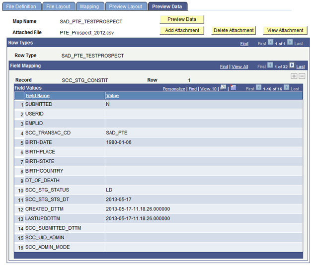

Use the Preview Data page to test your external file with the file parser definitions.
Note: The preview feature shows only the first row of each row type; therefore, you should use a small test file when using this component. Using a large test file is simply a waste of resources that could potentially degrade the application server.

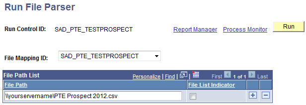

Run the File Parser process to load the prospect/admissions data from a text file into the staging tables. Each record is loaded as a PDL transaction based on the default transaction code defaulted on SCC_STG_CONSTIT and SAD_PDL_HDR_STG on the Mapping page.
Use the Run File Parser page to run the File Parser process.
