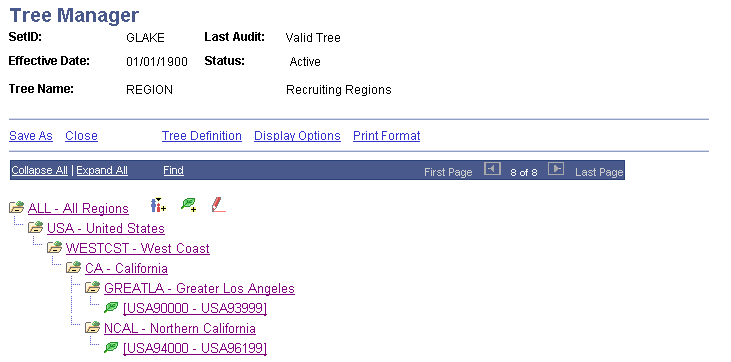

Defining a Region Tree for Recruiting and Admissions
You base your region tree on a special tree structure, shipped with Recruiting and Admissions, called REGION. This structure uses the country and postal code of either the applicant's school or the applicant's home address as detail nodes of the tree and the structure looks to the regions stored in the region table for all other tree nodes.
To set up your region tree, select Tree Manager > Tree Manager. Search for a Tree Name of REGION. Select a delivered REGION tree. Then select the Save As link on the page.
The Tree Definition dialog box opens. The following values should appear:
  • The tree name is REGION.
  • The status is Active.
  • The structure ID is REGION.
    Note: Your region tree must be based on the REGION structure that is provided with your system. Your system relies on this structure when matching recruiters to prospects and applicants.
  • The All Detail Values in This Tree check box is cleared.
  • The Allow Duplicate Detail Values check box is cleared.
  • The Strictly Enforced option is selected.
  • Enter your institution's setID and an effective date. When you click Save As, you return to the PeopleSoft Tree Manager page, with the name of your region tree. The name of your region tree is the setID plus the effective date.
Delivered Region Tree Examples
Recruiting and Admissions comes with three sample region trees that you can view to get an idea of a finished region tree. Each one is named REGION; they are listed, in order, under the following setIDs:
  • PSCCS
  • GLAKE
  • PSUNV
Image: PeopleSoft Tree Manager displaying part of the sample GLAKE region tree
This is an example of part of the delivered GLAKE region tree.
See product documentation for PeopleTools: Tree Manager
After you create a region tree or update an existing tree with a new effective date, you must activate it by running the Region SetID Effdt Update process.
Note: Region trees do not work unless you run this process.

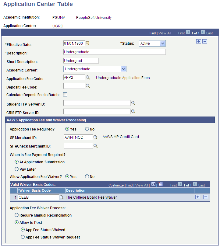

Access the Application Center Table page (Set Up SACR > Product Related > Recruiting and Admissions > Applicants > Application Center Table).
Image: Application Center Table page
This example illustrates the fields and controls on the Application Center Table page. You can find definitions for the fields and controls later on this page.
Note: You assign applications and link recruiters to application centers. This helps you to identify the applications and recruiters who belong to a particular admissions office.
Application centers are where admissions applications are processed. By defining application centers, you can track which office is handling a specific application. This is especially useful if you have decentralized processing for academic careers.
Field or Control
Definition
Academic Career
Select an academic career if this application center is for only one academic career. If you want this application center available to all careers, leave this field blank. Define academic careers on the Academic Career Table page.
Application Fee Code
Select the appropriate application fee code for this application center. Define application fee codes on the Application Fees page in PeopleSoft Student Financials. If you do not charge an application fee, you can leave this field blank.
Deposit Fee Code
Select the appropriate deposit fee code used for this application center. Define deposit fee codes on the Deposit Fees page in Student Financials. If you do not charge deposits, you can leave this field blank.
Calculate Deposit Fee in Batch
Select if you want to allow users to save applications without calculating a deposit fee. When you enter a status of Admitted on the Application Program Data page, the system does not prompt you to calculate the deposit. Rather, you use the Deposit Fees Calc (deposit fees calculation) batch process (SFPBADEP) to calculate the deposit fee. This enables you to automate the deposit fee calculation process.
If you clear this check box, the system does prompt you to calculate a deposit fee when you enter a status of Admitted on the Application Program Data page.
AAWS Application Fee and Waiver Processing
AAWS application fee processing uses staging data in the Application Transactions component.
Use this group box to set up the options for AAWS application fee and waiver processing.
Field or Control
Definition
SF Merchant ID and SF eCheck Merchant ID
Select a SF Merchant ID (for credit card) or a SF eCheck Merchant ID or both for AAWS fee processing. Based on this setup, during the AAWS fee calculation and payment process, a List of Values web service determines which payment methods are available to an applicant on the external User Interface site.
A merchant ID is a user-defined element that defines the rules for interfacing with a third party payment processor. Define Student Financials merchant IDs on the SF Merchants page (Set Up SACR, Common Definitions, Self Service, Student Financials, SF Merchants).
See Setting Up SF Merchants.
When is Fee Payment Required
If you select Pay Later, the payment processing must be handled outside of AAWS processing. The online application can be submitted and be posted to the core production Application Maintenance component but your institution must follow up with the applicant and process the payment outside of AAWS processing.
Allow Application Fee Waiver
If you select Yes, the Valid Waiver Basis Codes group box and Application Fee Waiver Process fields become available.
You can select from waiver basis codes that have been set up on the Application Fee Waiver Basis page (Set Up SACR, Product Related, Recruiting and Admissions, Applicants, Application Fee Waiver Basis).
  • If you select Require Manual Reconciliation, an administrator must approve or deny the waiver in the Application Transactions staging component before the application can be posted to core production.
  • If you select Allow to Post, the application can be posted to core production and the administrator assesses the waiver request in the Application Maintenance component.
    If your school allows waivers but automatically grants the waiver without review or assessment, you can select App Fee Status Waived as the Allow to Post option. When the application is posted, the Fee Status field value in Application Maintenance is set to Waived.
    If your school requires waiver requests to be assessed, select App Fee Status Waiver Request as the Allow to Post option. When the application is posted, the Fee Status field value in Application Maintenance is set to Waiver.

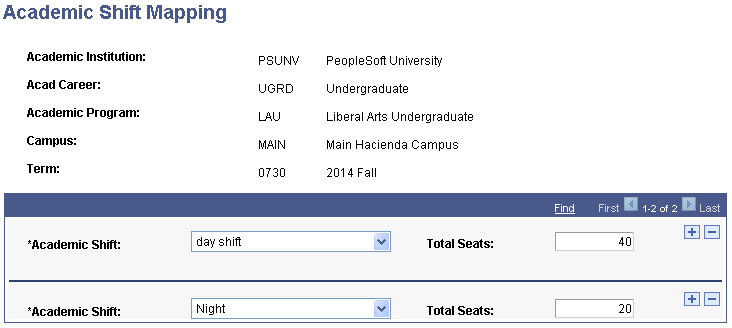

Access the Academic Shift Mapping page (Set Up SACR > Product Related > Recruiting and Admissions > Applicants > Academic Shift Mapping).
Image: Academic Shift Mapping page
This example illustrates the fields and controls on the Academic Shift Mapping page. You can find definitions for the fields and controls later on this page.
Use this page to map academic shifts to admit terms.
If the Use Shift by Admit Term check box is selected on the Academic Institution 3 page, only the values defined here for the particular admit term are available in the Academic Shift field on various pages in Admissions and Student Records.
The Total Seats field is informational only.
