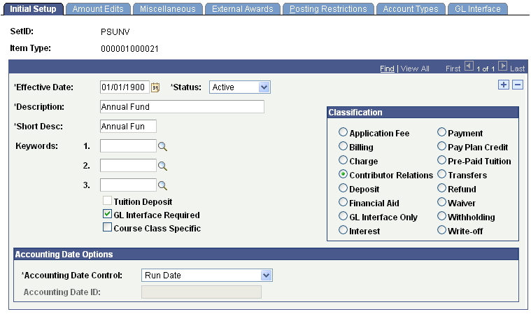

Use the Initial Setup page (ITEM_TYPE_TBL) to begin the process of setting up item types at your institution. The Initial Setup page is part of PeopleSoft Student Financials (Set Up SACR > Product Related > Student Financials > Item Types > Item Types > Initial Setup
Image: Initial Setup page
This example illustrates the fields and controls on the Initial Setup page. You can find definitions for the fields and controls later on this page.
Initial Setup page
Field or Control
Definition
G/L Interface Required
Select this check box to indicate that both a credit and debit side of each transaction are required.
Accounting Date Control
If you select the GL Interface Required check box, this field becomes active. Specify the accounting date of the item type. Select from the following values:
Run Date: Select to use the current date as the accounting date.
Item Effective Date: Select to use the applicable gift date, pledge effective date, or membership start date as the accounting date.
The Accounting Date Control value that you select affects the Journal Line Date field on the Accounting Line page (Contributor Relations > Session Management > Supervise Sessions > Accounting Line Summary) as generated by the Contributor Relations GL Interface process.
Note: For both sides of your institution's dual line accounting to be generated correctly in the GL Interface process, you must select the Accounting Date Control for both tender and designation item types on the Item Type Setup page.
Classification
Make sure the Contributor Relations classification is selected. This selection enables the specific processing of item types as required by the system and enables the GL Interface page to save with journal sets that do not have both a debit and credit.

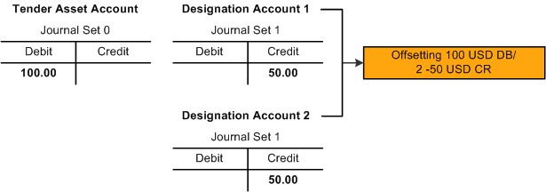

Donor makes a gift of 100 USD to two designations:
Image: Scenario 2, in which the gift results in a Tender Asset Account debit of 100.00 USD and two Designation Account credits of 50.00 USD each
This graphic illustrates Scenario 2, in which the gift results in a Tender Asset Account debit of 100.00 USD and two Designation Account credits of 50.00 USD each:

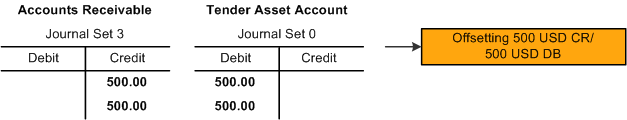

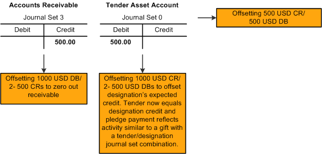

Donor makes a semiannual pledge payment of 500 USD for the previous pledge:
Image: Scenario 3 (2 of 3), in which the pledge payment results in two Accounts Receivable credits of 500.00 USD each and two Tender Asset Account debits of 500.00 USD each
This graphic illustrates Scenario 3 (2 of 3), in which the pledge payment results in two Accounts Receivable credits of 500.00 USD each and two Tender Asset Account debits of 500.00 USD each:

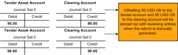

The refund amount is entered to be offset when a refund is generated manually:
Image: Scenario 4 (3 of 4), in which the offsetting 90.00 USD debit to the tender account and the 90.00 USD credit to the clearing account will be zeroed out with reversing entries when the refund is manually generated
This graphic illustrates Scenario 4 (3 of 4), in which the offsetting 90.00 USD debit to the tender account and the 90.00 USD credit to the clearing account is zeroed out with reversing entries when the refund is manually generated:
