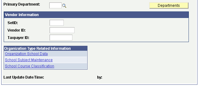

When an organization is a supplier, you can identify it as a vendor and make note of the taxpayer identification number (TIN).
When an organization is also a school or other institution that offers courses, you can identify and track the subject areas that the organization offers and the specific courses that it offers within that subject area. Maintaining subject and course data is especially valuable when evaluating transcripts from other institutions.
You can identify items that are important to your institution's academic affiliations with organizations, including their grading structure and the types of transcripts that they generate. Maintaining this information helps you convert their information into an equivalent at your institution so that you can evaluate.

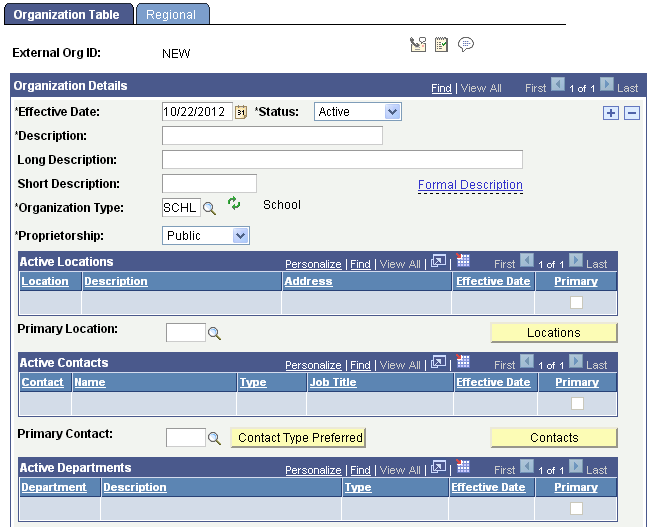

This example shows the Organization Table page when you are adding a new record for a school:
Image: Example of adding a new record on the Organization Table page (1 of 2)
This example illustrates the fields and controls on the Example of adding a new record on the Organization Table page (1 of 2). You can find definitions for the fields and controls later on this page.
Image: Example of adding a new record on the Organization Table (2 of 2)
This example illustrates the fields and controls on the Example of adding a new record on the Organization Table (2 of 2). You can find definitions for the fields and controls later on this page.

  1. Enter at least the required data (Effective Date, Status, Description, Organization Type, and Proprietorship) in the Organization Details group box on the Organization Table page to add the new record.
    Warning! If you select Save before completing the required data, you must use the Correct History mode to continue entering or modifying the effective-dated data.
  2. Select Save.
    The system assigns the next available unique organization ID to the record and adds it to your database.
