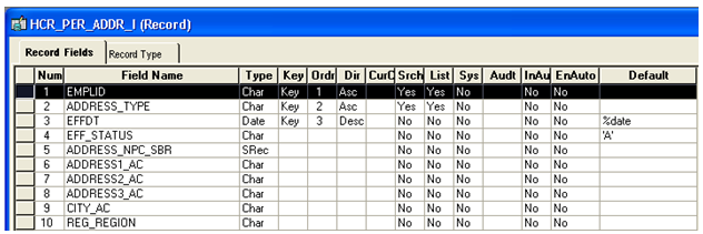

Below is an example of a delivered staging record with its matching production record that uses effective-dating:
Image: Production record definition that stores Addresses (HCR_PER_ADDR_I)
This example illustrates the fields and controls on the Production record definition that stores Addresses (HCR_PER_ADDR_I). You can find definitions for the fields and controls later on this page.

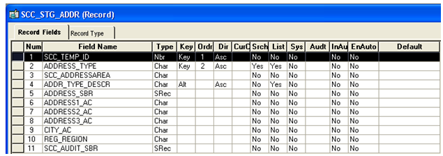

The equivalent staging record definition is defined as follows:
Image: Matching Staging record definition that stores Addresses (SCC_STG_ADDR)
This example illustrates the fields and controls on the Matching Staging record definition that stores Addresses (SCC_STG_ADDR). You can find definitions for the fields and controls later on this page.

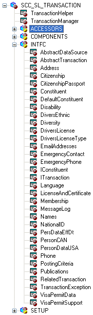

    Below is an example of the SCC_SL_TRANSACTION:INTFC application package that comprises application classes used by Constituent Transaction Management:
    Image: Example of application classes used by CTM
    This example illustrates the fields and controls on the Example of application classes used by CTM. You can find definitions for the fields and controls later on this page.
    Example of application classes used by CTM (Constituent Transaction Management)

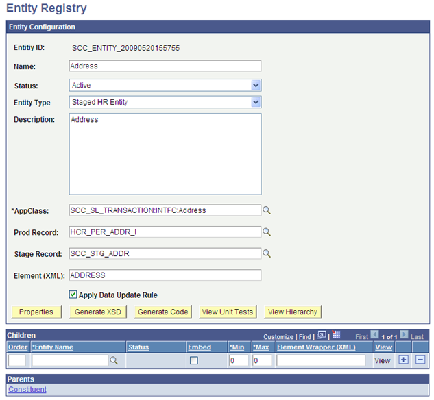

Image: Example of the entity created for Address
This example illustrates the fields and controls on the Example of the entity created for Address. You can find definitions for the fields and controls later on this page.

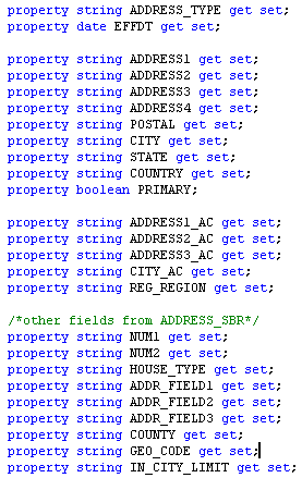

  • Any new class that you create must declare all its own immutable keys and mutable properties:
    Image: Examples of properties listed inside the SCC_SL_TRANSACTION:INTFC.Address application class
    This example illustrates the fields and controls on the Examples of properties listed inside the SCC_SL_TRANSACTION:INTFC.Address application class. You can find definitions for the fields and controls later on this page.

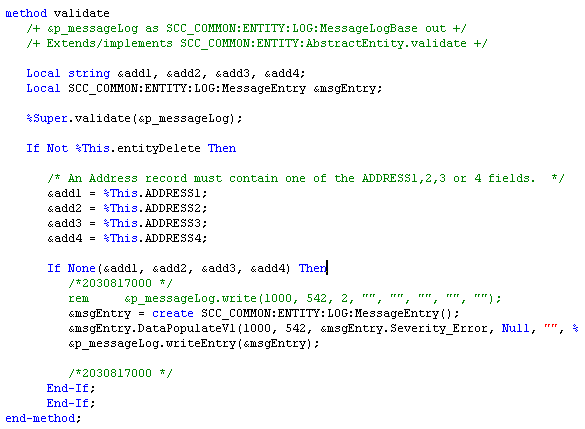

  • Any new class that you create may choose to override the validate() method in order to validate data prior to saving.
    Image: Examples of validation done inside the SCC_SL_TRANSACTION:INTFC.Address application class
    This example illustrates the fields and controls on the Examples of validation done inside the SCC_SL_TRANSACTION:INTFC.Address application class. You can find definitions for the fields and controls later on this page.

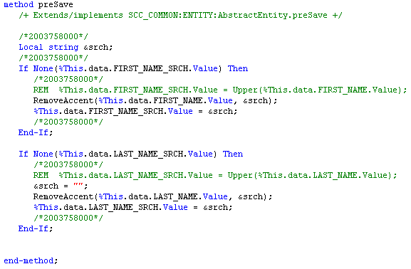

  • Any new class that you create may choose to override the preSave() method in order to default fields before the user saves the application.
    Image: Examples of presave logic done inside the SCC_SL_TRANSACTION:INTFC.Names application class
    This example illustrates the fields and controls on the Examples of presave logic done inside the SCC_SL_TRANSACTION:INTFC.Names application class. You can find definitions for the fields and controls later on this page.

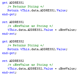

  • Any new class may declare get/set methods for its properties.
    Image: Examples of get and set inside the SCC_SL_TRANSACTION:INTFC.Address application class
    This example illustrates the fields and controls on the Examples of get and set inside the SCC_SL_TRANSACTION:INTFC.Address application class. You can find definitions for the fields and controls later on this page.

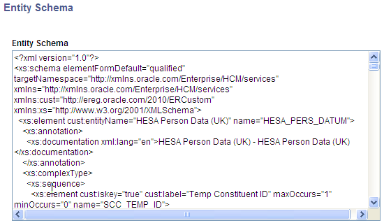

  1. Access the top level entity name referred by the messages in the service operation and select the Generate XSD action (this may not necessarily be the parent entity name. It depends on what entities are referenced by the messages on the service operation).
  2. After selecting the Generate XSD action, the entity schema is displayed:
    Image: Entity schema generated for the Constituent entity (parent entity)
    This example illustrates the fields and controls on the Entity schema generated for the Constituent entity (parent entity). You can find definitions for the fields and controls later on this page.

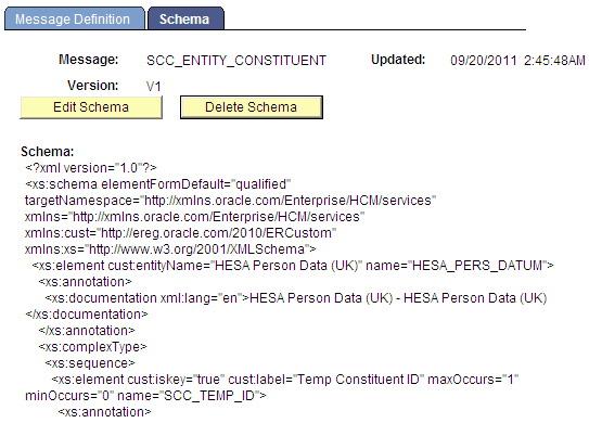

  3. Select the entire generated schema and paste it into the appropriate messages to modify the overall schema.
  4. Navigate to PeopleTools > Integration Broker > Integration Setup > Messages. Search for the relevant message. In the Schema tab, click the Edit Schema button and paste in the generated schema. Save the component.
    For example, suppose you generated the schema for the Constituent entity. Navigate to the message Schema page. Search for the message called SCC_ENTITY_CONSTITUENT. Click the Edit Schema button and paste the generated schema as shown in screen shot below.
    Image: Constituent message partial schema
    This example illustrates the fields and controls on the Constituent message partial schema. You can find definitions for the fields and controls later on this page.
    Note: The messages where you paste the schema are entity messages. These messages must be created with a message type of Part NonRowset based. This means they can be used by any Nonrowset based message. The web services created for your transaction can also refer to delivered entity messages. For example, a message with AAWS admission transaction, SAD_SUBMITAPPL_REQ message, calls both SCC_ENTITY_CONSTITUENT and SCC_ENTITY_APPLICANT message schema in its schema.

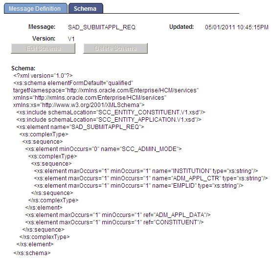

    It is easy to maintain the entity messages as their schema can be generated from the Entity Registry page. Entity messages can be reused in any request or response message as per your requirement.
    Image: Example of a web service message calling the schema of a Part NonRowset message
    This example illustrates the fields and controls on the Example of a web service message calling the schema of a Part NonRowset message. You can find definitions for the fields and controls later on this page.

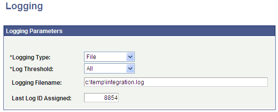

Access the Logging component to enable and configure the logging feature under Set Up SACR > System Administration > Integrations > Logging.
Image: Example of how the Logging page can be set up
This example illustrates the fields and controls on the Example of how the Logging page can be set up. You can find definitions for the fields and controls later on this page.
Note: You should not enable logging in a production environment. SOA framework logging is only appropriate for a testing, demo or development environment or when performing critical troubleshooting activities.
