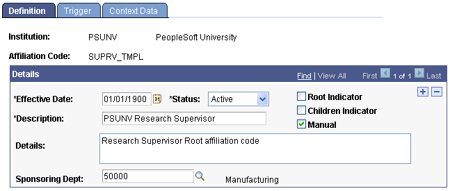

| Manual |
Select this check box to indicate that the affiliation code can be assigned and end dated only manually. The Affiliation Code is assigned and end-dated via the administrative component, Add/Update Affiliations. When you select the check box, the system removes the capability for a user to add an affiliation class and also applies a dummy event for triggering the affiliation as part of its definition. There is no underlying PeopleCode logic that determines whether the affiliation code can be assigned or end dated for triggering events. Because there is no logic associated with the affiliation code, the code cannot be used as part of affiliations batch processing and has no triggering events. |

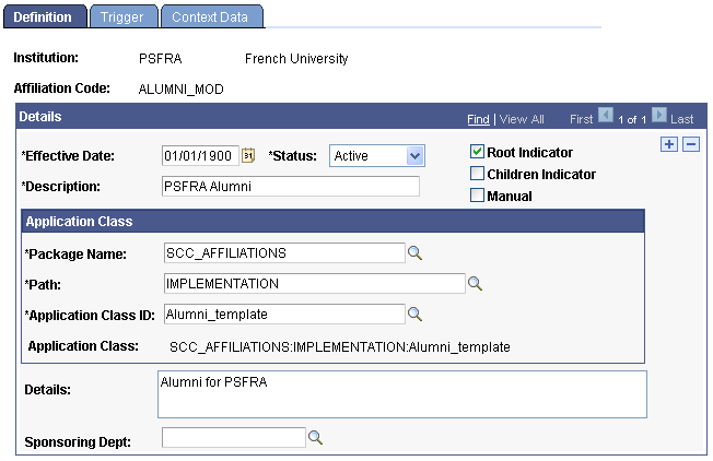

Single-Level Hierarchy Example
In this example, the Root Indicator check box is selected and the Children Indicator check box is clear. This specifies that there are no additional subcategories or children associated with this affiliation code. Since this is the lowest level in the hierarchy, the application class is entered here to define the transactional logic.
Image: Single-level hierarchy example
This example illustrates the fields and controls on the Single-level hierarchy example. You can find definitions for the fields and controls later on this page.

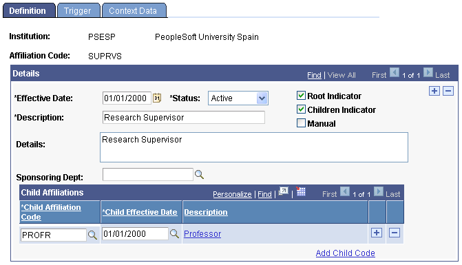

In this example, the Root Indicator check box is selected and the Children Indicator check box is selected for the parent/root affiliation. This specifies that the root has additional subcategories or children associated with it. When you select the Children Indicator check box, you can then enter an associated Child Affiliation Code that has already been defined.
Image: Two-level hierarchy example (1 of 2)
This example illustrates the fields and controls on the Two-level hierarchy example (1 of 2). You can find definitions for the fields and controls later on this page.

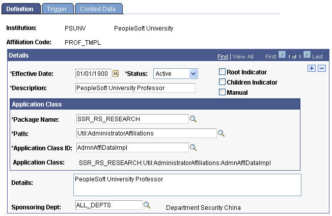

The lowest level of a hierarchical affiliation does not have the check boxes for either Root Indicator or Children Indicator selected. In a two-level hierarchy, the child of the affiliation has no indicator boxes checked and the Application Class field contains the actual affiliation application class value.
Image: Two-level hierarchy example (2 of 2)
This example illustrates the fields and controls on the Two-level hierarchy example (2 of 2). You can find definitions for the fields and controls later on this page.

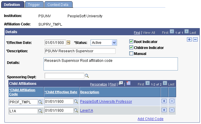

In this example, both the Root Indicator check box and the Children Indicator check box are selected for the parent/root affiliation code. This specifies that the root has additional subcategories or children associated with it. When you select the Children Indicator check box, you can then define or enter an associated Child Affiliation Code that has already been defined.
Image: Three-or-more level hierarchy example (1 of 3)
This example illustrates the fields and controls on the Three-or-more level hierarchy example (1 of 3). You can find definitions for the fields and controls later on this page.

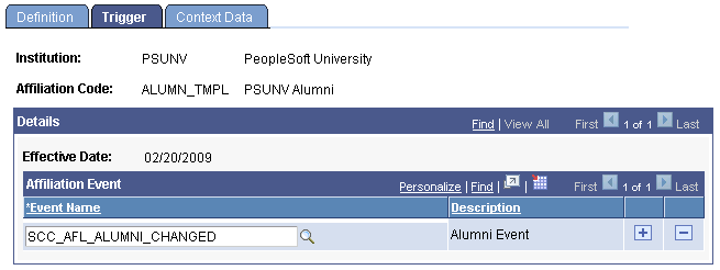

Access the Trigger page ().
Image: Trigger page
This example illustrates the fields and controls on the Trigger page. You can find definitions for the fields and controls later on this page.
Add the Event Name, registered through the Constituent Event Registration component, that associates the application class with a constituent management service operation for the affiliation code. There are six delivered triggers that correspond to the system-defined affiliation templates for Alumni, Recruiter, and Non-Student Employee. These are:
Alumni: SCC_AFL_ALUMNI_CHANGED
Recruiter: SCC_AFL_RECRUITER_CHANGED
Non-Student Employee: WORKFORCE_SYNC
Applicant: SCC_AFL_APPLICANT_CHANGED
Student: SCC_AFL_STUDENT_CHANGED ( for Student Enrollment) , SCC_AFL_STUDENT1 (for Quick Admit Student)

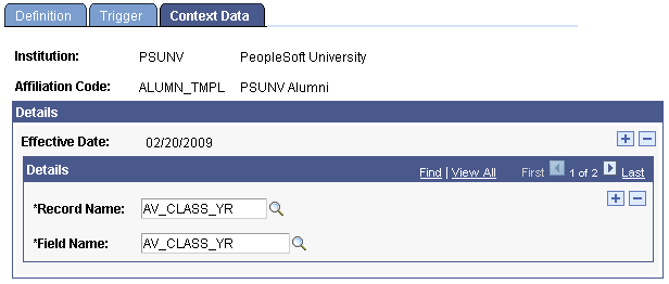

Access the Context Data page ().
Image: Context Data page
This example illustrates the fields and controls on the Context Data page. You can find definitions for the fields and controls later on this page.
The Context Data tab of the Affiliation Setup component is used to associate additional record/field pairs with the Affiliation Code. These details are then included as part of the data when the Affiliation event message is published. Up to ten separate record/field pairs may be defined.
Field or Control |
Definition |
| Record Name |
Select the Record Name table or Record Name for the Field Name you want to associate with the Affiliation Code. |
| Field Name |
Select the Field Name you want to associate with the Affiliation Code and publish within the Affiliation message. |
