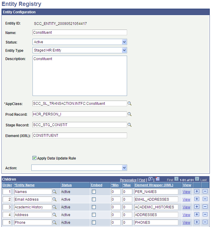

You attach a unit test to a specific entity. To attach a unit test to an entity:
Navigate to the Entity Registry page for the entity to which you want to attach a unit test (Set Up SACR, System Administration, Entity, Entity Registry). Continuing with the previous code example, the following shows that the Constituent entity is selected.
Image: Example of the Entity Registry page for the Constituent entity
This example illustrates the fields and controls on the Example of the Entity Registry page for the Constituent entity. You can find definitions for the fields and controls later on this page.

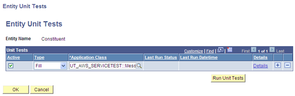

Select Unit Test in the Action field to access the Entity Unit Tests (setup) page.
Image: Entity Unit Tests (setup) page (for the Constituent entity)
This example illustrates the fields and controls on the Entity Unit Tests (setup) page (for the Constituent entity). You can find definitions for the fields and controls later on this page.
Field or Control
Definition
Active Select to allow the system to run the unit test.
If you clear this check box, the system ignores the unit test.
Type Select a categorical classification of the unit test, this is mostly for description.
Application Class Select the class that you have created for the unit test. In the previous exhibit example — Entity Unit Tests (setup) page for the Constituent entity — the MessageGenerator class is selected for the Constituent entity.
Run Unit Tests Click to run the unit test.
You can add any number of unit tests on this page and click this button once to run all the tests simultaneously.
OK Click to save this unit test setup.
The other fields on this page are similar to the Entity Unit Tests (view-only) page that is described in the next section “Running Entity Unit Test Cases”.

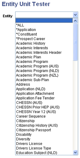

Access the Entity Unit Tester page ().
Image: Entity Unit Tester page
This example illustrates the fields and controls on the Entity Unit Tester page. You can find definitions for the fields and controls later on this page.

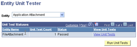

This component is purely for running unit tests that you associate with entities on the Entity Unit Tests (setup) page. The unit tests themselves are based on the Campus Solutions delivered unit test framework.
First, select an entity. This loads the unit tests specified in the Entity Registry for that entity and all child entities in the grid below it. Except for the entity called ‘All’, the prompt dynamically marks with an * the entities that have no parent entity. Those can be considered top level entities. ALL is a special case as it runs unit tests for all entities in the registry.
Image: Example of the Entity Unit Tester page for a selected entity
This example illustrates the fields and controls on the Example of the Entity Unit Tester page for a selected entity. You can find definitions for the fields and controls later on this page.
Once an entity is selected, any unit test for that entity or any children show up. If an entity has no unit tests, it does not appear in the grid.
Clicking the Run Unit Tests button starts running unit tests entity by entity. Each time all the unit tests for an entity are completed the status is returned and the next entity is set for running. This is all done automatically.
The statuses are set to either Passed or Failed - Passed telling you all the unit tests passed and Failed meaning at least one unit test failed.
Warning! Once the unit tests start, wait until statuses are set for all unit tests. Changing pages and other such actions interrupt the unit test process.

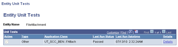

Click the View Unit Tests link on the Entity Unit Tester page to access the Entity Unit Tests page. The Entity Unit Tests page displays the individual unit tests for an entity.
Image: Entity Unit Tests page
This example illustrates the fields and controls on the Entity Unit Tests page. You can find definitions for the fields and controls later on this page.
Note: The fields on the Entity Unit Tests page are display only. Their setup is defined by selecting Unit Test in the Action field on the Entity Registry page for the entity.
Field or Control |
Definition |
| Active |
Specifies if the unit test is set to active and should be run. Any unit test set to not active is not run. |
| Type |
A categorical classification of the unit test, this is mostly for description. |
| Application Class |
The application class of the unit test you created for this entity. |
| Last Run Status |
The status the last time this unit test was run (Passed or Failed). |
| Last Run Datetime |
The last time this unit test was run. |
| Details |
Click to access the Entity Unit Test Details page. The page displays the details of the unit test, including all messages output. If a unit test fails, the information provided could help you identify the reasons of the failure. |

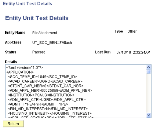

The following is an example of the Entity Unit Test Details page:
Image: Entity Unit Test Details page
This example illustrates the fields and controls on the Entity Unit Test Details page. You can find definitions for the fields and controls later on this page.
