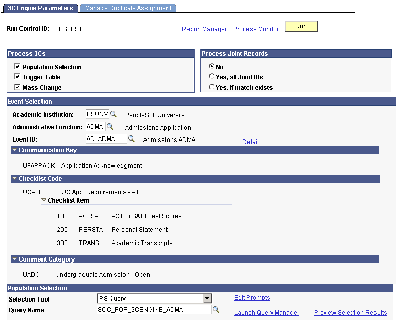

Access the 3C Engine Parameters page (Campus Community > 3C Engine > Run 3C Engine > 3C Engine Parameters page).
Image: 3C Engine Parameters page (1 of 2)
This example illustrates the fields and controls on the 3C Engine Parameters page (1 of 2). You can find definitions for the fields and controls later on this page.
3C (communications, comments, and checklists) Engine Parameters page (1 of 2)
Image: 3C Engine Parameters page (2 of 2)
This example illustrates the fields and controls on the 3C Engine Parameters page (2 of 2). You can find definitions for the fields and controls later on this page.
3C (communications, comments, and checklists) Engine Parameters page (2 of 2)
Process 3Cs
Group boxes and fields appear on this run control page based on the process that you select: Population Selection, Trigger Table, Mass Change, or any combination thereof.
Field or Control
Definition
Select to use the Population Selection process to identify the IDs for the 3C engine to process for the event that you specify.
When selected, the Event Selection and Population Selection group boxes become available.
Note: The Population Selection check box is not visible if the population selection context for the 3C Engine does not allow this menu navigation to use Population Selection to select the IDs to process.
Trigger
Select to have the 3C engine process the rows on the 3C Engine Trigger Results page for the event that you specify.
When selected, the Event Selection group box becomes available.
Mass Change
Select to have the 3C engine process the mass change group ID data for the event that you specify.
When selected, the Mass Change Selection group box becomes available.
Event Selection
This group box appears when you select Population Selection or Trigger Table, or both.
Field or Control
Definition
Academic Institution
Enter the institution whose data this program should process.
Administrative Function
Enter the functional area of the data to process.
The field values that appear or become available on the rest of the page are based on the administrative function that you enter.
Event ID
Enter the 3C engine event ID to process.
Detail
Click to access the Event Definition page for the specified event ID where you can view or update the event definition and determine which communications, checklists, and comments the definition includes.
Joint Processing
This group box appears for all selections.
Field or Control
Definition
No
Select this option if you do not want to apply joint communication rules to this process.
Yes, All Joint IDs
Select this option to apply joint communication rules and include all communications set to enable joint communications.
Yes, if match exists
Select this option to apply joint communication rules and include joint communications only when dates in the variable data fields match.
Communication Key, Checklist Code, and Comment Category
These group boxes appear when you select Population Selection or Trigger Table, or both. They do not appear for Mass Change because the communication key is selected from inside the mass change definition.
The system displays the Comm Key for the checklist code and checklist item and the comment category associated with the event ID that you entered. The 3C engine adds or updates these items for the IDs identified by the processes you selected .
This group box appears when the Population Selection process is selected.
Population selection is a method for selecting the IDs to process for a specific transaction. The Population Selection group box is a standard group box that appears on run control pages when the Population Selection process is available or required for the transaction. Selection tools are available based on the selection tools that your institution selected in the setup of the Population Selection process for the application process and on your user security. Fields in the group box appear based on the selection tool that you select. The fields behave the same way from within the group box on all run control pages and application processes.
If your institution uses a specific delivered selection tool (PS Query, Equation Engine equation, or external file) to identify IDs for a 3C engine transaction, you must use it.

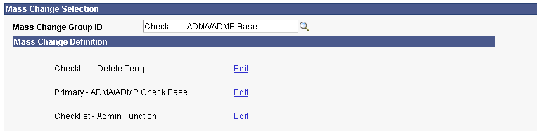

This group box appears when you select Mass Change.
Field or Control
Definition
Mass Change Group ID
Enter the group ID to process.
Mass Change Definition
Displays the mass change definitions that are assigned to the specified Mass Change Group ID.
Edit
Click to access the Student Administration page of the Mass Change component where you can view and edit the specific mass change definition.
See Processing Mass Changes.
