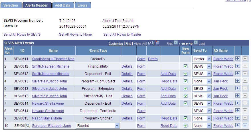

Access the Alerts Header page. (For F/M alerts, . For J alerts, .)
Image: Alerts Header page
This example illustrates the fields and controls on the Alerts Header page. You can find definitions for the fields and controls later on this page.
The Alerts Header page lists the events that will trigger when the Process SEVIS Alerts process runs for the specific visa type.
If the Send To SEVIS check box on the SEVIS Event Types page is selected for the event type, and the event has no errors, the system sets the Send To value to SEVIS, and the Extract SEVIS process includes the event in the XML file to send to SEVIS. If the Form Request Available check box on the SEVIS Event Types page is selected, the system also displays the New Form check box already selected on the Alerts Header page to request a new I-20 for F and M visas or a new DS-2019 form for J visas. You can change the default Send To value for each event.
The Extract SEVIS process does not include events set to Master or None in the XML file to send to SEVIS.
When the Send To field is set to Master (for Master Sync), the Alerts process synchronizes the event data by directly uploading it to the appropriate fields on the active effective status row in the SEVIS Master component, and the Extract SEVIS process updates the SEVIS Status value if needed.
For Create Student for F and M visas or Create EV events for J visas set to Master, the Alerts process inserts new active status rows in the SEVIS Master component, and the Extract SEVIS process sets the SEVIS Status to Initial. This enables you to update the SEVIS Master component with data entered manually in SEVIS RTI.
Note: If you set the Send To field to Master for a Create Student, Create EV, or Dependent - Add event types, you must manually enter the SEVIS ID for the student or exchange visitor and their dependents on the SEVIS ID Maintenance page.
When errors occur, the SEVIS Alerts process sets the Send To field to None. You can change it to Master to send the event without clearing the errors. Review the errors before changing it. Correct errors as necessary, and run the Alerts process for that visa type again to trigger the events with no errors before updating the SEVIS Master directly.
An example of when you might want to change None to Master for F and M visas without correcting the data is when the error occurs because the From date is not later than or equal to the current system date for an initial creation Create Student event. The student might have been created in RTI in the past and you need to reflect the dates as they appear in RTI, and therefore the error is acceptable.
An example of when you might want to change None to Master for J visas without correcting the data is when the error occurs because the Start date is not later than or equal to the current system date for Create EV event. The exchange visitor might have been created in RTI in the past and you need to reflect the dates as they appear in RTI, and therefore the error is acceptable.
You can add a row to manually enter an event for a student or exchange visitor if the Allow Manual Addition check box is selected for the event type on the SEVIS Event Types page and the student has a SEVIS ID for the specified school code or the exchange visitor has a SEVIS ID for the specified program code.
When the SEVIS Alerts process for the visa type runs, it moves all events with no errors to the View SEVIS Events History component.

SEVIS Alert Events
Field or Control |
Definition |
| Name |
Click the name to access the individual's Bio/Demo Data page in update/display mode. The page opens in a new window. |
| Details |
This link is available only when the Compare Detail check box on the SEVIS Event Types page, Event Defaults tab, is selected for the event type Click to access the Compare Detail page where you can view the changes in data that triggered the event. |
| Form |
Click the link to open the I-20 form for F and M visas or the DS-2019 form for J visas in update/display mode. The form opens in a new window. |
| Errors |
Appears only if errors are detected. Click the link to access the Errors page. You must correct errors and run the Alerts Process for that visa type again to be able to set the Send to field to SEVIS. You can select Master without clearing the errors. |
| Addl Data (additional data) or Reqd Data (required additional data) |
If the Addl Data link appears, additional data is optional. Select the link to access the Additional Data page where you can enter the data. If the Reqd Data link appears, additional data is required. Select the link to access the Additional Data page where you must enter values in the required fields before you can set the Send To field to either Master or SEVIS. No link appears if no additional data is permitted or required. For a list of the event types that have required or optional additional data, refer to the description of the Addl Data field on the SEVIS Event Types page. |
| New Form |
The system requests a new I-20 form for F and M visas or a new DS-2019 form for J visas if the event has no errors and if the New Form check box for the event type is selected on the SEVIS Event Types page. You can override the default value. |
| Send to |
Select:
| DSO Name or RO Name |
For F and M visas, the system displays the name of the DSO listed on the most recent I-20 form, and for J visas the system displays the name of the RO listed on the most recent DS-2019 form. Select the name to view a list of DSOs or ROs. If a different DSO or RO is responsible for this event, select the correct one to include in the XML file to send to SEVIS. |
