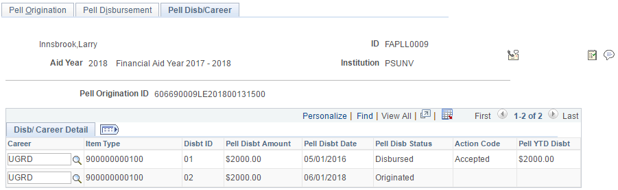

Pell Disb/Career (Pell disbursement and career)
PELL_DISB_1
Financial Aid > Pell Payment > Manage Pell Payment > Pell Disb/Career
Change a career on any disbursement row that was previously processed using an old career.
Access the Pell Disb/Career page (Financial Aid > Pell Payment > Manage Pell Payment > Pell Disb/Career).
Image: Pell Disb/Career page
This example illustrates the fields and controls on the Pell Disb/Career page: Disb/Career Detail tab. You can find definitions for the fields and controls later on this page.
Pell Disb (disbursement)/Career page
Field or Control
Definition
Career
Displays the code that represents the type of academic work done by the student.
Item Type
Displays the code for the financial aid item type
Pell Dsbt Amount (Pell disbursement amount)
Displays the amount of the disbursement.
Pell Disb Status (Pell disbursement status)
Displays the Pell disbursement status based on the origination, disbursement, or any other outbound process. Values are: Originated, Disbursed, and Transmitted.
Action Code
Displays the action code, which indicates an action to be taken. The action code value is a result of the acknowledgment record. Values are:
A: Accepted, all fields accepted.
C: Corrected, one or more fields corrected.
D: Duplicate.
E: Rejected, record was rejected.
Pell YTD Dsbt (Pell year-to-date disbursed)
Displays the total year-to-date number of disbursements received and accepted by your institution.
