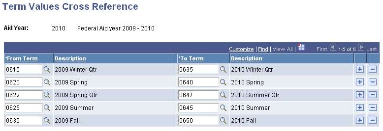

Term Values Cross Reference
TERM_VALUES_XREF
Set Up SACR > Product Related > Financial Aid > Aid Year > Term Values Cross Reference
Set up term value cross-reference to process all rollover options except for General Aid Year and Aggregate Aid Limits.
Aid Year Setup
RUNCTL_AID_YEAR
Set Up SACR > Product Related > Financial Aid > Aid Year > Aid Year Setup
Create aid-year—specific setup tables from year to year.
Access the Term Values Cross Reference page (Set Up SACR > Product Related > Financial Aid > Aid Year > Term Values Cross Reference).
Image: Term Values Cross Reference page
This example illustrates the fields and controls on the Term Values Cross Reference page. You can find definitions for the fields and controls later on this page.
Set up the Term Values Cross Reference page to process all options except General Aid Year and Aggregate Aid Limits. Confirm that your records department has set up term values for the target aid year being created and has also associated each term with the appropriate career in the Term/Session table. Term values that are set up in Cross Reference that do not exist in Student Records are not created for the tables being processed. Verify term setup in Student Records before you set up your Term Values Cross Reference.
Field or Control
Definition
From Term
Enter the terms from your source year.
To Term
Enter the terms to be created by associating them with the appropriate From Term value.

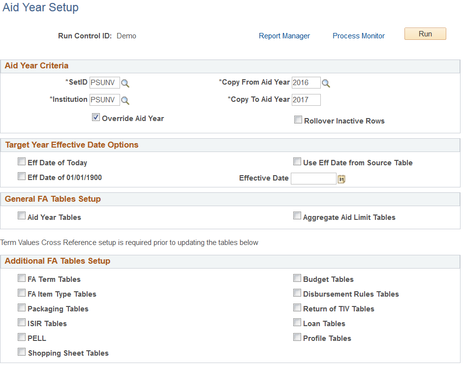

Access the Aid Year Setup page (Set Up SACR > Product Related > Financial Aid > Aid Year > Aid Year Setup).
Image: Aid Year Setup page
This example illustrates the fields and controls on the Aid Year Setup page. You can find definitions for the fields and controls later on this page.
Aid Year Setup page
Note: You must perform a separate aid year rollover for each set of setID and institution combinations.
After selecting your rollover options, click the Run button to run the FA_AID_YEAR process.
Carefully review the message log generated by this process. Although you can access the message log several ways, to get additional details, click Process Monitor to locate the appropriate process instance for this process. Click Details and then click Message Log. For each process action, you can click Explain to review additional information about the action taken or the action that you might need to take.
Aid Year Criteria
Field or Control
Definition
SetID
Select the setID. In cases in which institution and setID are keys, the system rolls only those rows found that match on both the setID and institution. For example, the Loan Fee Table is keyed by setID and institution, so if you specify SetID = GLAKE Institution = PSUNV, the system does not create rows for SetID of PSUNV with Institution PSUNV for the aid year created by the process.
Institution
Select the institution to process the source year and copy to the target year.
Copy From Aid Year
Select the source aid year.
Copy To Aid Year
Select the target aid year.
Override Aid Year
Select to override setup tables in the target year for which they might already be created. When you select this check box, the system rolls over a new record along with records that have already been rolled over. If you have updated the tables in the target year either manually or after you have run the aid year process, and you run aid year rollover again with this check box selected, the system overwrites the updated target data with source year data. If the check box is cleared and you have made changes to the source year data, the system does not roll these changes forward to the target year if the target table has already been created.
The Override Aid Year option works differently for budgets. When you select the Budget Table option and Override Aid Year is not selected, the system rolls forward only new rows added in the source year to the target year. This way, data that has been rolled previously is preserved, and the system adds new source year data to it.
Rollover Inactive Rows
Select to roll forward to the target year an inactive row if it is the latest row in the table being processed. If you select this option for disbursement rules or budgets, the system rolls forward any inactive row in the source year to the target year. The system assigns any inactive rows created in the target year an inactive status.
Target Year Effective Date Options
Field or Control
Definition
Eff Date of Today (effective date is today's date)
Select to insert the current date for all effective-dated rows created except for disbursement rules and budgets.
Use Eff Date from Source Table (use effective date from the source table)
Select to insert the date used in base year rows for all effective-dated rows created in the target year.
Eff Date of 01/01/1900 (effective date of January 1, 1900))
Select to (with the exception of disbursement rules and budgets) roll forward only the latest effective-dated row from the source year to the target year. The process rolls over rows to the new aid year using one of three effective-dated choices, and if applicable, existing sequence, process, criteria, and so on.
For disbursement rules and budgets, the process rolls forward all active rows and always uses the source date as the effective date. You must manually adjust these dates. For all options, the process does not roll over inactive rows unless you select the Rollover Inactive Rows option.
Effective Date
Select a static date as the Effective Date for all effective-dated rows except for disbursement rules and budgets.
Note: If you specify a date in this field, you cannot select any of the other Target Year Effective Date Options.
