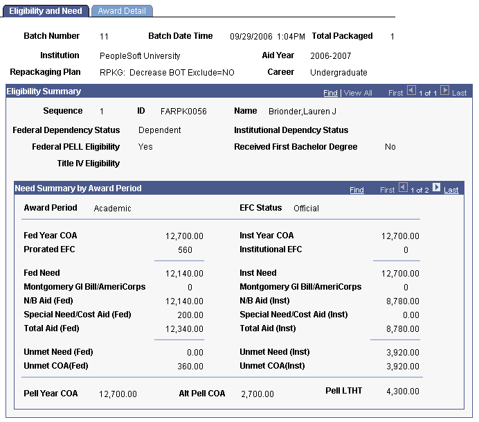

Access the Eligibility and Need page ().
Image: Eligibility and Need page
This example illustrates the fields and controls on the Eligibility and Need page. You can find definitions for the fields and controls later on this page.
This information is for a single repackaging plan. To view other students, use the Eligibility Summary scroll arrows. To view further information for this student, use the Need Summary by Award Period scroll arrows.
Eligibility Summary
Field or Control |
Definition |
| Sequence |
Indicates the order in which students were repackaged during the Repackaging process. |
| Federal Dependency Status |
Indicates whether the student is dependent or independent under federal methodology. |
| Institutional Dependcy Status (institutional dependency status) |
Indicates whether the student is dependent or independent under institutional methodology. |
| Federal PELL Eligibility |
Indicates whether the student is eligible to receive a Pell Grant. |
| Received First Bachelor Degree |
Indicates whether the student has already received his or her first bachelor's degree. |
| Title IV Eligibility |
Indicates whether the student is eligible to receive federal Title IV aid. |

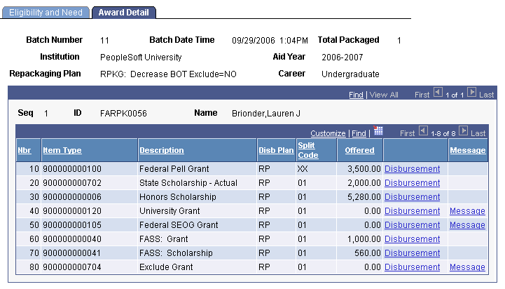

Access the Award Detail page ().
Image: Award Detail page
This example illustrates the fields and controls on the Award Detail page. You can find definitions for the fields and controls later on this page.
All awards in the repackaging plan are listed as zero or nonzero awards. Nonzero awards display a link to the scheduled disbursements.
Field or Control |
Definition |
| Seq (student sequence) |
| Nbr (award number) |
The sequence number is automatically assigned in increments of ten when awards are entered. |
| Item Type |
The financial aid item type of the student's award. |
| Disb Plan (disbursement plan) |
The disbursement plan that is assigned to the student's award. |
| Split Code |
The split code of the student's award, which indicates how the award is split for disbursement to the student. |
| Offered |
If the offered amount for an award is 0.00, then the student was not eligible for that particular award or it was an unlocked, pre-existing award. The zero awards are not visible after the student's award package is posted. |
| Disbursement |
Click to access the Batch Repackaging Disbursement page and view scheduled disbursement detail for an award. |
| Message |
Click to access the Batch Repackaging Message page and view the reason that the student did not receive this award. |
