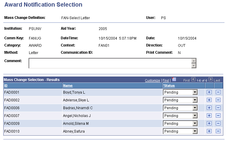

Access the Award Notification Selection page (Financial Aid > Awards > Notification Letter > View Mass Change Selection > Award Notification Selection).
Image: Award Notification Selection page
This example illustrates the fields and controls on the Award Notification Selection page. You can find definitions for the fields and controls later on this page.
The Mass Change Selection - Results group box lists the students who are selected to receive a FAN by the mass change process.
Field or Control
Definition
Status
Specifies the current status of the student's FAN communication, and determines whether the student is selected for inclusion in the extract file. As long as the student does not have a status of Cancel, the student is selected for inclusion in the extract file. To prevent a student from receiving a FAN letter, you can either change the student's status to Cancel or you can delete the student's row.
Cancel: Select this value to prevent the student from having a FAN communication assigned.
Pending: The student has been selected to have a FAN communication assigned, but it has not yet been assigned (the 3C Engine still needs to be run).
Successful: Indicates that a FAN communication has been successfully assigned to the student.

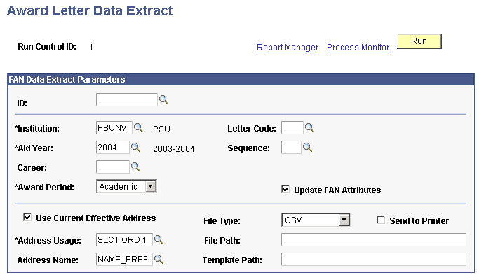

Access the Award Letter Data Extract page (Financial Aid > Awards > Notification Letter > Create Award Letter Data File > Award Letter Data Extract).
Image: Award Letter Data Extract page
This example illustrates the fields and controls on the Award Letter Data Extract page. You can find definitions for the fields and controls later on this page.
Field or Control
Definition
ID
Select the student that you are working with if you are creating a FAN letter for only one student. If no ID is selected, all students who have been selected to receive a FAN are included in the extract file.
Letter Code
Select FAN.
Sequence
This number distinguishes between versions of letters sent to a student. Each time a new communication and award notification letter (FAN) are requested, a sequential number is assigned to the award notification letter. This sequence is increased by one each time an additional award notification letter is requested. The sequence number allows you to select which version of the award notification letter that you want to use if an ID is entered.
Career
If you select an ID and a sequence number you can select a career for the student. If you select a career, only awards for that career are printed on the FAN. If you do not select a career, then awards for all the student's careers are printed on the FAN. If the student is a multiple career student and you want awards for all careers printed on the FAN, do not select a career.
When selecting a group of students for whom to run this process, if you select a career, then only the awards for that career for each student are printed on the FAN. If you have multiple career students and you want awards for all their careers to be printed on the FAN, do not select a career.
Award Period
Select the award period for which you want the FAN letter created. The default value is Academic. Non Std (non standard) is also available for nonacademic terms.
FA Term determines the default for these periods and now uses the last effective-dated sequence or effective-dated status. For example, if the default is Academic and because different academic statuses are available in FA Term, such as fall 2006-2007, spring 2006-2007, and summer 2007-2008, the system uses the last effective-dated sequence or effective-dated status for that aid year.
Update FAN Attributes
Select to update the Print Status field on the Award Notification Summary page and update the communication record. Clear to run the process in test mode only.
Use Current Effective Address
Select to have the Create Award Data Extract process (FANLTR) re-select the student's name and address information using the information that you enter in the Address Usage and Address Name fields on this page. Clear to have the extract file contain the name and address chosen during the FANSEL process.
Address Usage
The address usage determines which address is printed on the FAN letter. Address usage is defined by your institution. The default value is the address usage from the student selection process.
Address Name
Select the address name to use for this FAN letter. This determines what name is printed on the FAN letter. Address name is defined by your institution. The default value is the address name from the student selection process.
File Type
Select the extract file type to be created. Values are: JetForm, CSV, and Other. JetForm is the default value. The value that you select in this field determines what other file-related fields appear on the page.
If you select JetForm, the page displays the File Path and Override Flags fields.
If you select CSV, the page displays the Send to Printer check box, the File Path field, and the Template Path field.
If you select Other, the page displays the File Path field.
Send to Printer
If you select CSV for the file type and you want the letter to go directly to the printer during the Microsoft Word merge process, select this check box.
File Path
Enter the full path of where you want the extract file to reside after the FANLTR process is run. Include a / or \ at the end of the path, such as C:\TEMP\ or //user/tmp/. Make sure that the destination folder or directory is a valid share folder or directory on the network.
Template Path
If you select CSV for the file type, you must indicate where your award letter master document (FANLTR.doc) and your template file (FANLTR.dot) reside. The Microsoft Word merge process uses this information. This location is usually \\PS_HOME\Winword.
Override Flags
If you select JetForm for the file type, specify print options to use when producing the FAN, such as the number of copies to create.
Run
Click to run this request. Process Scheduler runs the Create Award Data Extract process (FANLTR) at user-defined intervals. After the system runs the process successfully, you can retrieve the extract file from the file path you specified. You can then use the extract file in whatever software you use to create the actual FAN letter.
