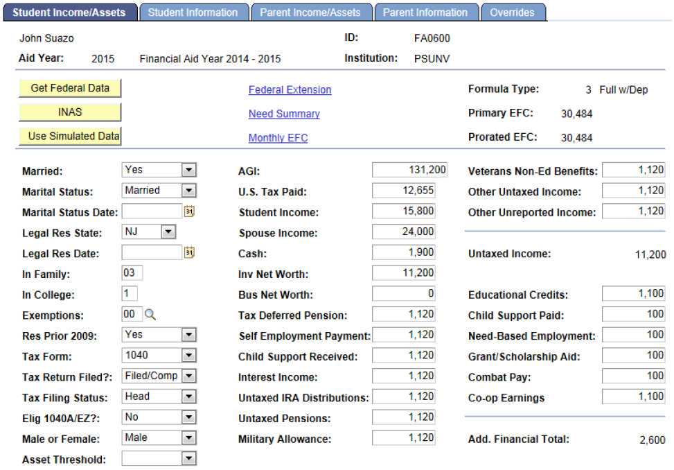

Student Income/Assets
INAS_SIM_STU1_nn
Financial Aid > Federal Application Data > Simulate 20nn-20nn FM INAS > Student Income/Assets
View or update fields from ISIR Corrections to perform an INAS calculation.

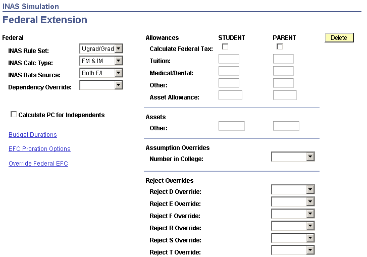

INAS Simulation Federal Extension
INAS_SIM_FEDEX_Snn
Click the Federal Extension link on the Student Income/Assets page.
Override the INAS global policy options at the student level.
INAS Simulation Budget Durations
INAS_SIMEX_DUR_SEC
Click the Budget Durations link on the INAS Simulation Federal Extension page.
Override INAS global policy options for federal academic and non-standard budget duration.
INAS Simulation EFC Proration Options
INAS_SIMEX_PRO_SEC
Click the EFC Proration Options link on the INAS Simulation Federal Extension page.
Override proration options for academic and non-standard months.
INAS Simulation EFC Override
INAS_SIMEX_EFC_SEC
Click the EFC Override link on the INAS Simulation Federal Extension page.
Override EFC components for academic and non-standard award periods.

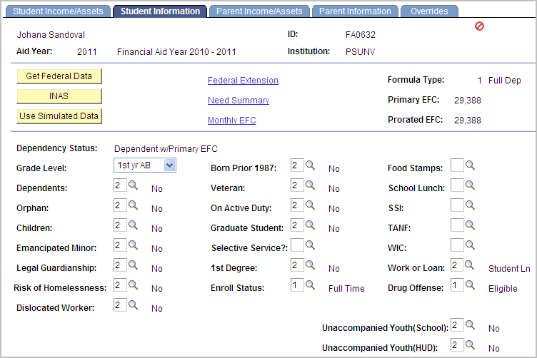

Student Information
INAS_SIM_STU2_nn
Financial Aid > Federal Application Data > Simulate 20nn-20nn FM INAS > Student Information

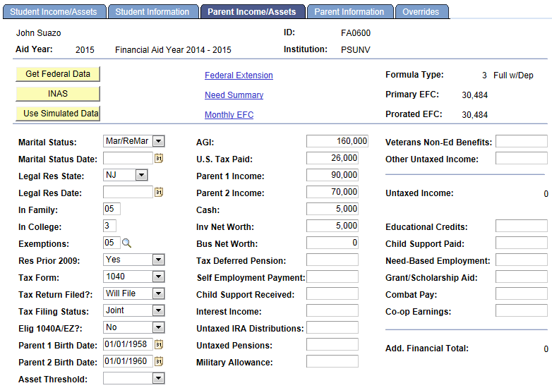

Parent Income/Assets
INAS_SIM_PAR1_nn
Financial Aid > Federal Application Data > Simulate 20nn-20nn FM INAS > Parent Income/Assets

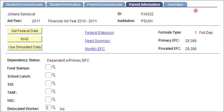

Parent Information
INAS_SIM_PAR2_nn
Financial Aid > Federal Application Data > Simulate 20nn-20nn FM INAS > Parent Information

Access the Student Income/Assets page (Financial Aid > Federal Application Data > Simulate 20nn-20nn FM INAS > Student Income/Assets).
Image: Student Income/Assets page
This example illustrates the fields and controls on the Student Income/Assets page.
ISIR edits are not used in the simulation pages. Changes used should not conflict with data in ISIR corrections.
Access the INAS Simulation Federal Extension page (click the Federal Extension link on the Student Income/Assets page).
Image: INAS Simulation Federal Extension page
This example illustrates the fields and controls on the INAS Simulation Federal Extension page. You can find definitions for the fields and controls later on this page.
INAS (Institutional Need Analysis System) Simulation Federal Extension page
Field or Control
Definition
Budget Durations
Click this link to access the INAS Simulation Budget Durations page. You can enter any value for FM budget duration. Federal rules allow whole numbers only for budget duration. If the total allocation for the budget duration is greater than 12 months, a 9–month EFC is calculated and used in the academic award period, and no EFC is calculated for the non-standard award period.
Click this link to access the INAS Simulation EFC Proration Options page to determine how to prorate EFC.
Override Federal EFC
Click this link to access the INAS Simulation EFC Override page to override the academic or non-standard parent contribution or student contribution.
Access the Student Information page (Financial Aid > Federal Application Data > Simulate 20nn-20nn FM INAS > Student Information).
Image: Student Information page
This example illustrates the fields and controls on the Student Information page. You can find definitions for the fields and controls later on this page.
Field or Control
Definition
Grade Level
Select from:
1st yr AB (attended before)
1st yr GP (graduate professional)
1st yr NA (never attended)
2nd yr Sph (sophomore)
3rd yr Jnr (junior)
4th yr Snr (senior)
5th yr UG (undergraduate)
Grad/Prof + (graduate/professional beyond 1st year)
Field Name Abbreviations and Explanations
On Active Duty (active duty status for US Armed Forces)
School Lunch (free or reduced price lunch)
SSI (Supplemental Security Income)
TANF (Temporary Assistance for Needy Families)
WIC (Women, Infants and Children)
Unaccompanied Youth (HUD) (Unaccompanied Youth – Housing and Urban Development)
Access the Parent Income/Assets page (Financial Aid > Federal Application Data > Simulate 20nn-20nn FM INAS > Parent Income/Assets).
Image: Parent Income/Assets page
This example illustrates the fields and controls on the Parent Income/Assets page.
Access the Parent Information page (Financial Aid > Federal Application Data > Simulate 20nn-20nn FM INAS > Parent Information).
Image: Parent Information page
This example illustrates the fields and controls on the Parent Information page. You can find definitions for the fields and controls later on this page.

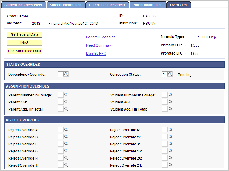

Access the Overrides page (Financial Aid > Federal Application Data > Simulate 20nn-20nn FM INAS > Overrides).
Image: Overrides page
This example illustrates the fields and controls on the Overrides page. You can find definitions for the fields and controls later on this page.
Overrides page
STATUS OVERRIDES
Field or Control
Definition
Dependency Override:
Values include:
1: Dependent to Independent. You can select this value.
2: Cancel Dep Override – Corr Only. You can select this value.
3: Override Failed. The correction process sets this value.
Correction Status:
Values include:
1: Correction(s) Pending. You can select this value.
2: Send Correction(s). You can select this value.
3: Correction(s) Sent. The correction process sets this value.
4: Correction(s) Accepted. The correction process sets this value.
5: Corrections Rejected. The correction process sets this value.
6: Do Not Send Correction(s). You can select this value.
ASSUMPTION OVERRIDES
Field or Control
Definition
Parent Number In College
Select 1:Yes.
Parent AGI (parent adjusted gross income)
Select 1:Yes.
Parent WKC Assumed Zero (parent income from worksheet C assumed 0)
Select 1:Yes.
Student Number In college
Select 1:Yes.
Student AGI (student adjusted gross income)
Select 1:Yes.
Student WKC Assumed Zero (student income from worksheet C assumed 0)
Select 1:Yes.
REJECT OVERRIDES
Select 1: Yes to override a listed reject.
