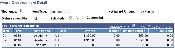

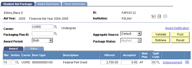

You can use any of the award entry pages to process the student for discrete award periods. For example, at a semester-based institution with a trailing summer term, you award a student a 2,700 USD Pell Grant for the AAP. The disbursement plan is for both semesters in the AAP, and the split code—set up as a custom split—calls for a 1,350.00 USD disbursement in the fall semester and a 1,350.00 USD disbursement in the spring semester. The following screen shot displays this award on the Student Aid Package page:
Image: Student Aid Package page displaying the student's award for the AAP (Based on Pell Grant awarding functionality for the 2009 and prior aid years.)
This example illustrates the Student Aid Package page displaying the student's award for the AAP (Based on Pell Grant awarding functionality for the 2009 and prior aid years.).
Student Aid Package page displaying the student's award for the AAP (academic award period) (Based on Pell Grant awarding functionality for the 2009 and prior aid years.)
Image: Award Disbursement Detail page (Based on Pell Grant awarding functionality for the 2009 and prior aid years.)
This example illustrates the Award Disbursement Detail page (Based on Pell Grant awarding functionality for the 2009 and prior aid years.).

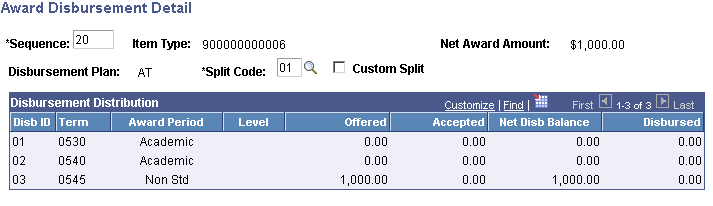

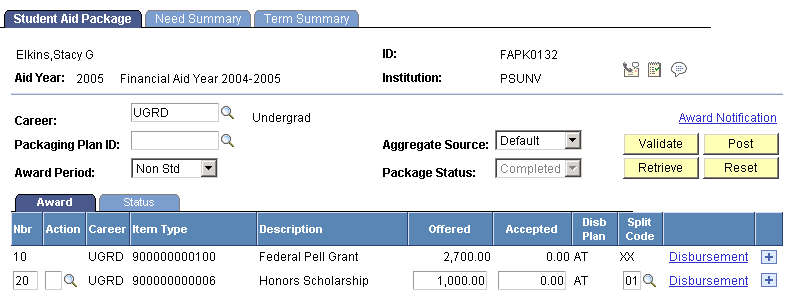

The student then decides to attend the trailing summer term, and you award the student a 1,000.00 USD Honors Scholarship for the NSAP. Before you manually enter this award, you must select Non Std − Non-Standard as the award period because you want to process the student for the NSAP and leave the existing Pell Grant award for the AAP untouched. When you select Non Std − Non-Standard, Packaging determines that the Pell Grant award is designated for the AAP and does not match the selected award period value, so it treats it as a passive award and makes the row unavailable. Now you cannot change the Pell Grant award, and Packaging does not reevaluate it when you validate the new award.
Insert a new row and add the 1,000.00 USD Honors Scholarship with a disbursement plan/split code pattern that distributes the award in the trailing summer term. When you validate this award, Packaging evaluates only this award and processes the Pell Grant award as a passive award.
Image: Student Aid Package page with new Honors Scholarship award and Federal Pell Grant (Based on Pell Grant awarding functionality for the 2009 and prior aid years.)
This example illustrates the Student Aid Package page with new Honors Scholarship award and Federal Pell Grant (Based on Pell Grant awarding functionality for the 2009 and prior aid years.).

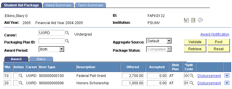

If you want to reevaluate the student's awards for both award periods, you can selected Both as the award period after you have posted the Honors Scholarship. Both the Pell Grant and the Honors Scholarship are then available for changes, and Packaging treats both awards as active awards and reevaluates them based on need and eligibility criteria/rules. These rows remain available and open.
Image: Student Aid Package page (Based on Pell Grant awarding functionality for the 2009 and prior aid years.)
This example illustrates the Student Aid Package page (Based on Pell Grant awarding functionality for the 2009 and prior aid years.).

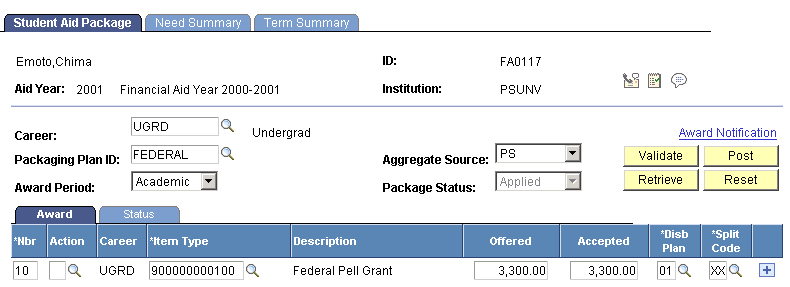

For example, at a semester-based institution with a trailing summer term, you award a student a 3,300.00 USD Pell Grant for the AAP. The disbursement plan is for both semesters in the AAP, and the split code—set up as a custom split—calls for a 1,650.00 USD disbursement in the fall semester and a 1,650.00 USD disbursement in the spring semester. The following screen shot displays this award on the Student Aid Package page:

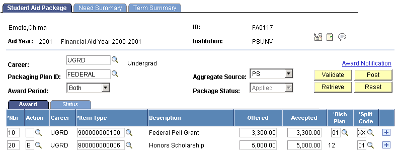

The student is then awarded a 5,000 USD Honors Scholarship that covers the trailing summer term in addition to the academic year, with 40 percent disbursed in fall (AAP), 40 percent disbursed in spring (AAP), and 20 percent disbursed in the trailing summer term (NSAP). Before you manually enter this award, you must select Both as the Award Period because you want to process the student for both the NSAP and the AAP. When you select Both, Packaging determines that the Pell Grant award is active because its disbursement plan/split code pattern designates it for the AAP, which falls within the chosen award period processing mode. Now you can change the Pell Grant award, and Packaging reevaluates it when you validate the new award. Because you are only adding the Honors Scholarship, you do not need to change the Pell Grant. Insert a new row, and add the 5,000.00 USD Honors Scholarship, choosing a disbursement plan that spans both award periods, and a split code that distributes the award 40 percent fall, 40 percent spring, and 20 percent summer. When you validate this award, Packaging evaluates both awards.
Warning! If there has been a change in the student's need or eligibility, the existing award is changed unless you have activated disbursement protection for that Financial Aid Item Type. Activating disbursement protection only protects the disbursed portion of the award. The award itself can be reduced to the level of the disbursed amount.
Image: Student Aid Package page with an Award Period value of Both, adding the Honors Scholarship (Based on Pell Grant awarding functionality for the 2009 and prior aid years.)
This example illustrates Student Aid Package page with an Award Period value of Both, adding the Honors Scholarship (Based on Pell Grant awarding functionality for the 2009 and prior aid years).

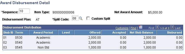

For example, at a semester-based institution with a trailing summer term, you award a student a 5,000 USD Honors Scholarship that covers the trailing summer term in addition to the academic year, with 40 percent disbursed in fall, 40 percent disbursed in spring, and 20 percent disbursed in the trailing summer term. The following screen shot displays this award on the Student Aid Package page:
Image: Student Aid Package page displaying the student's award for both award periods
This example illustrates the Student Aid Package page displaying the student's award for both award periods.

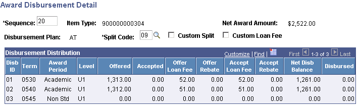

Then you offer the student a 2,625.00 USD subsidized Stafford loan for the academic year. Before you manually enter this award, you must select Academic as the award period, because you want to process the student only for the AAP. When you select Academic, Packaging determines that the Honors Scholarship is active because its disbursement plan/split code pattern designates it for both award periods, which spans the chosen award period processing mode of Academic.
This example illustrates the Award Disbursement Detail page.

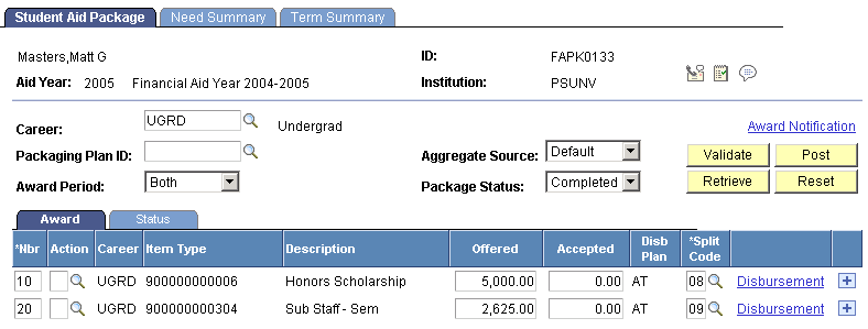

Now you insert a second row and enter the 2,625 USD subsidized Stafford loan, with a disbursement plan/split code pattern that spans only the AAP. You can also change the Honors Scholarship award, and Packaging reevaluates it for need and eligibility when you validate the new award. However, Packaging changes only the disbursements in the AAP; the NSAP portion of the award remains unchanged.
Warning! Even if you do not change or intend to change the Honors Scholarship, the AAP portion of the award is reevaluated automatically by Packaging.

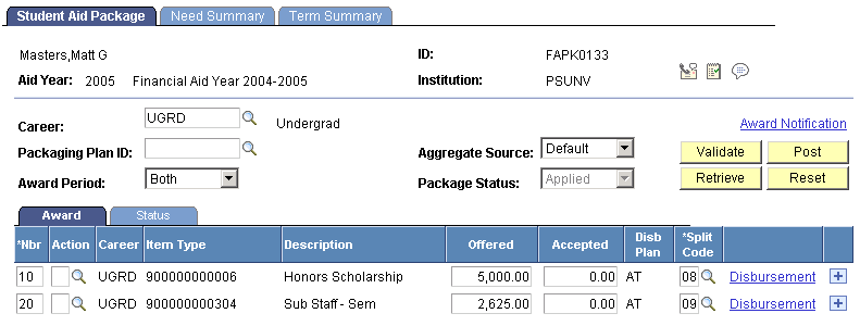

This example illustrates the Student Aid Package page.
