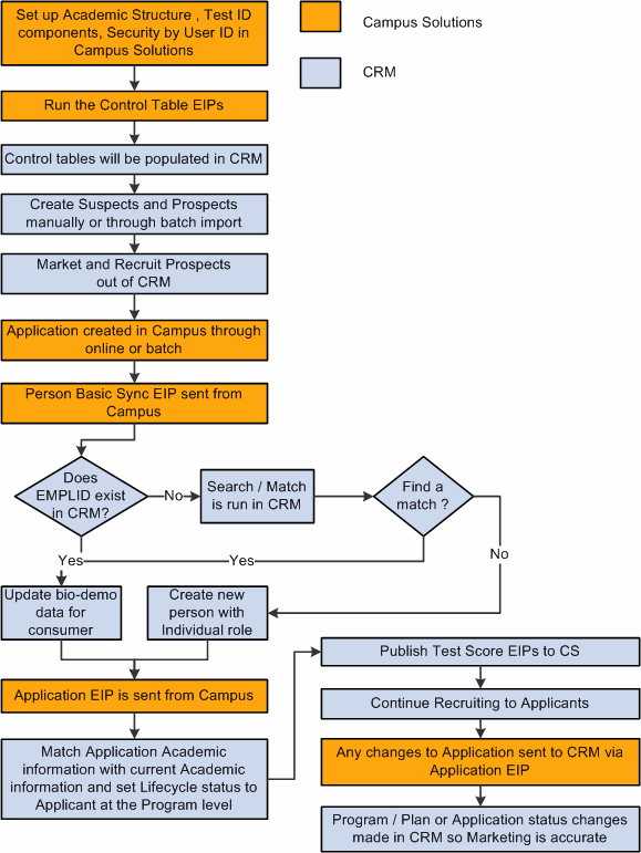

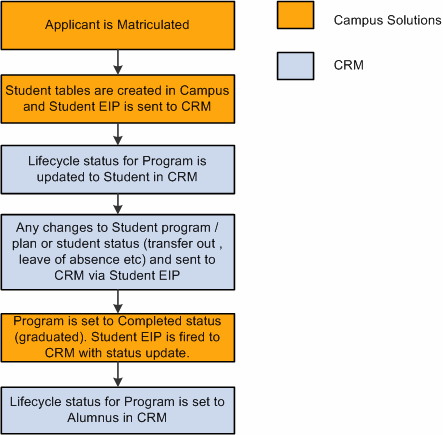

The following graphics illustrate two examples of an EIP sequence as the messages move data between CS and CRM:
Image: Example of message flow for Suspect to Applicant
Workflow illustrating the system steps to pass messages between Campus Solutions and CRM when suspects become applicants.
Image: Example of message flow from Applicant to Alumnus
Workflow illustrating the system steps to pass messages between Campus Solutions and CRM when applicants become alumni.
