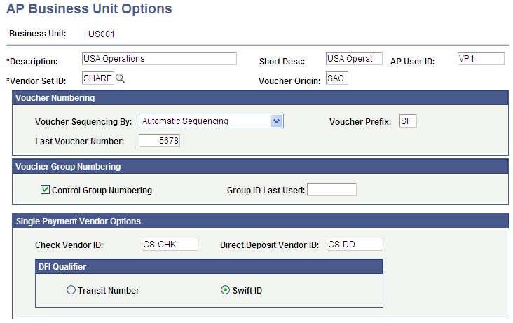

Access the AP Business Unit Options page (Set Up SACR > Product Related > Student Financials > Refunds > AP Business Unit).
Image: AP Business Unit Options page
This example illustrates the fields and controls on the AP Business Unit Options page. You can find definitions for the fields and controls later on this page.
AP (Accounts Payable) Business Unit Options page
AP business unit options control how Student Financials creates vendor and voucher file definitions. These definitions are used for transfer to PeopleSoft Payables to create refund payments.
Note: The AP business unit options that you define on this page should match PeopleSoft Payables definitions.
Field or Control
Definition
AP User ID
The Student Financials application refunding process populates each voucher it creates with the AP user ID that you specify here. This ID must exist in PeopleSoft Financials.
Voucher Origin
The Student Financials application refunding process populates each voucher it creates with the voucher origin that you specify here. This origin value must exist in PeopleSoft Payables.
Voucher Numbering
Field or Control
Definition
Voucher Sequencing By
Select how voucher numbers are assigned. Values are:
Automatic Sequencing: Assign voucher numbers starting with the number that you specify in the Last Voucher Number field.
Use SF Refund# as Voucher#: Assign voucher numbers using the SF refund ID number.
Voucher Prefix
Enter an optional two-character voucher prefix to enable accounts payable staff to easily identify vouchers that originate in Student Financials. Voucher IDs are eight characters long. If you enter a prefix, a six-digit number is attached to create the voucher ID. For example, if you use the prefix SF, the refunding process creates the voucher ID SF000001.
Last Voucher Number
Displays the last voucher number used. You can override this value to establish a new starting point for numbering.
Voucher Group Numbering
Field or Control
Definition
Control Group Numbering
Select to assign a control group ID to each voucher that the Student Financials refunding process creates. If control group numbering is selected, the Group ID Last Used field is updated every time you run the refund process. (All of the vouchers created from one refund process run share a common group ID number.)
Group ID Last Used
Displays the last group ID when the Control Group Numbering check box is selected.
Single Payment Vendor Options
The Single Payment Vendor Options group box is available and required only if the Use Single Payment Voucher option is selected in the AP Refunding Option group box on the SF Installation page.
Use this group box to map a single payment Vendor ID for direct deposit and a single payment Vendor ID for checks. AP requires a single payment Vendor ID to create a single payment voucher. To facilitate this, you set up the Vendor ID here. The Create Voucher Process then passes this ID, with the refund details, to AP for voucher creation.
Field or Control
Definition
Check Vendor ID
This is a free form edit field. The value that you enter must be a valid single payment vendor in AP.
If a direct deposit agreement does not exist for a student, the Check Vendor ID value is used by the Create Refund Voucher process to send the refund details to AP to produce a check for the refund amount.
Direct Deposit Vendor ID
If a direct deposit agreement exists for a student, the Direct Deposit Vendor ID value is used by the Create Refund Voucher process to send direct deposit details to AP for the refund amount.
DFI Qualifier
AP requires the DFI Qualifier and the derived DFI ID to create a single payment voucher—the setup here is used to send that information to AP.
Select Transit Number or Swift ID.
If you change the DFI Qualifier, you receive a warning message: Changing DFI Qualifier might affect bank details being sent to accounts payable. Changing DFI Qualifier will have an impact on the DFI ID value too. Bank details sent to accounts payable might be incorrect or invalid.
Note: Oracle supports only these DFI Qualifiers: Transit Number and Swift ID.
See:

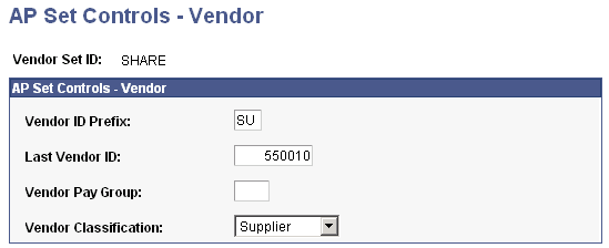

Access the AP Set Controls - Vendor page (Set Up SACR > Product Related > Student Financials > Refunds > AP Set Controls - Vendor).
Image: AP Set Controls Vendor page
This example illustrates the fields and controls on the AP Set Controls Vendor page. You can find definitions for the fields and controls later on this page.
AP (Accounts Payable) Set Controls Vendor page
Note: AP set controls insert information into vouchers that are produced for refunds using PeopleSoft Payables. Consult your account payables staff to determine the proper settings.
Note: The setup on this page is used only by the Create Vendors and Vouchers (VOUCHER_BUILD VERSION_1) process.
Field or Control
Definition
Vendor ID Prefix
Enter an optional vendor ID prefix to be used with all vendor ID numbers. This prefix should describe the entity producing the voucher transactions. When you add a vendor ID prefix, the prefix replaces the first two characters of the vendor ID number.
Last Vendor ID
Displays the last vendor ID used by the system. Insert a new value to specify a starting point for new vouchers.
Vendor Pay Group
Enter an optional two-character vendor pay group code. This code can be used during payment processing to cause Pay Cycle Manager to pay only vouchers originating in Student Financials.
Vendor Classification
Select the value to use for the VENDOR_CLASS in the VENDOR_SYNC message for the AP Interface process for refunding. Values are Attorney, Employee, HRMS related and Outside Party. The default value is Outside Party.
See PeopleSoft FSCM: Payables, “Entering and Processing Vouchers Online” and “Establishing Pay Cycles”.
