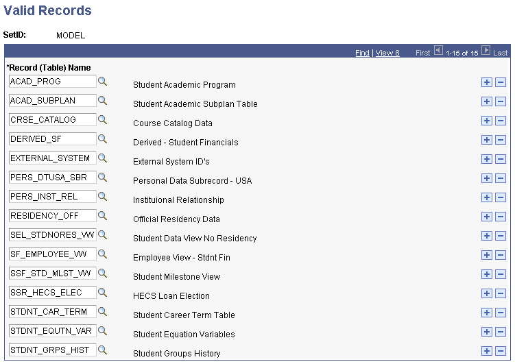

Access the Valid Records page (Set Up SACR > Product Related > Student Financials > Valid Records).
Image: Valid Records page
This example illustrates the fields and controls on the Valid Records page. You can find definitions for the fields and controls later on this page.
Valid Records page
Use this page to add a row for EXTERNAL_SYSTEM and STDNT_CAR_MLSTN.

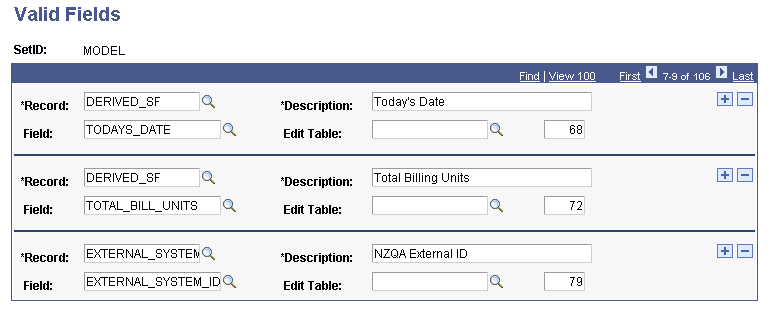

Access the Valid Fields page (Set Up SACR > Product Related > Student Financials > Valid Fields).
Image: Valid Fields page (1 of 2)
This example illustrates the fields and controls on the Valid Fields page (1 of 2). You can find definitions for the fields and controls later on this page.
For the External_System_ID, change the Description field to NZQA External ID. Add a new field value named MILESTONE.

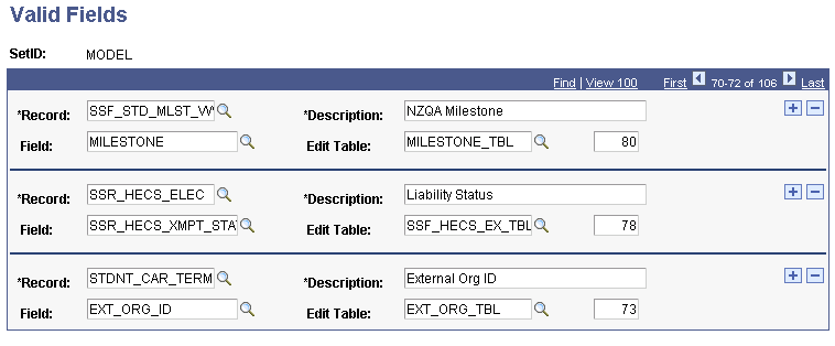

Image: Valid Fields page (2 of 2)
This example illustrates the fields and controls on the Valid Fields page (2 of 2). You can find definitions for the fields and controls later on this page.
You no longer need to modify SFPSTDNT to load EXTERNAL_SYSTEM_ID from the EXTERNAL_SYSTEM table, where the EXTERNAL_SYSTEM record equals NQA, and MILESTONE from the SSF_STD_CAR_MLSTN table.

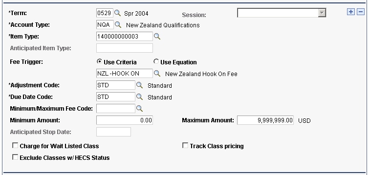

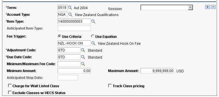

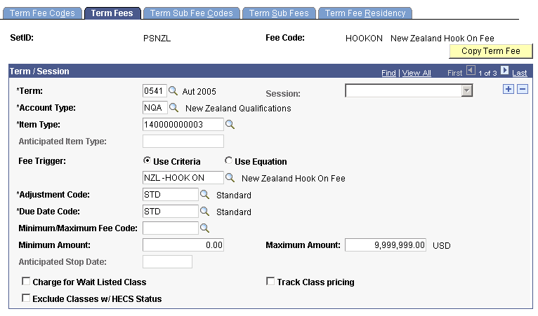

Access the Term Fees page (Set Up SACR > Product Related > Student Financials > Tuition and Fees > Term Fees > Term Fees).
Image: Term Fees page (1 of 3)
This example illustrates the fields and controls on the Term Fees page (1 of 3). You can find definitions for the fields and controls later on this page.
Image: Term Fees page (2 of 3)
This example illustrates the fields and controls on the Term Fees page (2 of 3). You can find definitions for the fields and controls later on this page.
Image: Term Fees page (3 of 3)
This example illustrates the fields and controls on the Term Fees page (3 of 3). You can find definitions for the fields and controls later on this page.
Use this page to view information about the term fee.

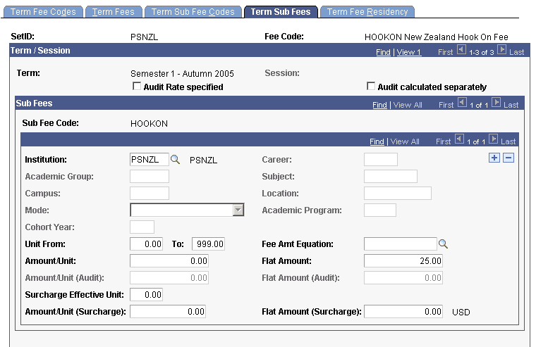

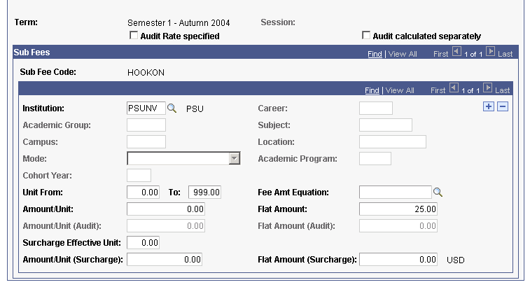

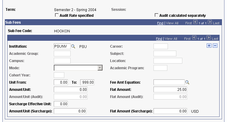

Access the Term Sub Fees page (Set Up SACR > Product Related > Student Financials > Tuition and Fees > Term Fees > Term Sub Fees).
Image: Term Sub Fees page (1 of 3)
This example illustrates the fields and controls on the Term Sub Fees page (1 of 3). You can find definitions for the fields and controls later on this page.
Image: Term Sub Fees page (2 of 3)
This example illustrates the fields and controls on the Term Sub Fees page (2 of 3). You can find definitions for the fields and controls later on this page.
Image: Term Sub Fees page (3 of 3)
This example illustrates the fields and controls on the Term Sub Fees page (3 of 3). You can find definitions for the fields and controls later on this page.
Use this page to view information about the term sub fees.

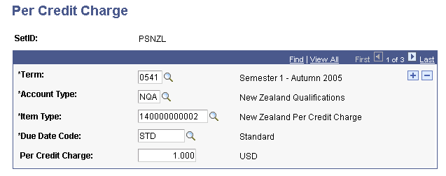

Access the Per Credit Charge page (Set Up SACR > Product Related > Student Financials > New Zealand Defaults > Per Credit Charge).
Image: Per Credit Charge page
This example illustrates the fields and controls on the Per Credit Charge page. You can find definitions for the fields and controls later on this page.
Use this page to set up information to apply charges based on each credit for which a student is enrolled.
During the tuition calculation process, the system reads the number of NQF credits determined during the Student Records process. It then multiplies that NQF credit number by the per credit charge. Student Financials uses the NQF credit number for the calculation, but the number itself is provided by the Student Records process.
