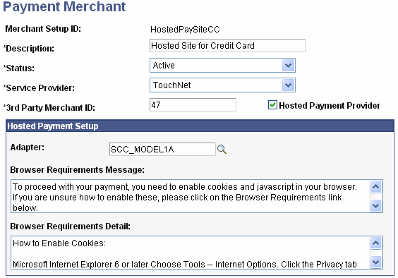

Access the Payment Merchant page ).
Image: Payment Merchant page (1 of 2)
This example illustrates the fields and controls on the Payment Merchant page (1 of 2). You can find definitions for the fields and controls later on this page.
Image: Payment Merchant page (2 of 2)
This example illustrates the fields and controls on the Payment Merchant page (2 of 2). You can find definitions for the fields and controls later on this page.

| Hosted Payment Provider |
Select this check box to identify the payment merchant as a hosted payment provider. If you select this check box:
Hosted Payment Setup
This group box is available only if the Hosted Payment Provider check box is selected.
Field or Control |
Definition |
| Adapter |
Select the adapter to be used by the hosted payment merchant to process hosted payment transactions. |
| Browser Requirements Message and Browser Requirements Detail |
Enter a browser-related message, or browser-related detail about browser requirements, that an application can display to a user before the user is transferred to the third party hosted site. |
| Browser Requirements Message |
For schools that use hosted payment, the message that you enter here appears on the Make a Payment - Confirm Payment page if the Display Browser Message check box is selected on the Electronic Payments (Institution Set) setup page. |
For schools that use hosted payment, the detail that you provide here appears when students click the Browser Requirements link on the Make a Payment - Confirm Payment page if the Display Browser Message check box is selected on the Electronic Payments (Institution Set) setup page. |
