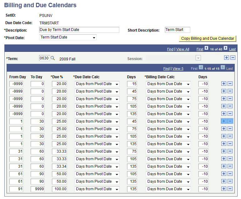

Consider this example of a fee that is calculated into a five-installment calendar and how it can still fall into line with the other remaining installments. At any time (-9999) before term starts (0), the fee is split into five installments of 20% each. If the fee is first calculated during the first month (1–30), then the fee is split into four installments of 25% each. If the fee is calculated during the second month (31–60), then the fee is split into three installments of 33.33% each. If the fee is calculated during the third month (61–90), two installments of 50% each are created. And, if the fee is calculated any time from the fourth month onward (91–9999), then it becomes due in full in the last (fifth) installment. The following page illustrates the example.
Image: Billing and Due Calendars page
This example illustrates the fields and controls on the Billing and Due Calendars page. You can find definitions for the fields and controls later on this page.
