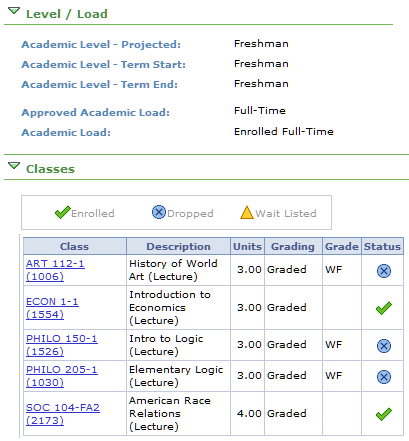

Here is an example:
  • On the Academic Statistics Type page, for Statistics Period Type of N, the Exclude Withdrawal Grades grid indicates that grades of WF are to be excluded when calculating academic load for a statistics period.
    Image: Enrollment Data Example
    A student has this enrollment data for the Spring 2011 term:
  • There are 16 units and 9 of these units have been dropped for penalty grades of WF. At PSUNV, the WF grade is included in a student’s progress units, for load calculation and GPA purposes.
  • Although the student’s term load (as calculated in STDNT_CAR_TERM) is full-time (based on 16 units), if this student’s record was evaluated by the Consolidated Academic Statistics process (with the grade exclusion rules defined as outlined above), the load would be calculated in the following way:
    • Number of enrolled units for reporting period is 16.00.
    • Number of units to be excluded based on Academic Statistics Type exclusion rule is 9.00 (3 x 3 units with grade of WF).
    • Total units for Load Calculation is 7.00. This is the number of units that is passed from SRPCCONP into SRPCCALC.cbl for getting the NSC load.
    • Academic Load (according to Load rule) is half-time.

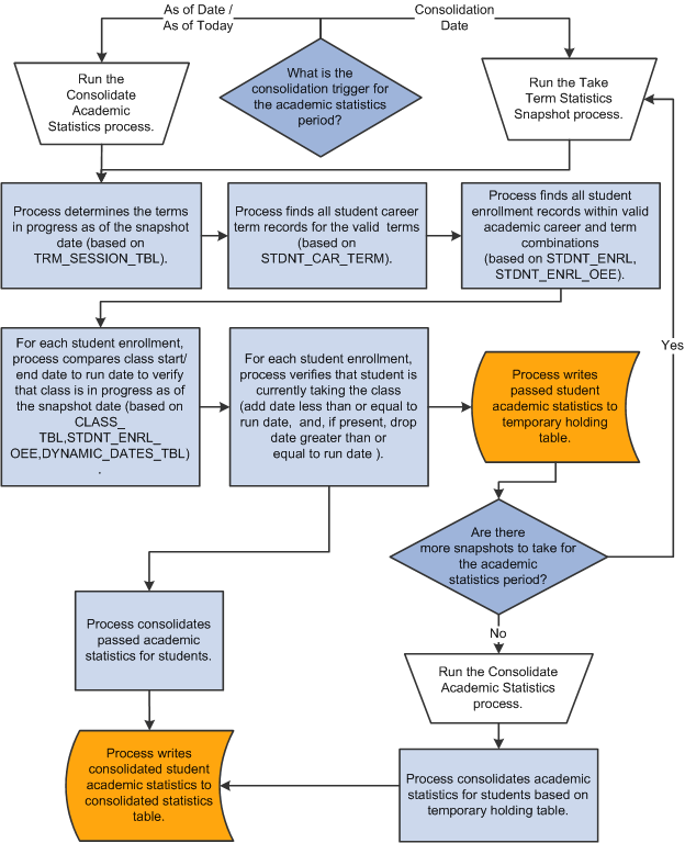

Flow Chart of Consolidated Statistics Processes
Image: Example flows of consolidated academic statistics processes
The following diagram illustrates when to run the Consolidate Academic Statistics process (SRPCCONP) and the Take Term Statistics Snapshot process (SRPCCONA) and, when initiated, how these processes function:
